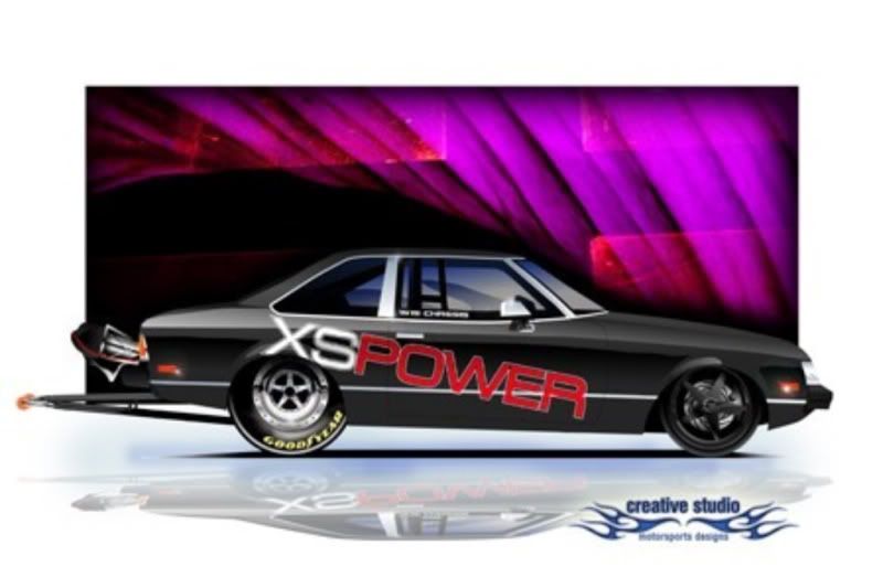

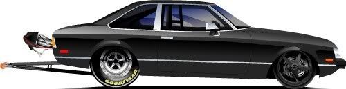

here is a rendering of the car check it out!

but enogh talk here are couple of pictures of the car
