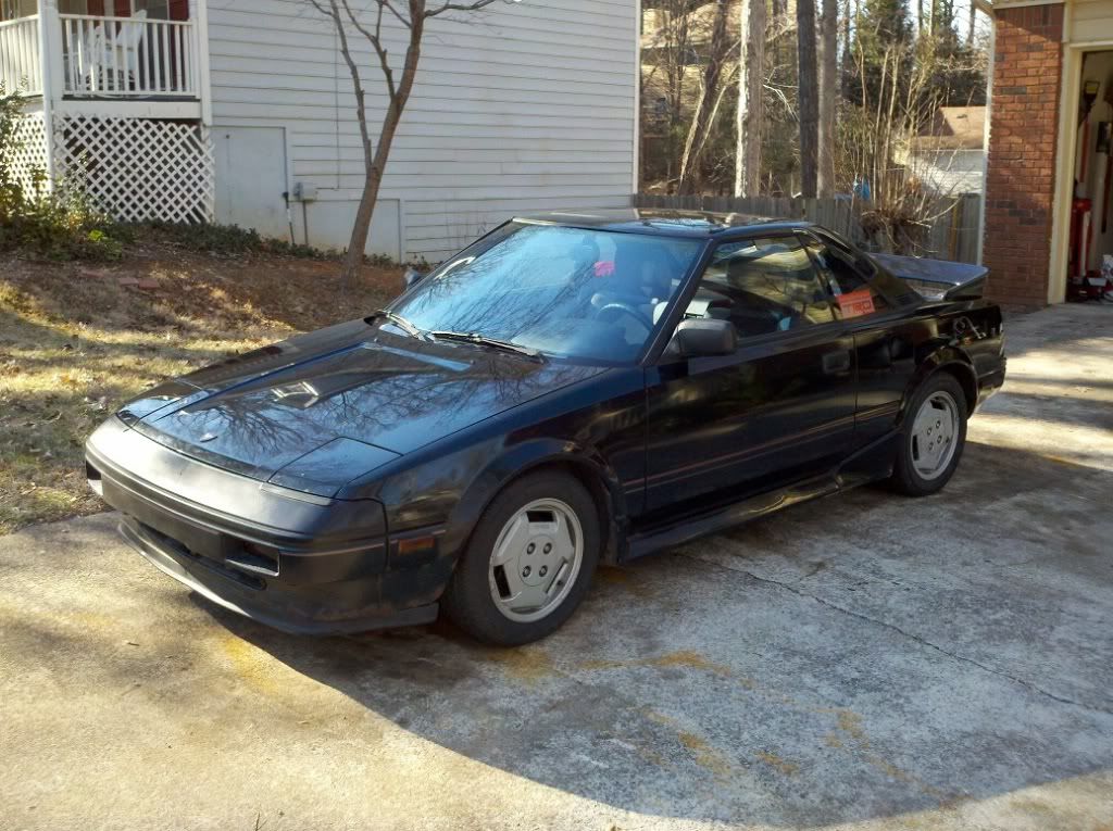

Well, Today was D-Day, trying to get the car started.
I installed both axles, hooked up the speedo cable, the last of the vac and coolant lines, And filled it with oil.
All set, ready for attempted start:
Well, I took out the EFI fuse, and started to crank it to build oil pressure,
and on the second rotation- WHAM! Sounded like the crank broke or something. Now I can't budge the motor by starter, or by hand. I've had this creeping fear that I might have left a short socket in one of the cylinders when I installed the head, because I couldn't find it anywhere.....
OH SORRY! THAT WAS JUST A NIGHTMARE I HAD THE OTHER NIGHT.
My bad...
:rofl:
LOL. Couldn't resist.

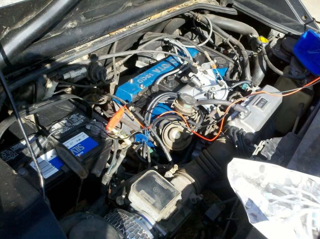

Actually, the motor built up oil pressure after about 20 seconds of cranking,
put the EFI fuse back in, and once the rail built pressure, it fired right up!
I was afraid that I'd have to mess with the distributor alignment, but no, fired up first try. At first, it would die after like 5 seconds of running, or with any throttle input....till I realized I hadn't plugged the AFM in.
:rolleyes:
After bleeding the system, it runs at at just over 1/3 temp, and midpoint oil pressure. It was cool to find the original OEM bleeding tubes tucked away behind the spare tire. Bleeding process went great.
All I have to do now, is connect the shifter cables to the tranny(can't find the lock brackets or the original clips!), and top off the tranny itself, and she's good to go.
Again, Yay me.

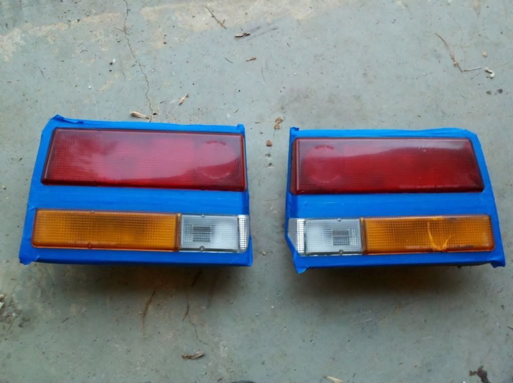

I also finished tinting the tail lights somewhat:
I just like that the cracks in the passenger side don't stand out so much now.
Later, I'll get a replacement.

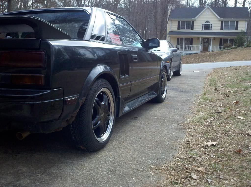

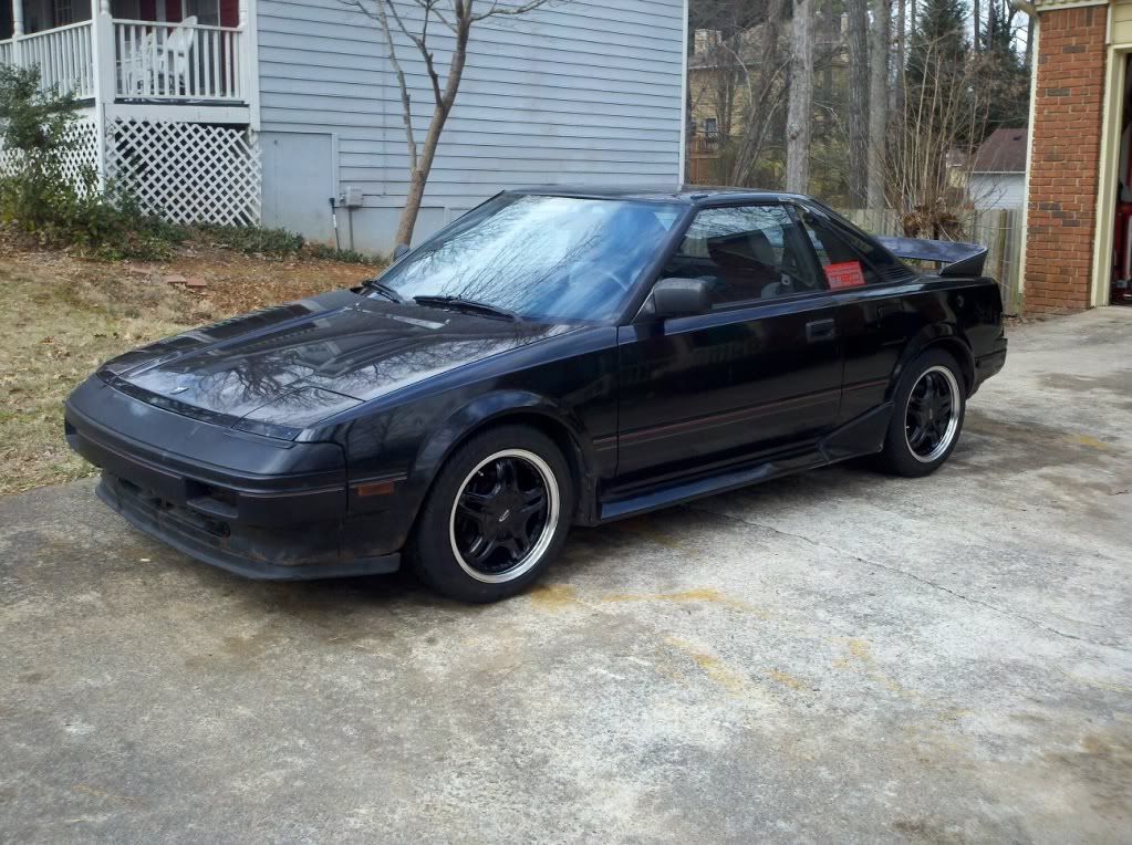

New wheels on the car:

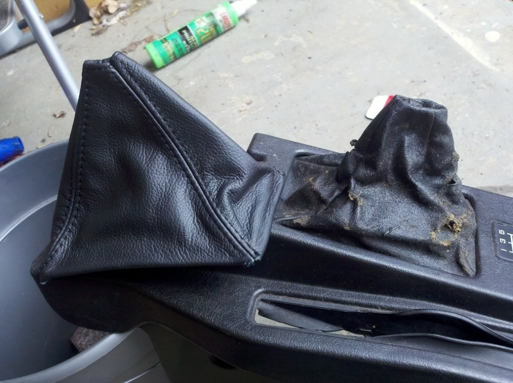

New shift boot:
Almost time to register it.

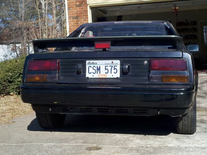

Update-
Today, I finally got install the rear motor mount, re-bled the clutch(much better), charged the A/C, insured and tagged the car.
For the first time since Bill Clinton was President, the MR2 is road legal and roadworthy. The only work i still want to do to it, is:
Tint the windows
Get MR2 floormats
Weld and install the new exhaust
Drove the car on the highway for the first time, and it rides pretty smooth. I was also happy to find that the cruise control works correctly,
as does all other electricals on the car. As soon as the exhaust is finished, I will proclain it the official daily driver, and retire the Supra
to the garage for a summer-long restoration, including paint.
