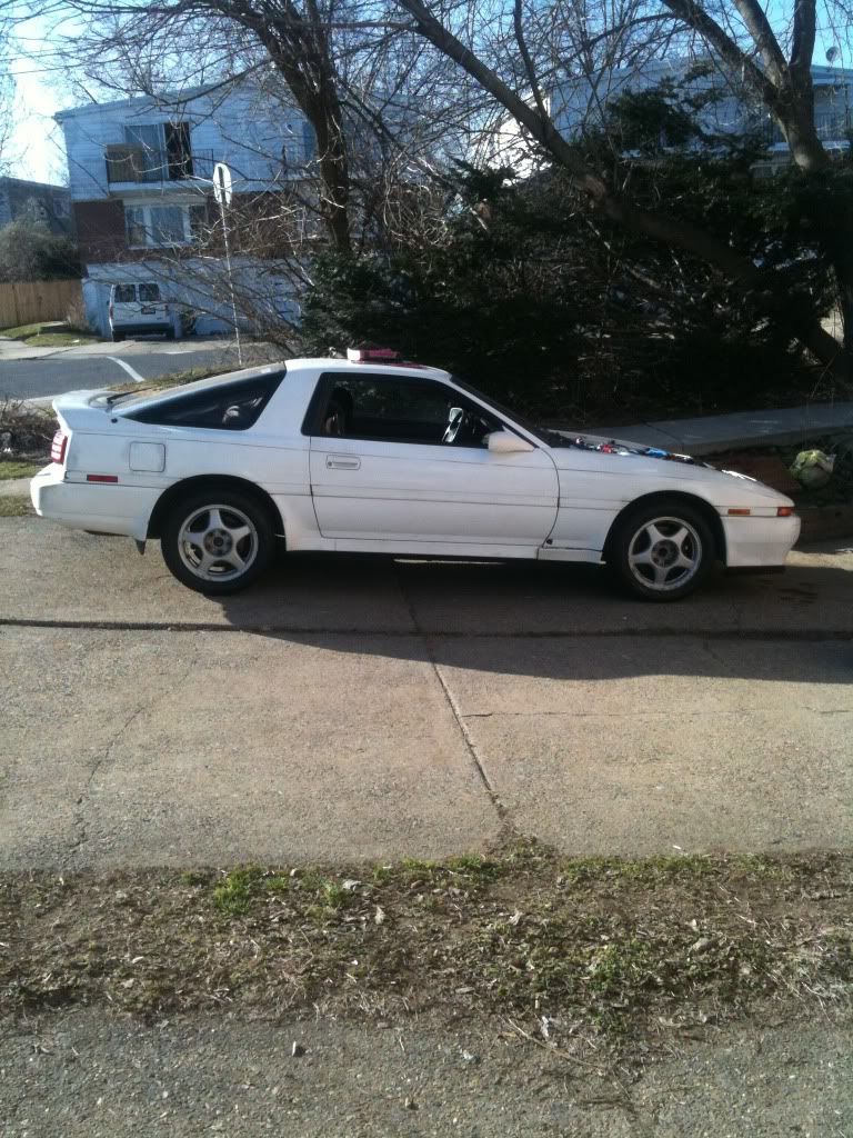

She left the garage for the first time in 7 months under her own power...she needs sun

supra1008;1524755 said:
How the hell are you going to get it on the road without ripping off the bumper on that steep as hell driveway!!??
I got it in I'm sure I'll get it out....but the new exhaust could make it a bit tricky:-(
