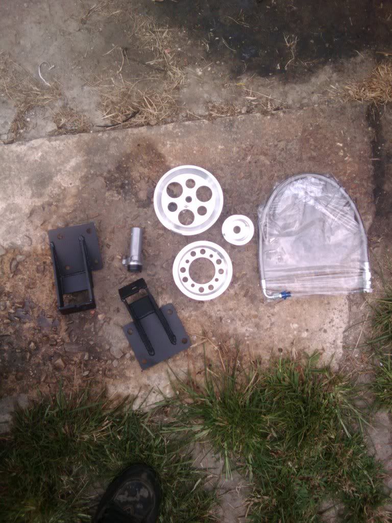

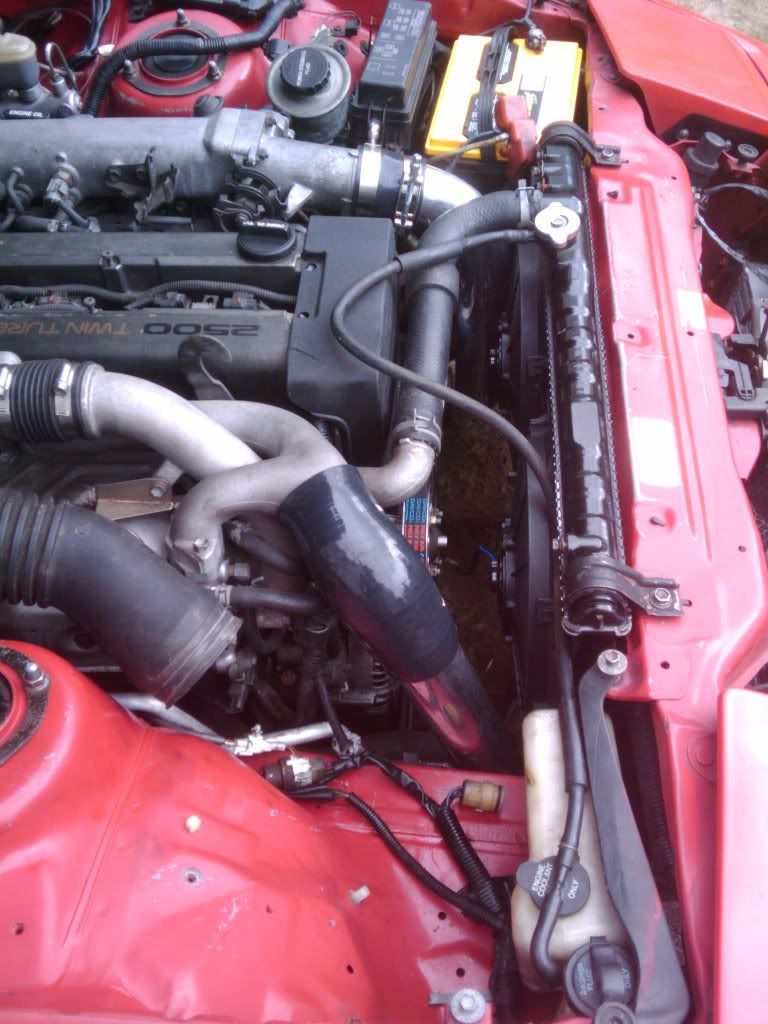

well the car is now mobile registered and insured, i have a leak in the P/S line i got from Drift Motion so i will call them for a replacement, and i just have to install my downpipe and radio and i should be set, and my tach , and Oil Gauge dosent work yet
well ive been having a blast with the car i cleaned up the interior today, i raced my boys GSX Eclipse with Turbo Back Exhaust, FMIC, and Boost Controller...I Beat Him 2/4 Times, his car def pulls on me in the top end, but i out lauch him from the line lol RWD>AWD lol... Then i raced my boys Osiris Tune G35, he walked me from a Roll lol mind you my only mods is FMIC and a 3in Downpipe and its connected to the Stock Mk3 Cat and Cat-back but its not bad for 10lbs...

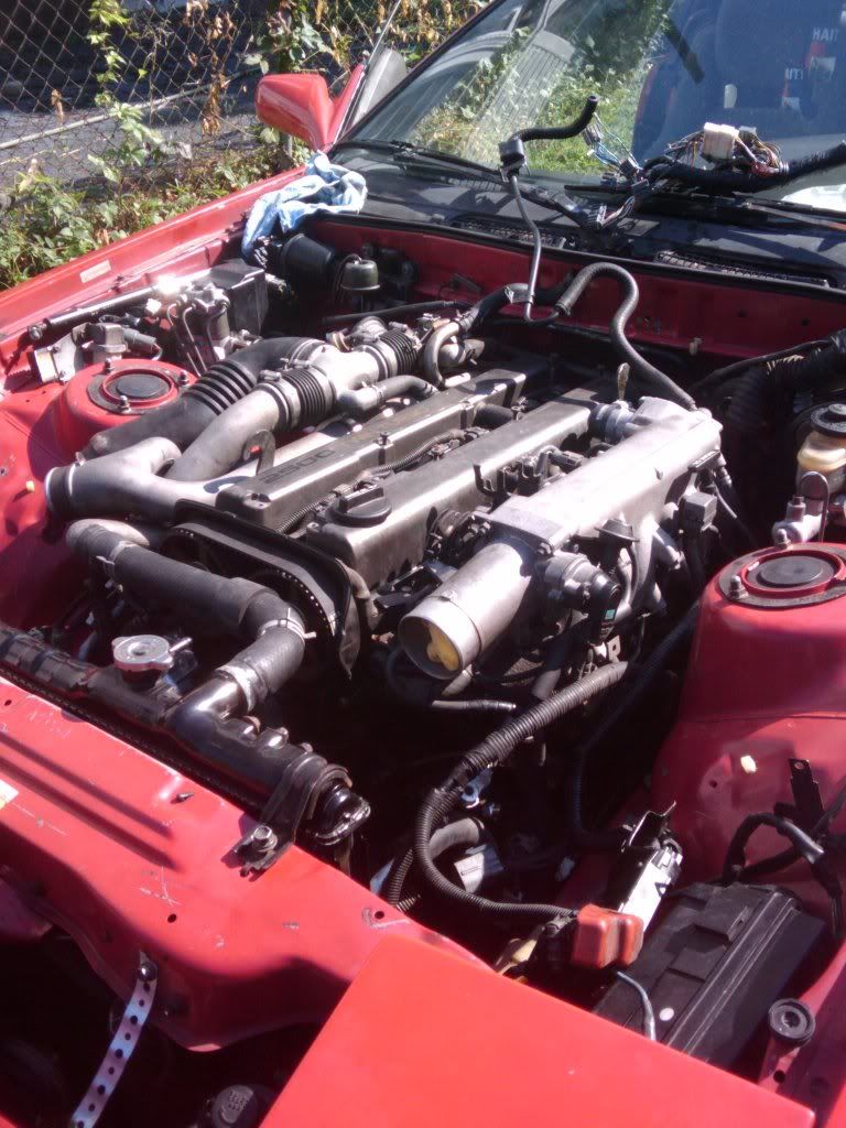

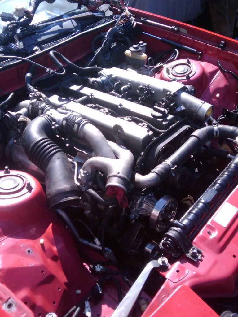

Did a grand Total Summary:
Parts List and Costs:
JZA70 1JZ Motorset w/ R154, ECU, Ass. - $2200shipped
5spd swap parts (Pedals, Driveshaft, Clutch Master)- $130picked up
1JZ Downpipe - $80picked up
Clutch Slave Cylinder - $30 (from autozone)
Tropper Timing belt - $22 (from autozone)
Dayco Serp. belt - $18 (from autozone)
Mobil 1 75w-90 Sythetic Gear Oil - $16 (from autozone)
Mobile 1 Oil Filter - $12 (from autozone)
I already had Mobile 1 Sythetic Oil
'94 Toyota Camry 4cylinder Throttle Cable - $20 (from Junkyard)
Intercooler - $100
Intercooler misc. - $120
Total: $2748
Parts from Driftmotion:
Pre 89 Swap Mounts - $150+shipp
SS Oil Sender adapter hose - $20+shipp
SS Power steering line - $65+shipp (Currently leaking)
SS Full Length Clutch Hose - $45+shipp
SS 1JZ Fuel Damper bypass hose - $65+Shipp
2JZ waterpump - $159+shipp
light weight pully kit - $58+shipp (Only got it because i needed a 2J waterpump pully and my P/S pully was bent)
Timing belt tensioner- $67+shipp
Total: $629 + shipp
