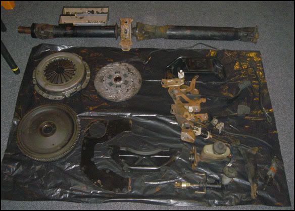

and so, i have taken another step into manualizing my vehicle.
this weekend i snagged everything out of my friend's parts car needed to do the swap.
I got a W58, brand new stock clutch and PP, and all that other shit i need.
and so, i'll be throwing it into my car once my questions are answered and when i find some time.

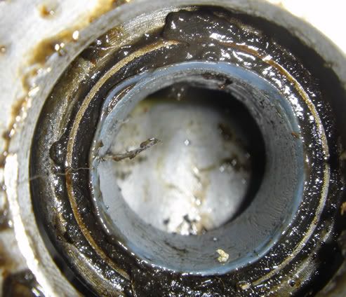

6. In where the bushing on the bottom of the shifter rides is this plastic-thin-like blue material. It's beat? where can i get a new one of these?

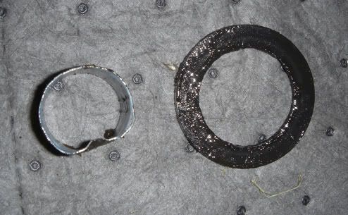

8. What's this cut off?

6)Leave that one alone just get a new for the shifter its self I forgot what it is called ….
7)I don’t know what that is lol
8)Part 2 I don’t know what that is lol

-so about #6, i should leave that fucked up thing in there?

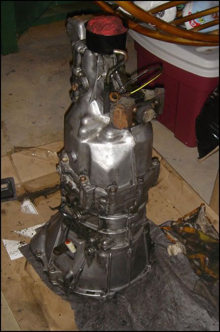

I would not store the tranny like you have in the first pic sometimes its slips into gear and you have to split the case to disengage the affected gear a big PITA especially after you reinstall it and realize its stuck in gear and have to remove it ask me how I know!
theKnifeArtist
Fire on High!
Apr 6, 2006
2,332
North Jersey
^okay thanks, i just saw someone on here store it like that, so i thought it was alright. It makes sense though. i have it sitting normally now, since i took the bellhousing off. Shifting seems to be good.
wow so much attention to question 8. thank you but about the others

6. You can most likely get it from Toyota, but I would try a parts store first.

6. what's the correct name for this thing

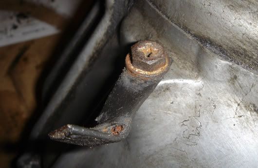

and what is this piece?
it on a writeup and i dont think i have this piece. what is it?
5
45
get the marlin crawler bushings instead of the truck bushings, you'll be glad you did...
not sure on that piece in the pic though, looks more like one of the braces for the turbo...

poodles: yeah that does look like the brace for the turbo.
you see i have everything i need for this swap, but when i go through the list, i seem to be missing the 'driver side engine-trans "wing" bracket' aka 'lower engine brace'
what does this look like? i read it keeps the engine from rocking back and forth, and remember when ripping apart the parts car, i could rock the engine back and forth with my hands. so im thinking it was already off the car?
just a picture or a description or anything of this piece would be helpful.
shepfly
Jul 23, 2007
15
Ohio
The circled part supports the downpipe from the turbo, rusty end clamped to pipe with hoseclamp, bolts to forward face of bellhousing on other end.
