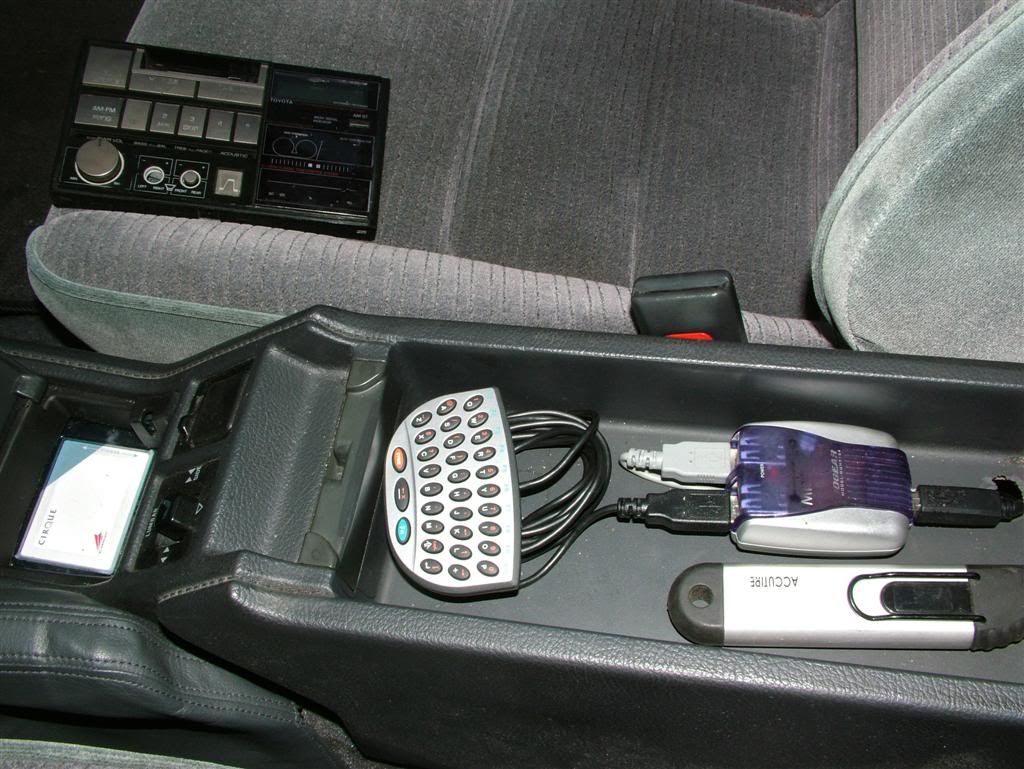

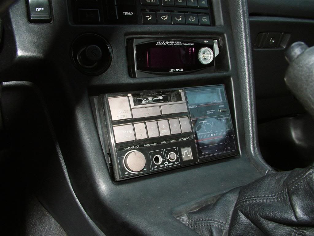

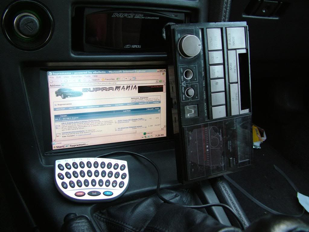

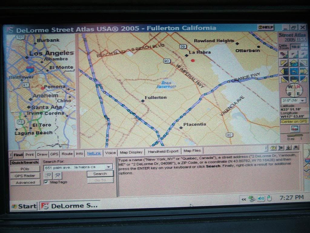

Here's my setup, and the "attachable face" and the touchpad under the change holder are my own ideas so if you are a hater (and you know who you are) then send money if you use it! (just kidding, inside joke :icon_razz ) For everyone else, I would love for you to copy anything I have done, and if you do then I am honored that you liked it enough for your own car.

Another, you can see my dvd player, boost controller and eq in the glove box.
Also, not shown are my TV tuner, Soundblaster Audigy USB 5.1 channel sound card, FM radio, and PVR to record video to the hard drive while driving.

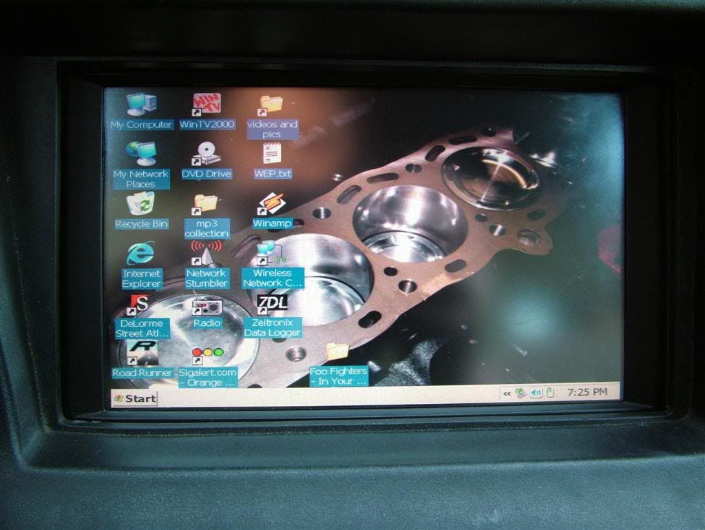

Wanna see another cool feature? Here's me remotely controlling my car pc in the car in the garage from my home pc in my apartment! I can transfer files or music, change settings, whatever.
I gotta give big props to my buddy Ryan (anorexic poodle) for helping me set up the remote desktop. It was tough to get the automatic logon and passwords to work correctly but he is a freakin computer GENIOUS! And don't even try to play that game "Cranium" with Ryan because he will "smoke you like a cheap cigarette" LOL

This uses an efficent mini itx motherboard with embedded via 1ghz processor, I can run it with the car off for more then 4 hours without a problem. The power supply automatically turns the pc on and off with the ignition, and I have it hibernate so it is up and running before I get out of my driveway to the street. It has a low battery shutdown and if I manually turn it on without the ignition, it shuts itself down after 2 hrs. It has 512mb ram, 60 gig 3.25" hd, and a wireless g wifi card with 8db antenna. I built and installed the pc and everything myself. I can park in almost any local parking lot or go down any street and get online. All of downtown Fullerton has free wifi now, along with Schlotskys Deli's, Ben and Jerry's, tea houses, etc...

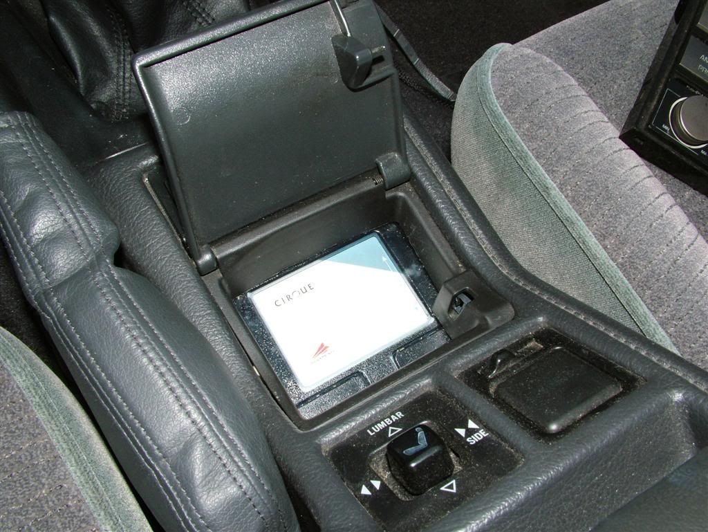

Yup, it's the m10000. I have a touchscreen AND the touchpad. I can use either. The touchpad is just easy to reach when I am chilling out browsing the web and stuff. The keyboard is actuall called a "minikey" and is design for ps2 but it's usb and pc compatible too. You are right about the speed but it is plenty fast to browse the web, watch videos and movies, and do all the other stuff I want to do in my car. For games, a full atx would be real cool, I might do that later on. I am gonna put one of those mini ps2 units in soon too, those were not even available when I did this install. The monitor has video and svga in so I can use that for the ps2. The main volume control is in the old tems switch. I made abs squares and epoxied them in where the buttons were, then I put in a 50k ohm stereo pot and wired it between the amp and sound card so i have a master volume control that is easy to reach and independant of the pc. The other switch is to put my fm antenna up or down.

It's a ebay Lilliput 7" vga touchscreen monitor, $280 shipped and it comes direct from China. I really like it! I modified it to turn on automatically and it's powered from the pc's power supply so it turns on and off with the pc. It has buttons but they are hidden behind the dash, I can use a remote to adjust it if I need to. I think the Lilliput is a GREAT deal, 0 problems with it. I guess it has been in the car close to a year now and the touch panel still looks new. BTW, the monitor and touchpad install require several hours of carefull work with a dremel tool, and a steady hand.
