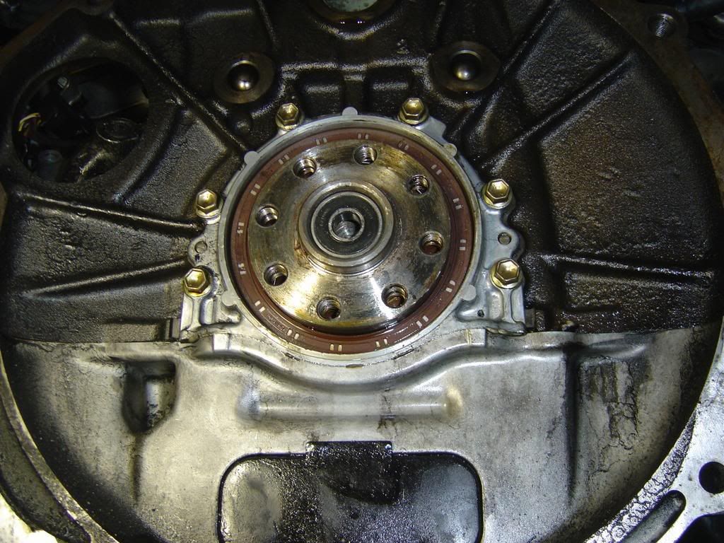

bigaaron said:
If you've installed a rear main seal on a 1jz before, you should be able to look at this pic and see why it was leaking oil badly. :icon_wink
lip not tucked in on the rear main seal?
