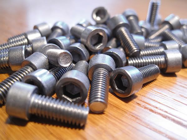

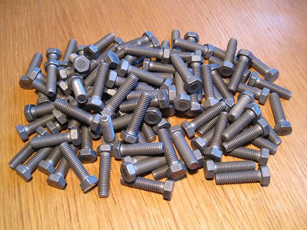

Titanium m6
Titanium m8

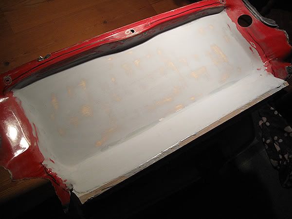

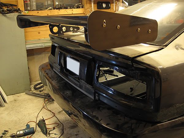

Part behind licenseplate almost ready to be duplicated in carbonfibre

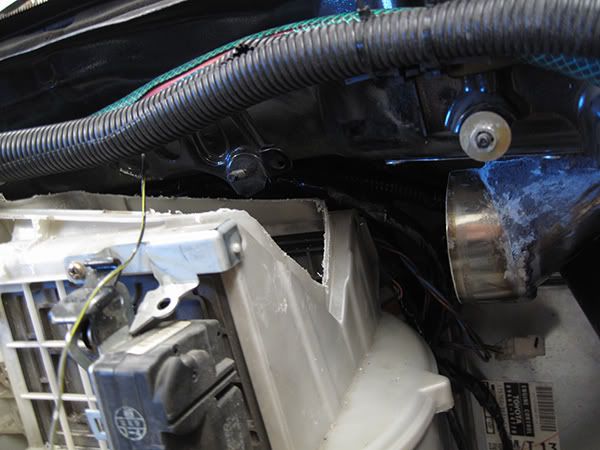

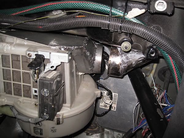

Heater and fan package in place

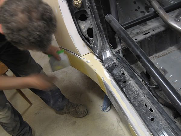

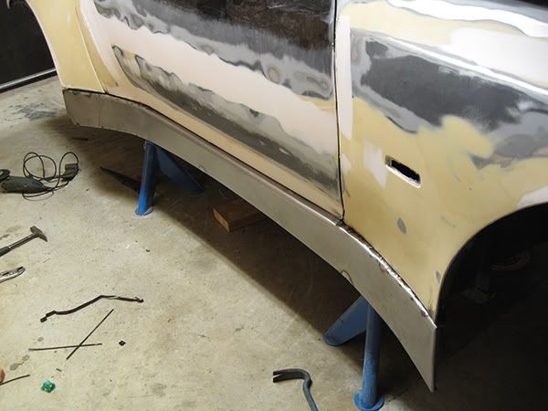

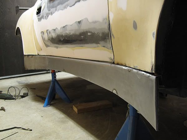

Sideskirt
Sideskirt

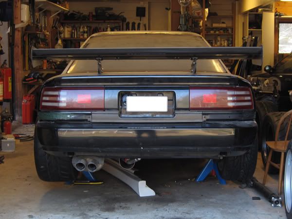

rodama5anthony: Its an APR "drag style" wing. It was available in two sizes, this one is the extra wide one.

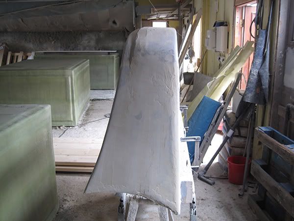

Mini update:

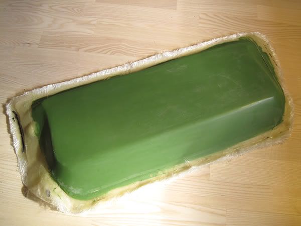

Mold finished – pretty soon a copy in carbonfibre

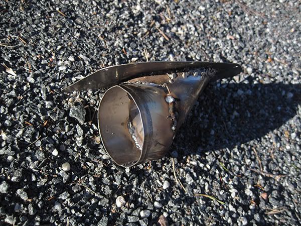

Freshair-intake

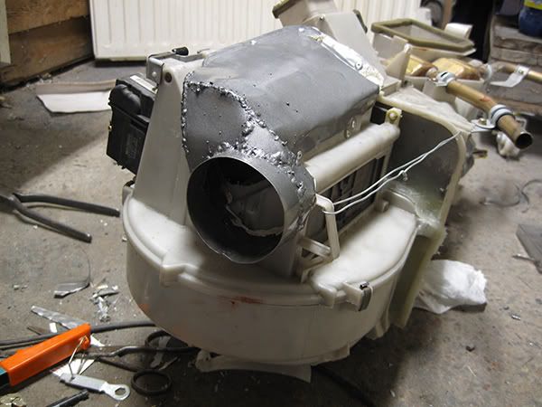

Testfitting freshair-intake now I have to modify the fan to have a similar hole to merge with.

Fanmotor finished
Installed and now I just have to put some gaffer tape on it and its ready to go!

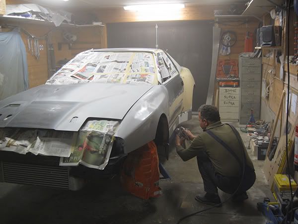

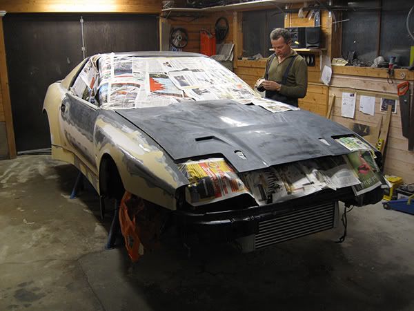

Zoran is back again. Now he is working on the Supra every sunday so hopefully the car will be painted in a near future.

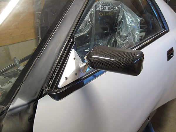

Kaze aerocraft mirror installed

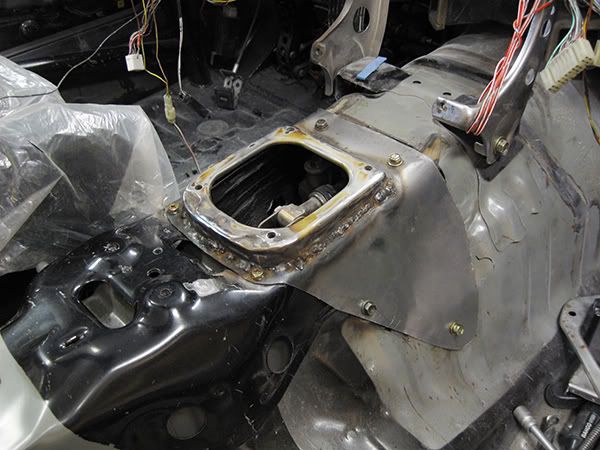

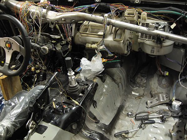

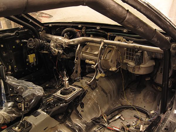

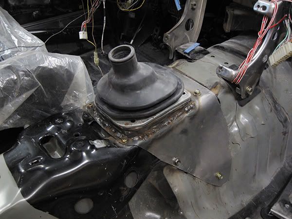

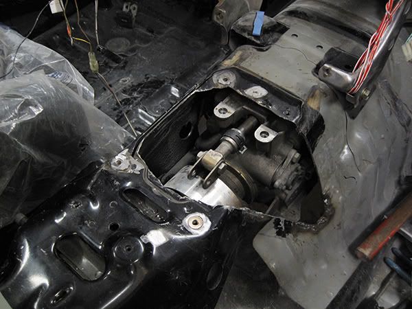

Made a hole to be able to remove shifter etc.

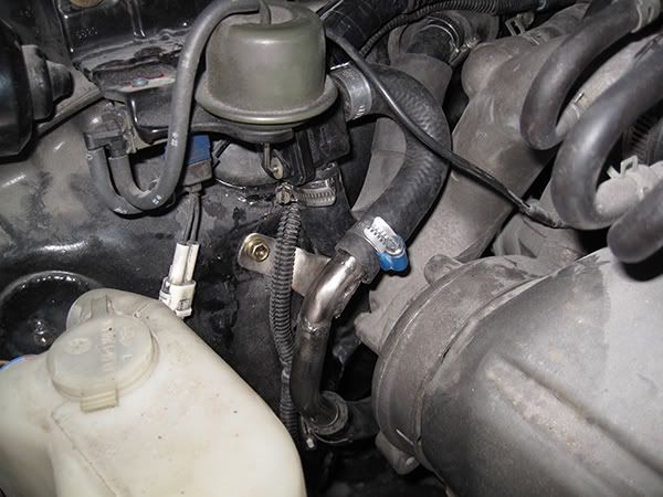

Welded some pipes and cut some hoses to get water to the heater.

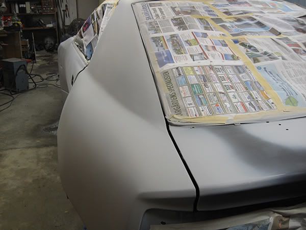

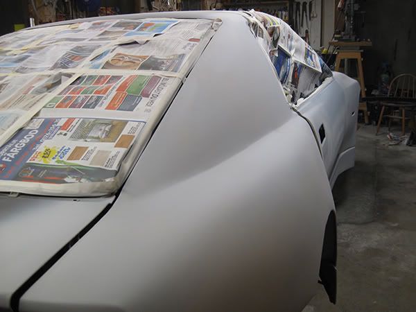

Jay C
Sep 30, 2010
283
Omaha, NE
This thing is retarded great work. While it may cause some blind spots i really like the look of the rear side window delete you did. I cant wait to see it painted.
