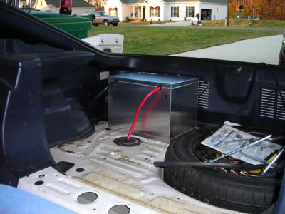

Everything I needed for my battery relocation, I used with this kit.
http://store.summitracing.com/partd...AY-48103&N=700+400235+307186+115&autoview=sku
Maybe a new ground cable from the block, but this was it.

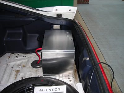

QWIKSTRIKE said:
I used the trunk latch as a ground, and also drilled a hole along side the case that Brent has in his picture, and installed o ring protector gommets. This way you dont have to drop the tank.
yea but in order to mount the battery case correctly im going to have to drop the tank. i've finished wireing it up and it doesn't seem that hard to do drop the tank i mean
