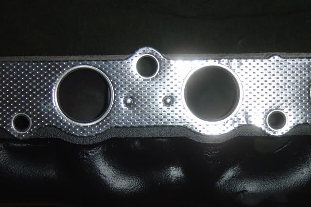

Well I started porting and polishing yesterday. Productive somewhat. Not a good weekend all together. I ended up opening one of my exhaust ports up too much. Im not sure if thats going to be a problem or not. I posted in the tech section for some advice. http://i150.photobucket.com/albums/s91/mk3forme/b4 and after engine bay/head pics/DSC01095-1.jpg
That was not even the worst part. I started yesterday and did the #1 and 2 exhaust and intake chambers. What I didnt realize until after todays work on #3 and 4 is that the tape I was using to protect the already machined valve seats, were covering the vertical angle of the seat. I was grinding away the lip that is under the seat as this is an obstruction, and was unaware that I was also gettin into the seat. I will take this to the head shop tomorrow to see what can be done. As long as I didnt majorly screw up I will finish the port work and then take it to have it repaired.:3d_frown:

Thanks for the free bump John! lol. Its Allen on this end. Well since im here I might as well update. I had to work yesterday so not much done. Today I spent all my time trying to finish up the head. I think I have done as much as I can do for it. Now its back to the head shop to see what needs to be done about my valve guides. I took it last Monday and he said I was fine with no damage to worry about. But that was then and there is some now. That exhaust ports are just too small to work from without creating problems to an already cut valve seat. Lesson learned for me. Now I will have to see what can be done to take care of my problem. I also started polishing my exhaust manifold.
The thing that sucks about the manifold is you cant polish the whole runner on the the #1 and #6 exhaust port as its to long and can get the die grinder in there. Or at least I havent figured a way yet. Ill post some pics of the head once I get it back.
