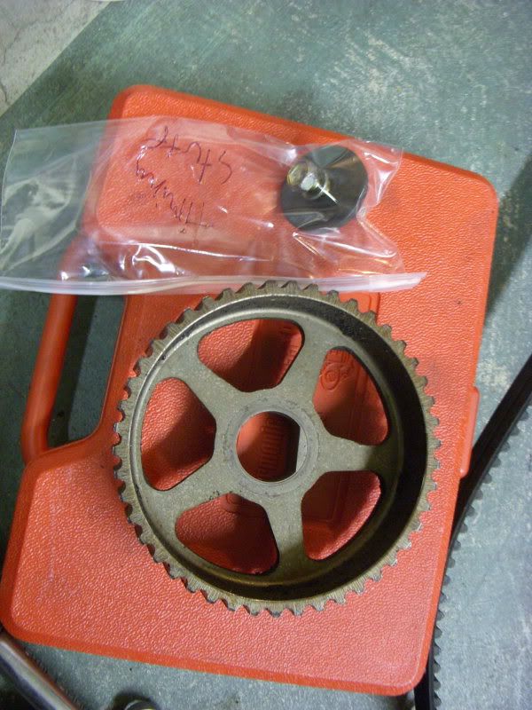

Camshafts as well
Now the gear on the camshaft is a bit scratched...is it good to take it to the shop before I reassemble back in with the head...or just get new cams haha?

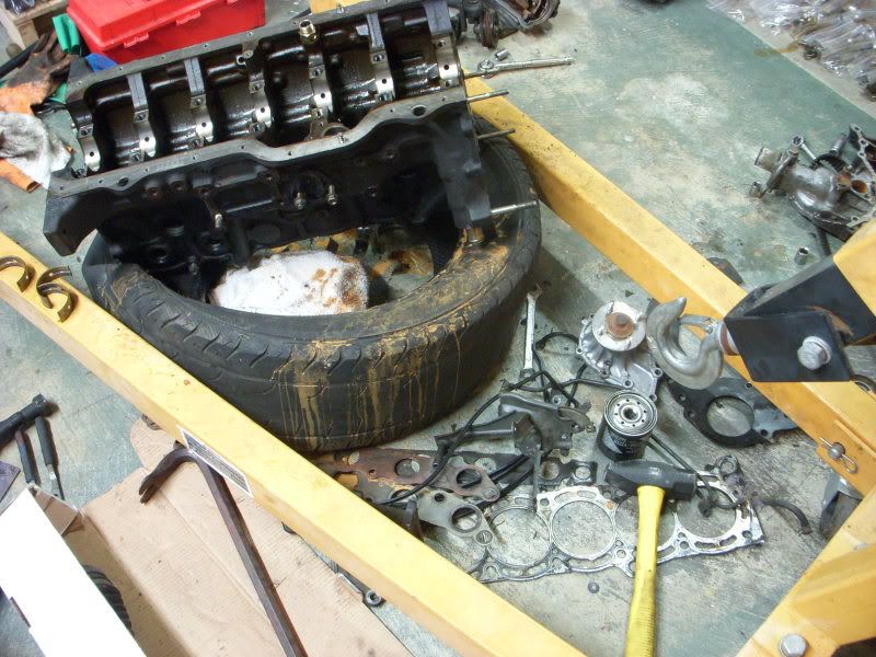

Now back to the block.

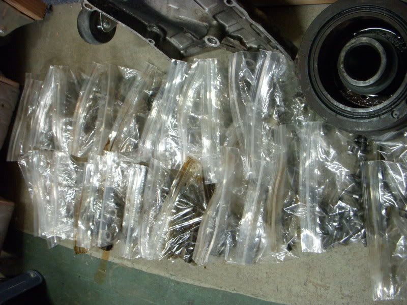

Starting with some miscellaneous stuff.
Here is the fuel return stuff off.
PS bracket up next
Now the piping around the block.

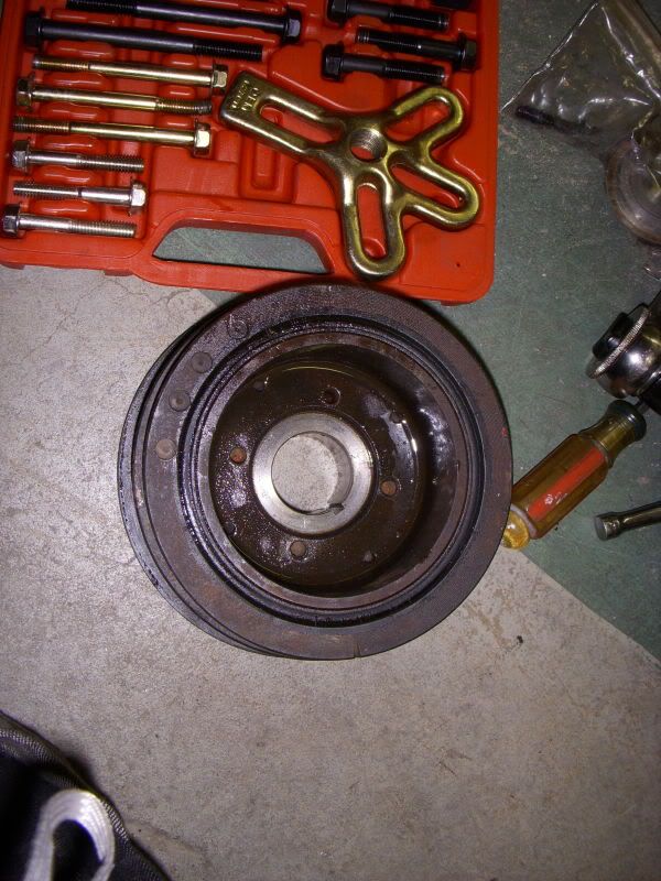

Now to the crank pulley!!
Bolt came off like nothing...three hits with an impact!! :lol:

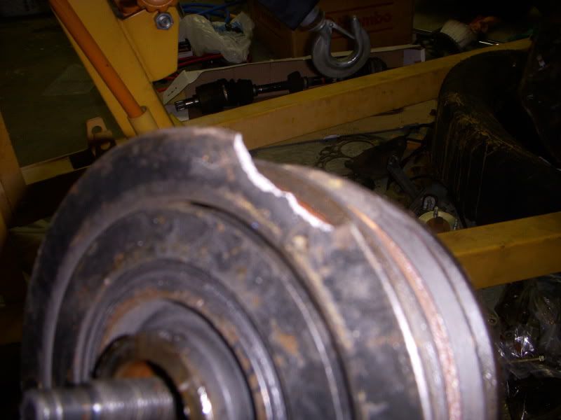

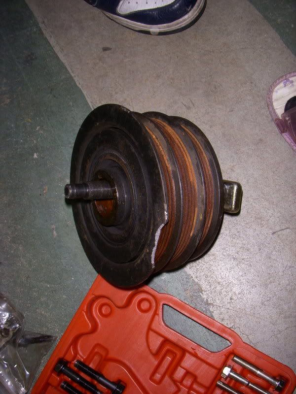

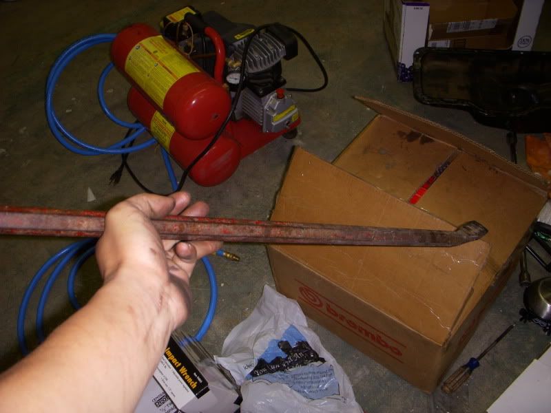

This is where it got hard...I went back and forth between stores to rent a total of like 3 crank pulley puller kits!
Here's the one that finally helped...it didn't even do the job. Just helped
LUCKY CHARMS FTL!!!
Then my second idea was this (very bad one might I add).
So I'm assuming you can guess what happened?
thinhman
Feb 7, 2009
75
Garden Grove
First idea failed me miserably so I got aggravated and pulled out this.
And with a little time, patience, and brute force it came off!
You can see here what happened with the first idea.
So anyone have an extra crank laying around?! I'll be needing one...sigh.

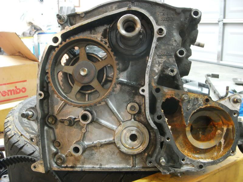

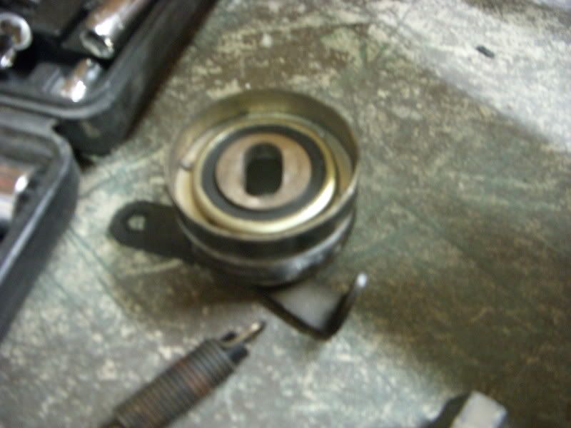

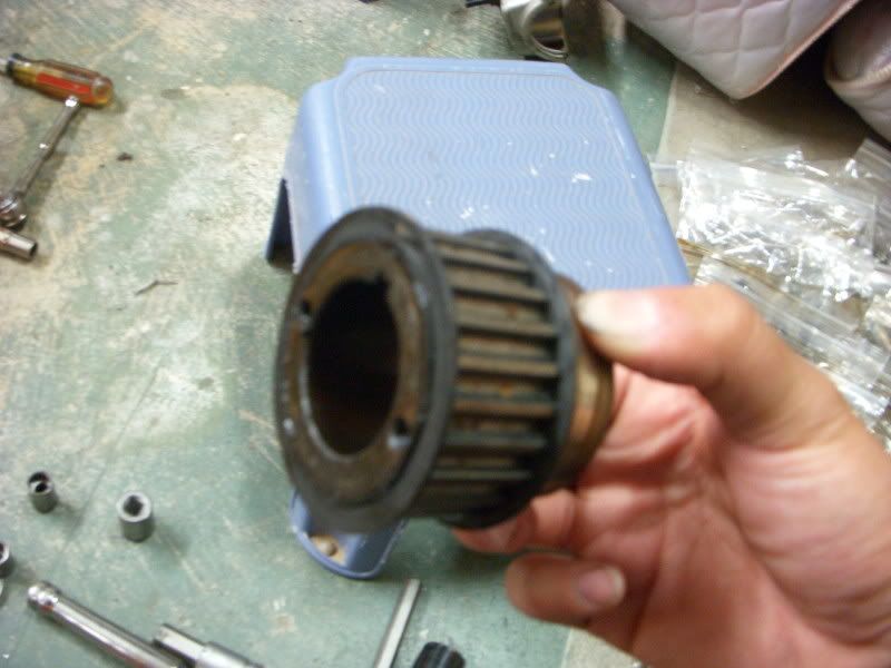

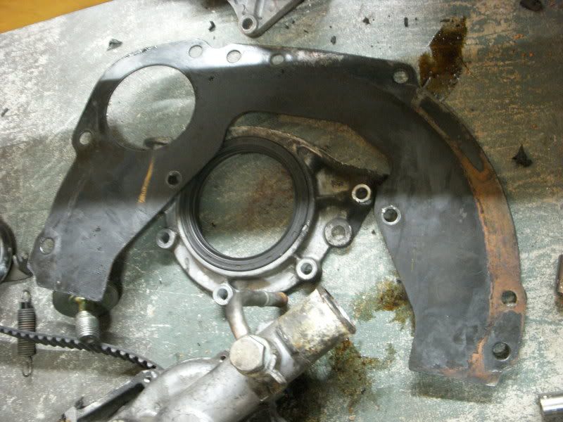

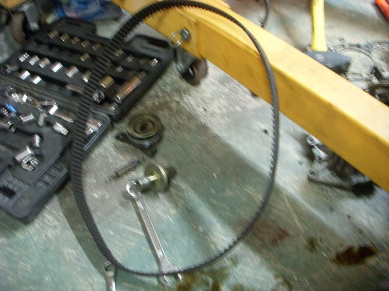

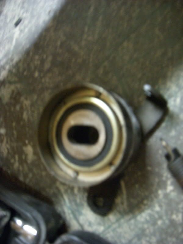

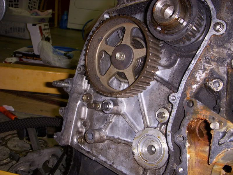

Up next, off came the belt and the tensioner along with the spring
This is where I'm at now

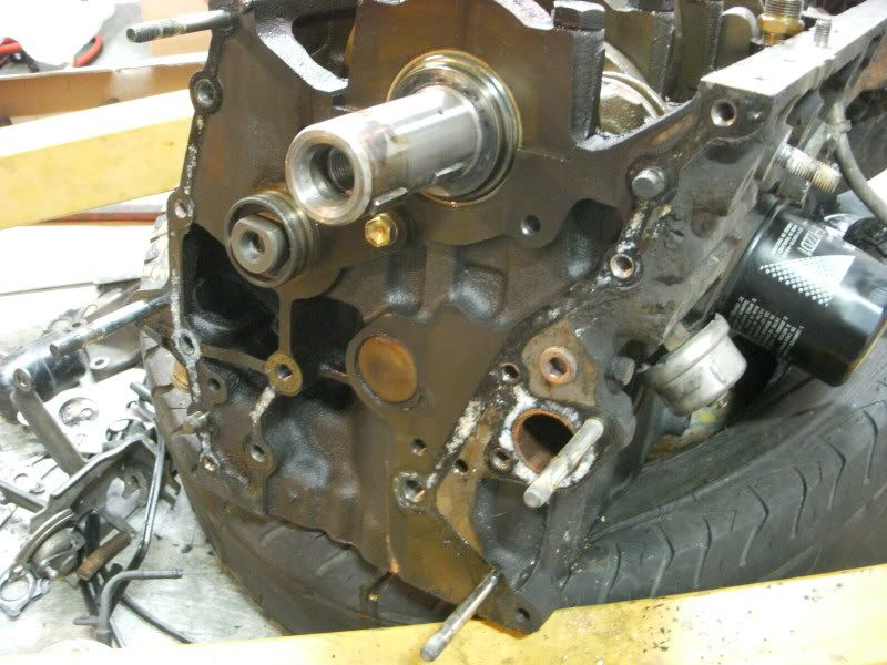

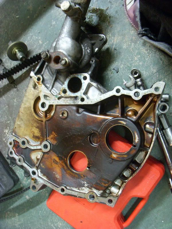

and now off with the oil driveshaft gear.
This thing came off next and finally the cover itself!
Tadaaa

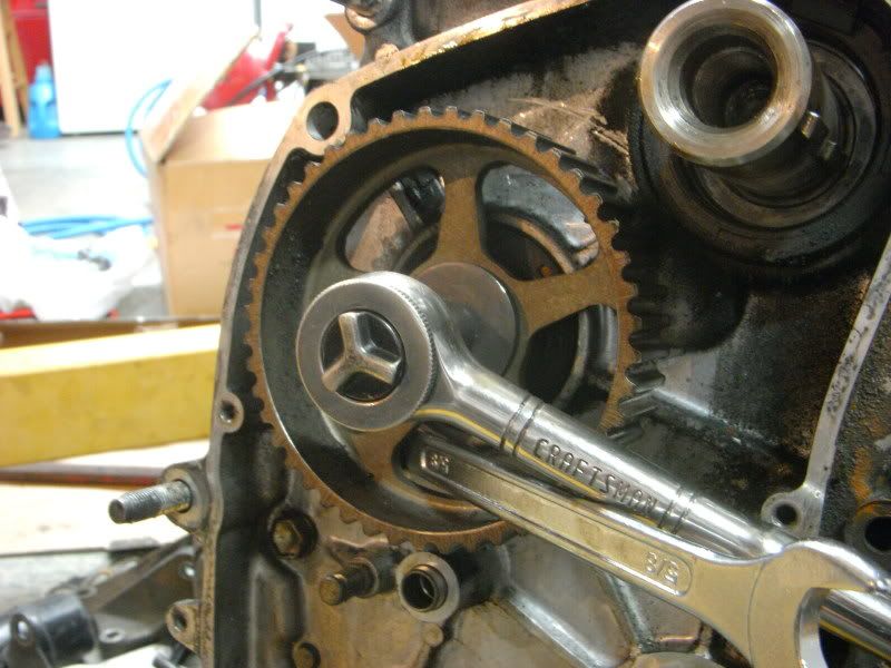

Looking good! About the machining, the only reason you want the timing belt tensioner torqued down is because it supposedly slightly distorts the # 1 cylinder, so you want to simulate a fully assembled engine when getting it machined. Also, for your machine shop, you just need to ask them what surface finish they will be able to get on the deck, measured in arithmetic average (Ra). Depends on the gasket you are going to use, but most call for an Ra of 30 or less. The smaller the number the smoother.

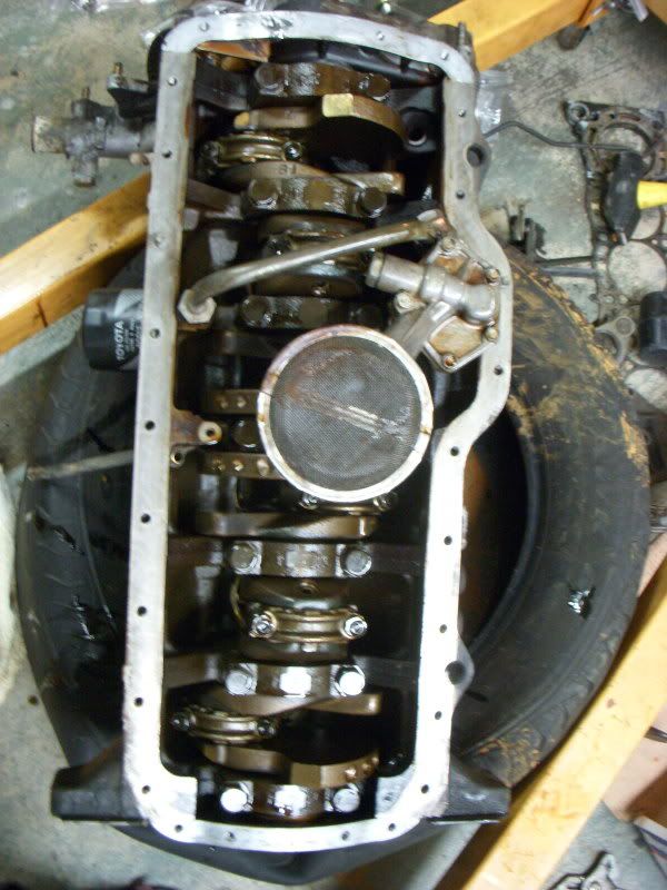

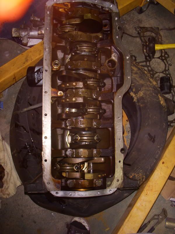

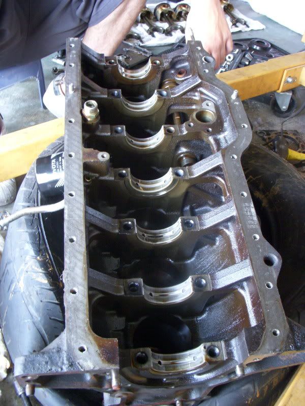

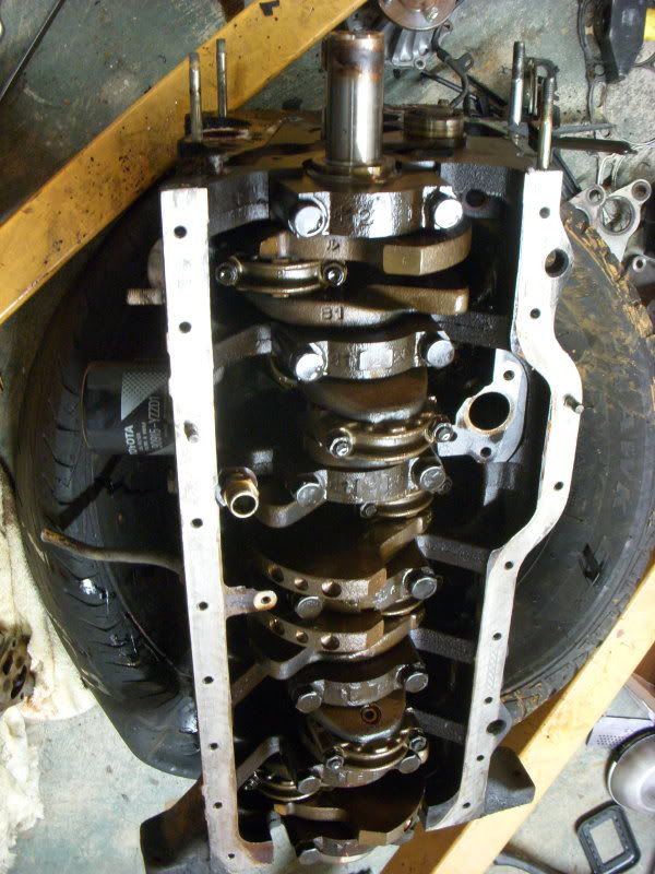

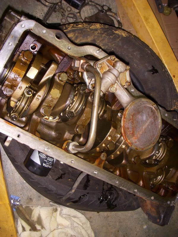

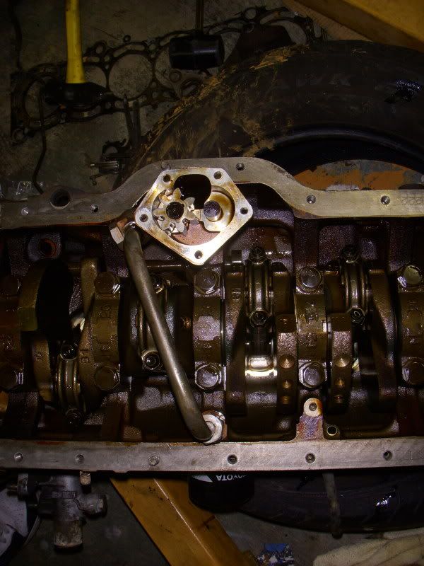

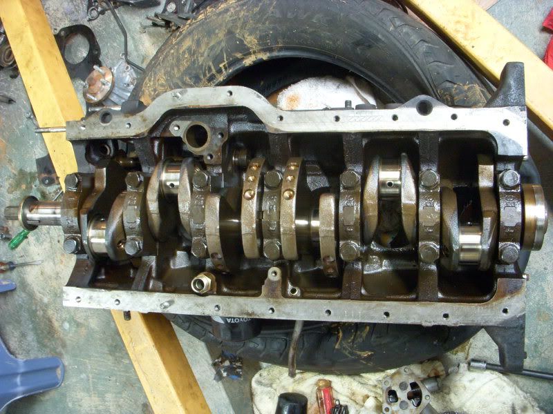

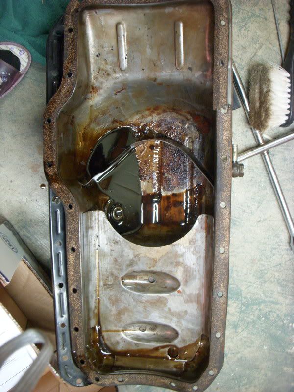

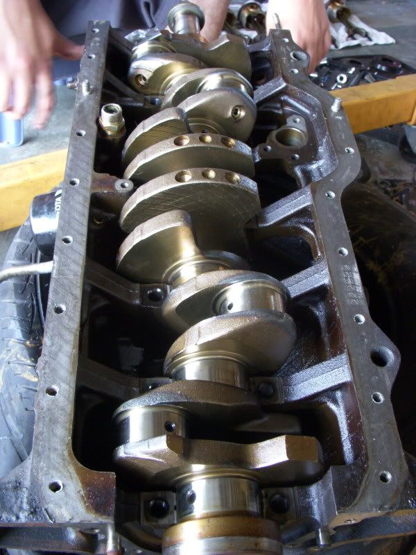

Fun part! So intense...I never had to pull and tug so much to get bolts off. First up to bat, is the oil pan!
First base is loaded...
OUT!!
Strike 3, 2 outs...

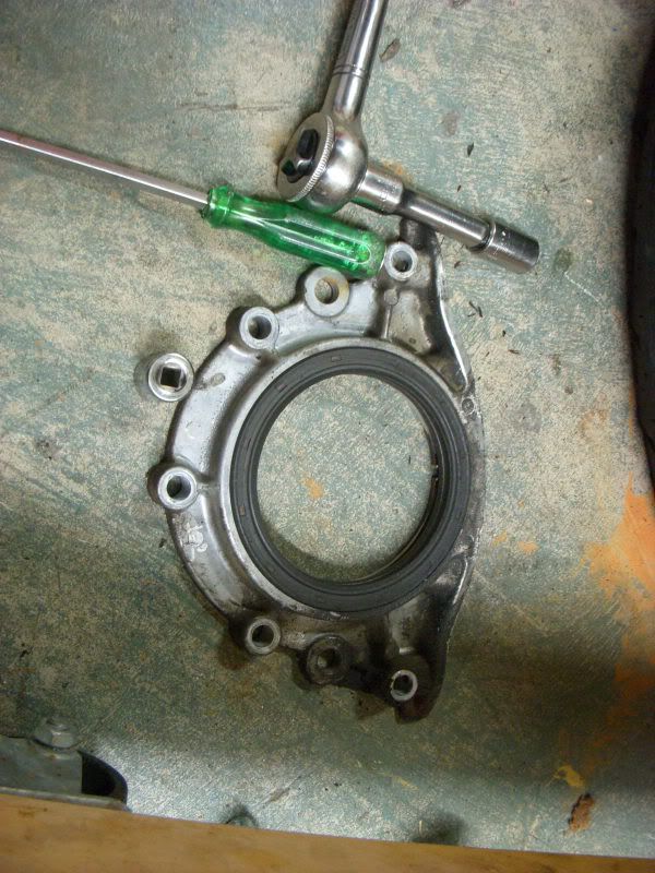

The left-hand batter, rear gasket, comes to bat.
3 Outs!!
The teams switch places.
Base 1 Loaded. God, these took forever to take off...with no breaker bar =[
Base 1+2 are loaded!!
All bases are loaded...
OMGWTFBBQKTHXBYE!! GRANDDD SLAAAMMM!
Here was the heavy hitter that took it home.
After those damn bolts...I called it a day.
Plus my 20 picture limit is up anyways, haha.

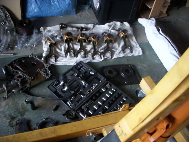

I got these little alien punks out.
It was like my engine was giving birth...I kept pushing, and some liquid would drip...and you get the idea. and POP the alien comes out!

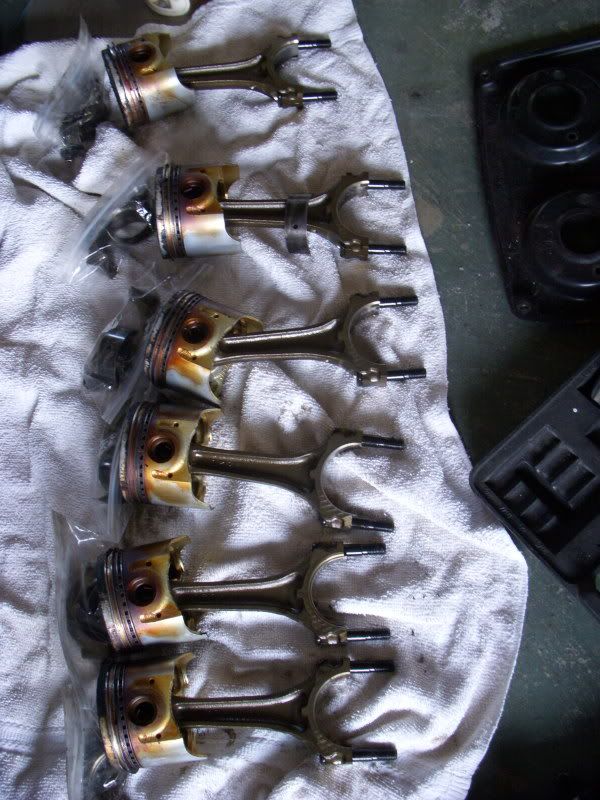

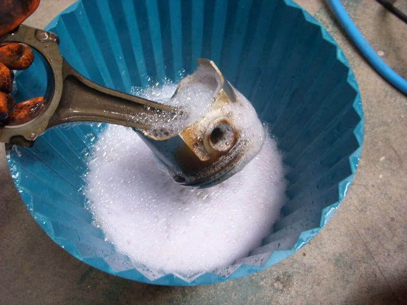

Did some reorganizing
And started to degrease the pistons...
Didn't do too much, but it doesn't look like I can salvage these pistons; they're horrible. More of that to come.

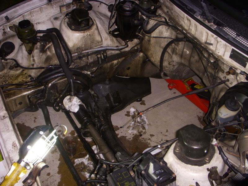

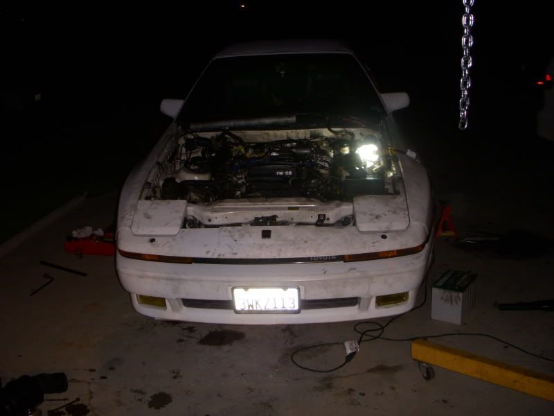

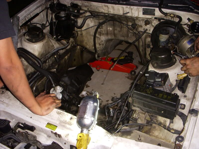

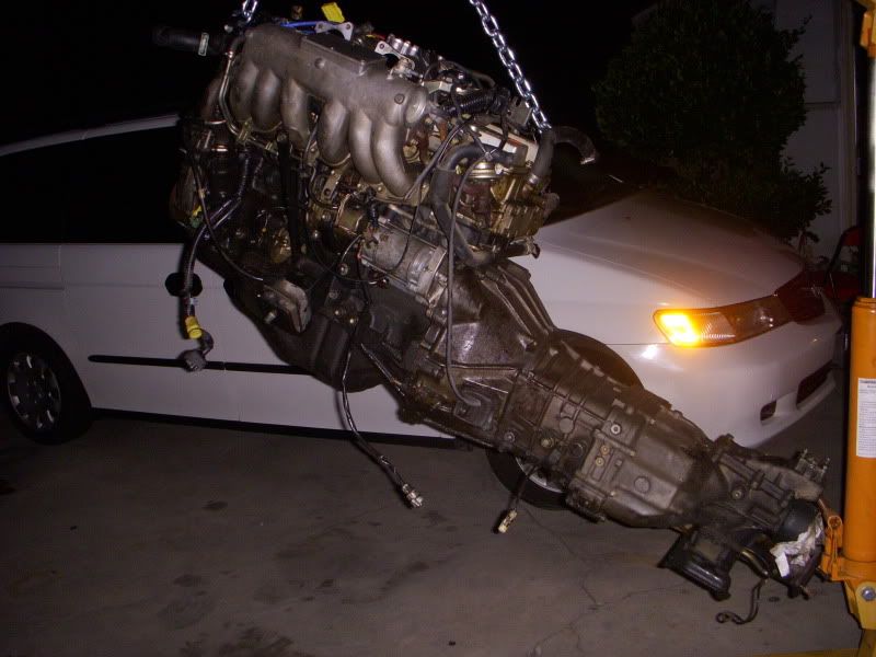

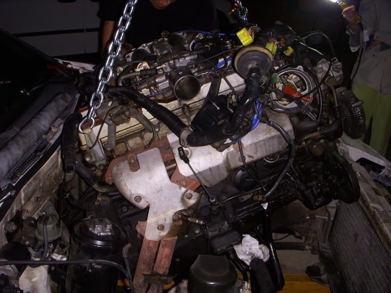

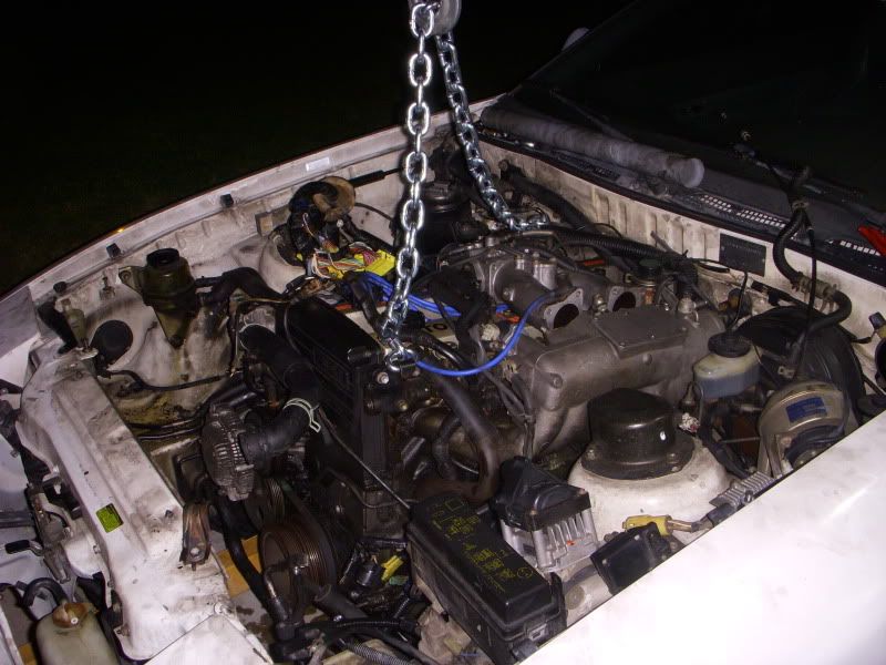

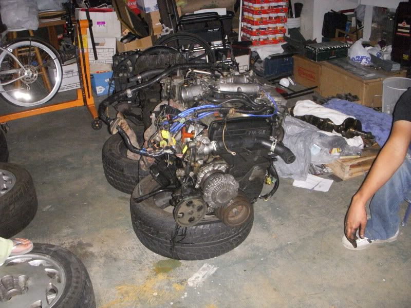

It's been a while but I was never able to finish my engine in time to swap it in before the current engine in my car blew. So had to pull the engine out and still prep my second motor for the shop.
Here are some pics of the engine being pulled.

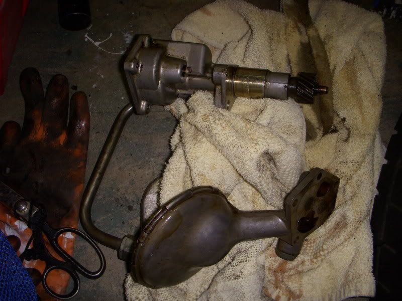

supraguy@aol
Well-Known Member
Dec 30, 2005
4,283
77
Atlanta
Hey dude- Be advised; it looks like the engine you're building is out of a Cressida, not a Supra. The only issue is that you'll have to replace the oil pump with the Supra type, and use the oil pan from your blown motor. The oil pickup on the Cressida's pump, and the shape of the oil pan would interfere with your Supra's crossmember. Maybe someone else can confirm this?
thinhman
Feb 7, 2009
75
Garden Grove
That was before I decided to get new pistons haha; the list on the first page is an updated one ^^. After I degreased the pistons I knew I needed new ones lol.
Still question about the cressida/supra thing. Anyone wanna chime in?
