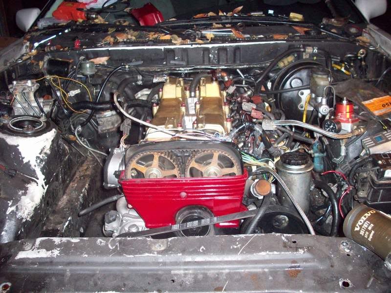

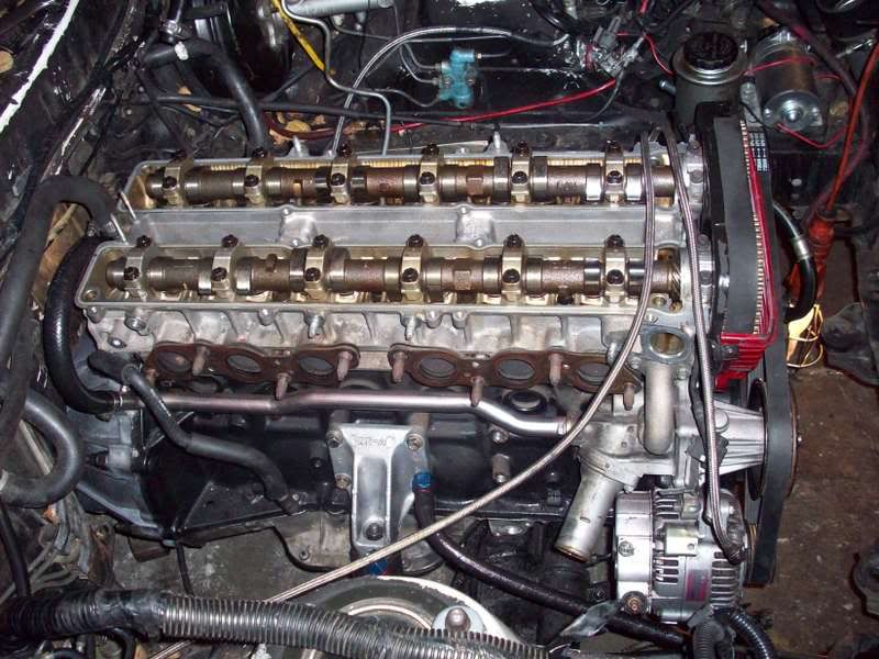

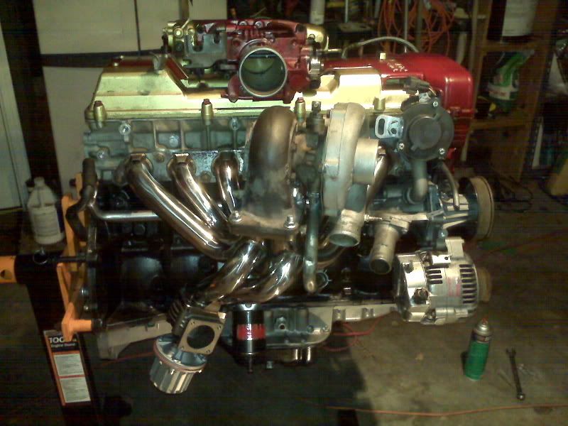

i just noticed in one of your pic's.the 2jz-ge water pipe that run's along the block faces up,which make's it nice for connecting to the heater core.on my gte block it shoot's straight out taking up dp space.i'm going to have to get me one of them,for next time my manifold is off.

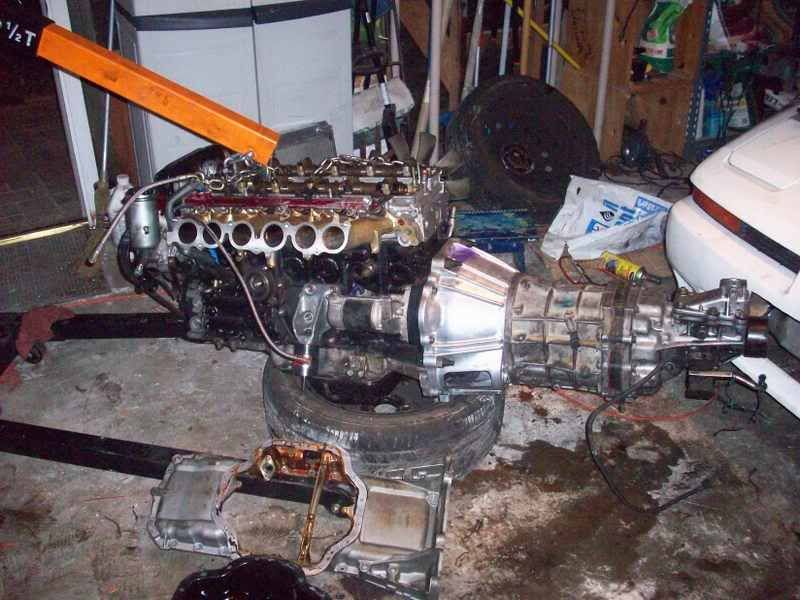

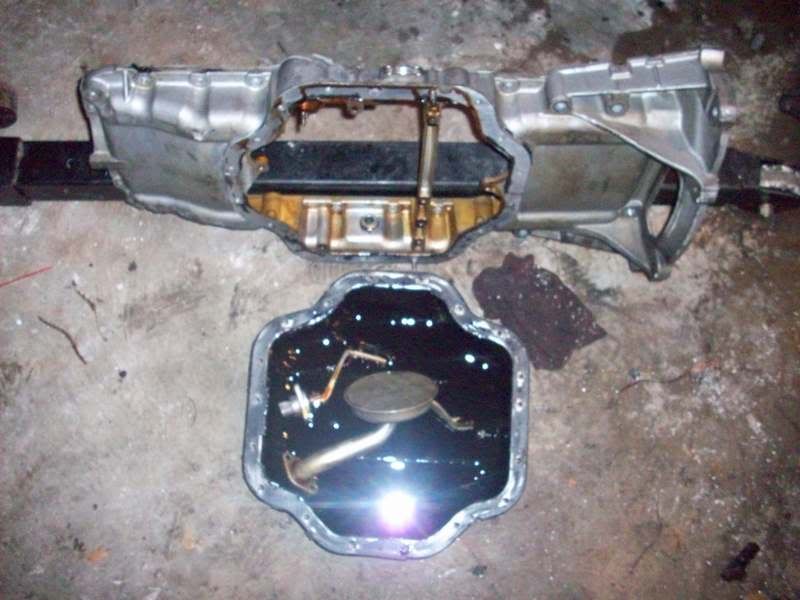

well, this BLOWS i dont think the pan is going to clear. i'm having a hell of a time trying to get the engine in. ofcourse the damn pan is hitting the cross member and its not allowing the engine to go anymore back. i dont know. i think the metal lower portion is not the right one, because the damn thing ALMOST fits. i dont know what to do. i guess now the stupid project is on hold again...:3d_frown:

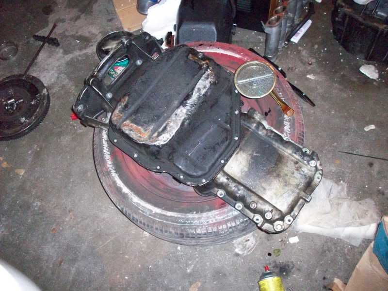

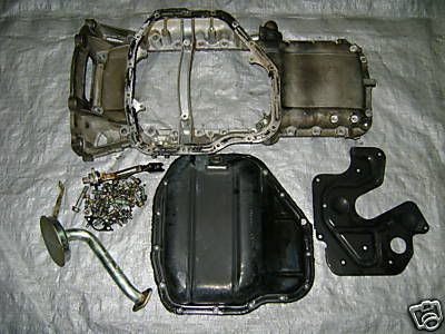

looking at your pics in the first page, your pan seems to be a true Mid sump pan as opposed to the mid/rear pan found on the 1j/2j supras. That might be why it seems so close to fitting but does not. There was a thread somewhere showing different types of pan for the 1j/2jzs, but I couldn't find it. Someone please correct me if I'm wrong.
This is yours from the first page
This is a mid/rear 1j sump, you can see the slight difference.

yeah i was looking at mine and i knew it wasnt that one. also though people say since its a mid sump its supposed to clear, i dont believe it does, i've found myself trying to take off the valve covers to get it back some more, but no luck. it just stays on top of that cross member. so, i'm going to try to source out a rear sump pan. because this is driving me crazy... it was awesome to see the whole thing together finally, but then that had to happen. so close yet so far.

i posted on another "supra forum" the answer to this question. but i'll throw it up on here too. i dont know what car its from i was told a mk4. either way, i have the rear sump installed now. the engine goes in tomorrow. here are some update pics, i stopped working on the car at 1am just because i want to wake up at some reasonable hour tomorrow to get a lot of work done.
here's the broken 7m with my iron man valve covers on it.
my car is missing its heart =(
rear sump pan before installation... not bad for 50 bucks!!
the mid sump that was on there, errrrrr.

the heater pipe that run's along the block could go straight to the heater valve.then just run the other hose from the head to the connection near the brake booster.
your getting there,hopefully she purr's like a kitten and bite's like a dawg:)

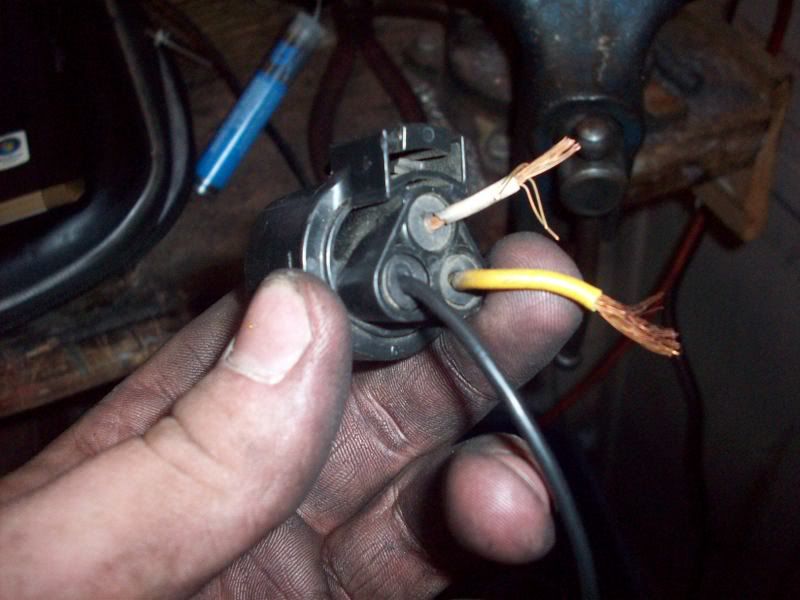

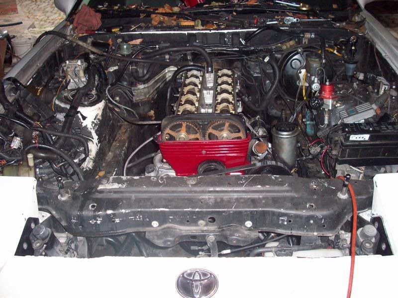

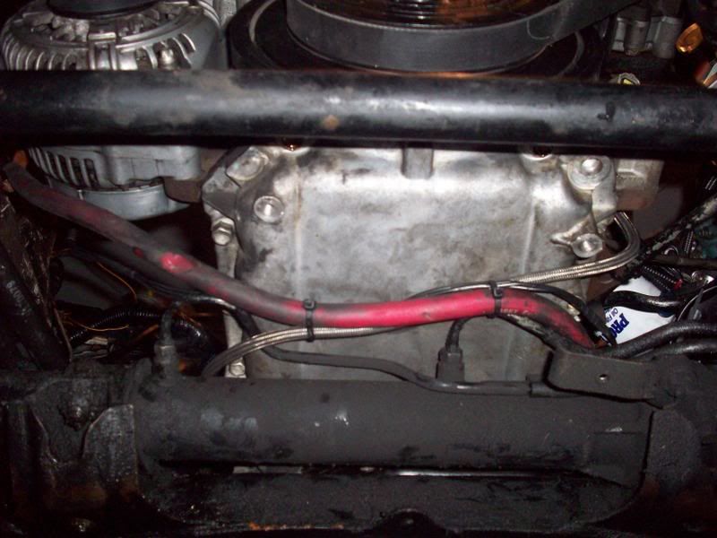

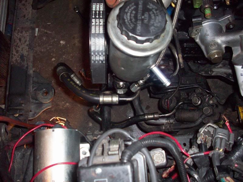

time for an update... yep at 5:15 am. i worked on the car til about 4am, time to catch some sleep. back at it tomorrow. pics...
replacing one wire on the alternator and extending all the others. the black one is the one i replaced at the spade connector.
recent underhood pic.
re routed alternator wiring and positive cable.

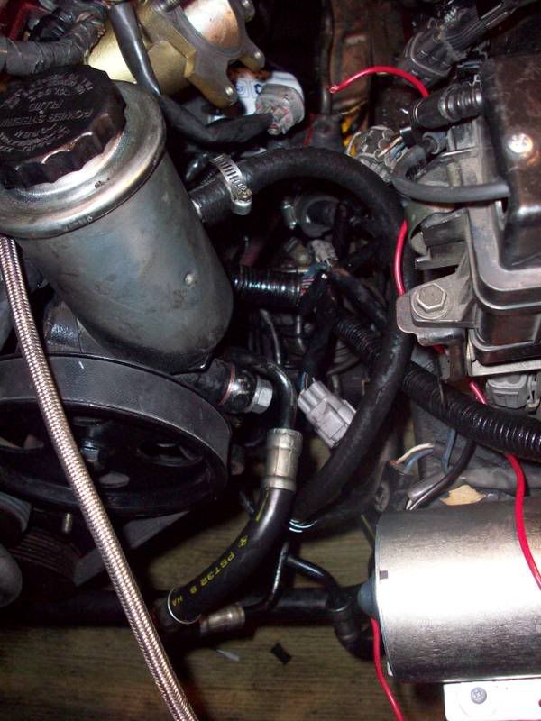

power steering conversion...
hopefully i'll have it running tomorrow.
