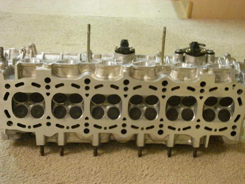

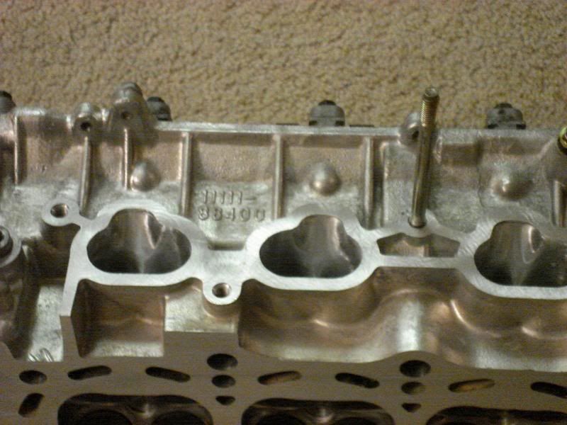

Here is one of the head. My camera sucks while taking pic inside. I'm sure it would take better pictures if I knew more about it, but I don't.
Here's a closer view of the port and polish. It looks great in person.
Can't wait to see your videos Josh. Great job!!!!
