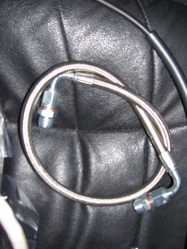

apexi287;912745 said:
If that's the 1JZ Power Steering line, then I think I got sent the 7M one cuz mine's uber long. :-\
apexi287
Jul 24, 2005
401
Knoxville, TN
It looks smaller in the pic then it really is, mine measures 25" if you want to give yours a measure to compare.

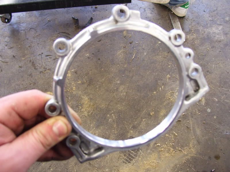

Sorry I haven't updated in the past couple days it's been a busy weekend, I have a couple more pics but unfortunately my camera died in the middle of everything.

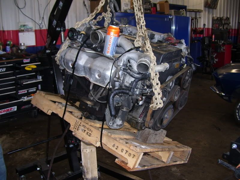

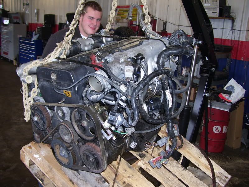

Well after getting it bright an early Friday, me and Adam(boostedmkiii) took it to my work to get it ready to go into the car.

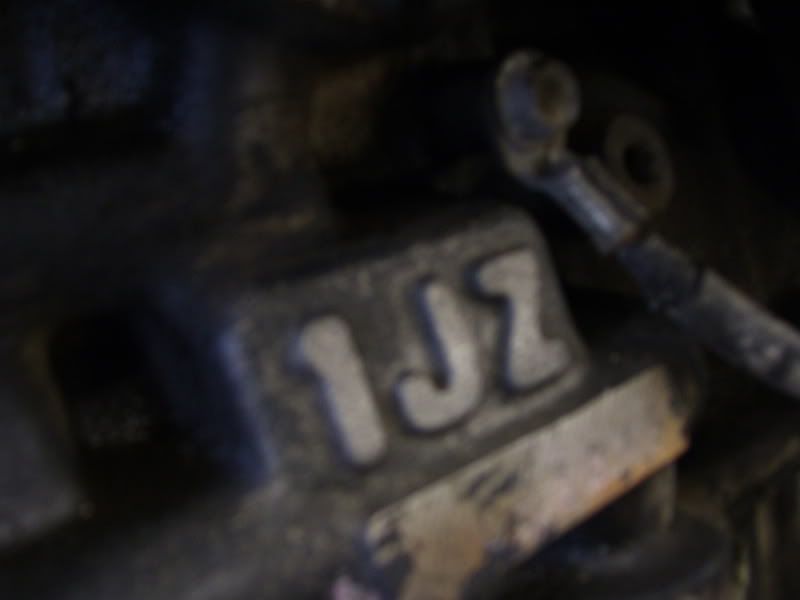

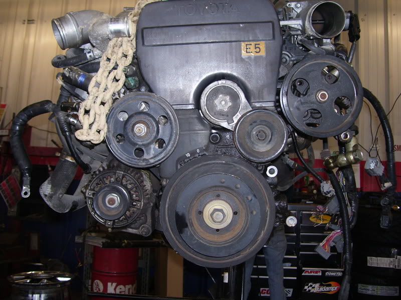

The 1JZ stamp on the block..

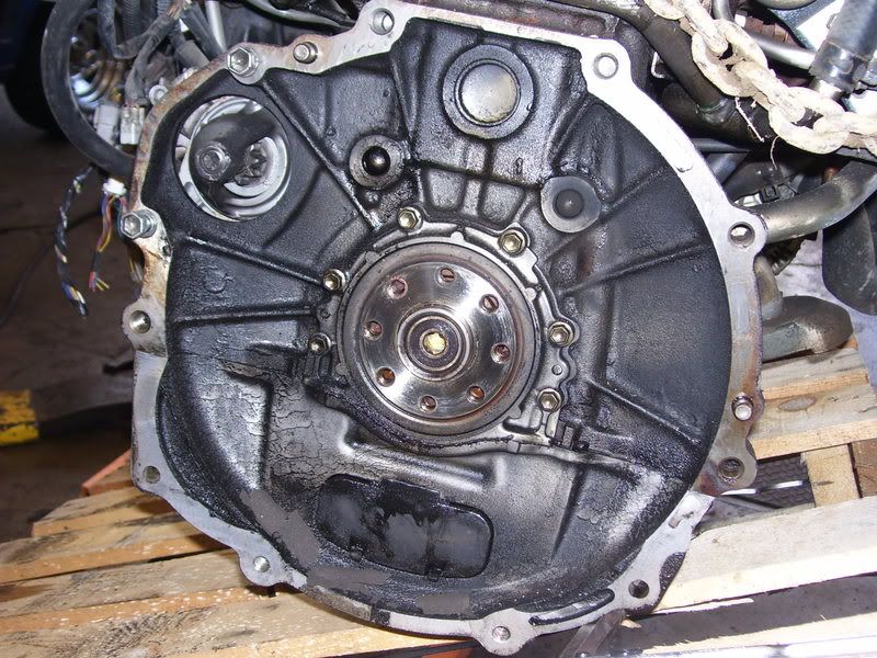

While it was still hanging on the hoist I figured it would be easier to get the rear main seal out and replaced then doing it on the stand.

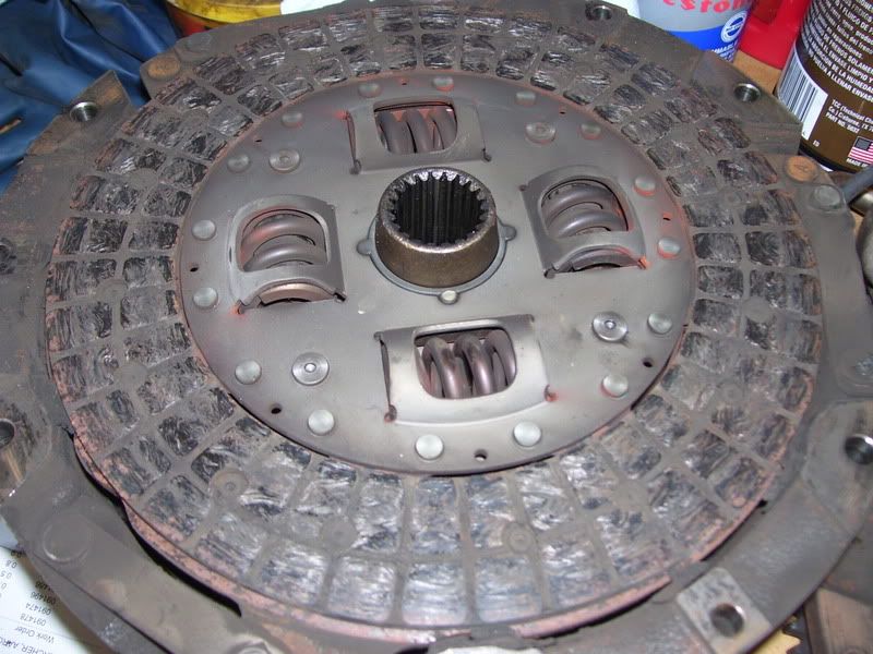

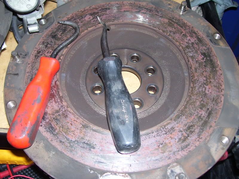

Old clutch out..
Then the flywheel that's going to need to be resurfaced..

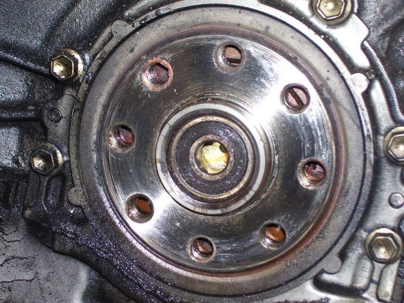

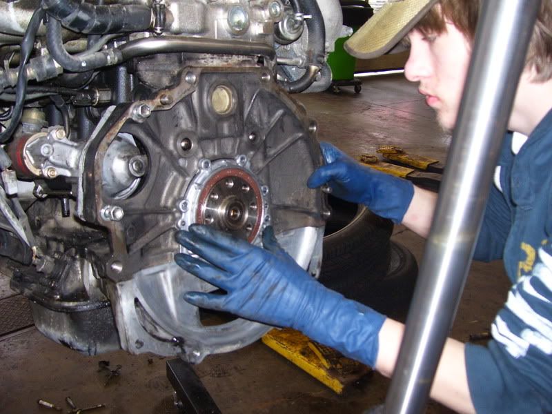

Revealing the rear main seal..
Tapped the old one out with just a hammer and 1/4" extension..
Cleaned everything up while I was in there and put the new one in, don't forget to use some dielectric grease or it'll make a horrible noise...

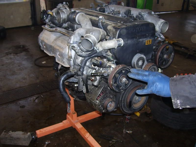

So we finished the rear main seal and put the motor on the stand, got the serp. belt off and the ac compressor and the camera died..

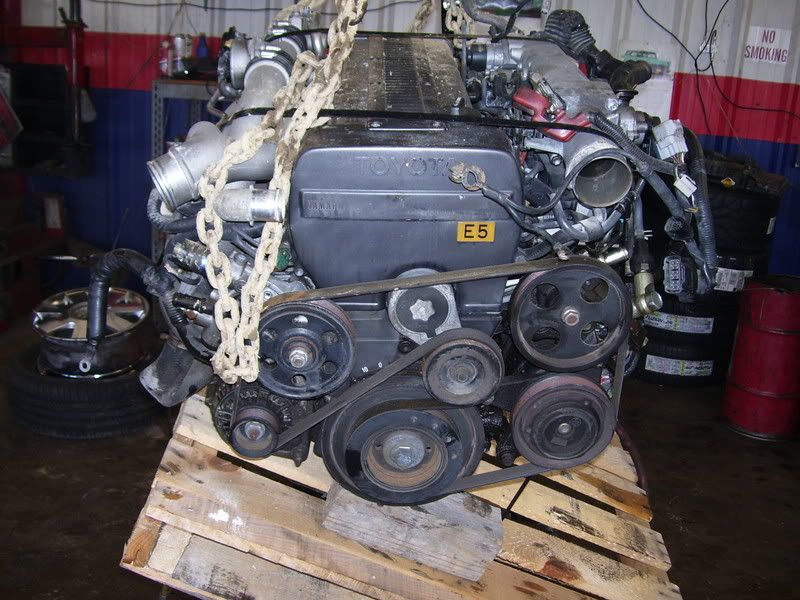

We didn't want to make another trip to get batteries since we had just gotten back with bolts for the engine stand, so we just finished the front main seal and timing belt. We would of had the serp. belt done with no a/c but the part number I found on this forum was wrong so I'm going to need to try and figure out what the real part number is for the belt with no a/c.

The belt I use for 1JZ with no AC Compressor is Napa Part 25-060747.
Checkers/Shucks/Kragen or any other parts house should be able to cross reference. Pay close attention to the routing of the belt. I bought 4 different belts only to end up with the one I started with because I was routing it incorrectly.:nono:
apexi287
Jul 24, 2005
401
Knoxville, TN
Ironically that's exactly what I was thinking when I was just looking at the pics I posted. That's the belt I ordered and after thinking of how I was routing the new belt versus how the old one looks in the pic I believe I was routing it wrong. I was routing the new one from the alt. under the crank pulley and not over the tensioner first. I'm gonna give the correct routing a shot tomorrow and I'm sure it'll work out considering thats the belt I got from NAPA.
