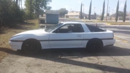

So here I am. New to Toyota and a 87 N/A with a W58 in hand. Ive already done one mild street build on an Eclipse GSX before, so I'm hoping that some of those lessons carry over to this car.

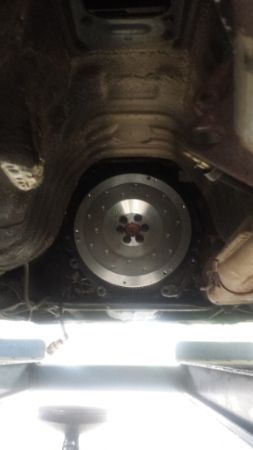

I got the car in April once I got to my new unit for 600 bucks with new struts to be installed. The car had a tore up clutch and a knock form inside the bellhousing being caused by the clutch ( I presumed). Well I got the clutch out and installed a Fidenza aluminium flywheel and an Exedy stage 2 clutch. The transmission has yet to be installed due to my crazy schedule and some parts thieves. So my new stuff is on the way....again.
For me to be able to work on this car, I can ONLY do work on it on Saturday from 1100 till 1900 which in all honesty isn't that much time, especially when I'm still learning the ins and outs of this car. While RWD is easier to work on then AWD, its still not my normal operational area. So with that said, please be patient with this build, because odds are itll be a while as long as I need a lift.
My end goal for this car is to stay N/A, reach about 250-270hp and 230-245tq. Whats really going to be important to me is response and handling since I want this to be a touge style car. My last car was more of a street build and that scene bored me because I raced dirt bikes for most of my life and all of there racing was in a straight line....and illegal. It will definitely have a standalone ECU, probably MS3, lightened, widened, new wheels and some street slicks. ( I can make this possible as I work where I sleep and don't need a car for day to day living.) Now before you go and shake your head saying oh god another ricer, butcher, moronic kid wanting to be an F1 driver, just know that Ill be doing it all the right way, getting help from professional shops when needed and maintaining as much original stuff as possible. I want the car to be for me, but to be looked at by the community as a job well done, not a cringe moment.
Now that you have the main story behind this build so far, I'll fill in the details :D
Got the car in April from a guy who drove it like an asshole and was PCS. He wanted 1500, so I gave him 600 for the car, the detachable steering wheel, 18x9.5in XXR 500s, an upgraded muffler, and brand new OEM struts (that I wont be using). The car has some body damage on the left side front fender, some paint issues on the back left hand side quarter panel, and a bad clutch; I think I still got the better end of this deal to be honest. I ordered the parts the same weekend I got the car and they came in about a week later. I installed them and couldn't install the tranny due to time constraint and forgot to get new hardware (the old bolts where chewed to hell). I went to Toyota and bought ALL the hardware ill need to get the job done 100% for the following weekend.

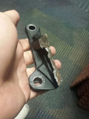

Following weekend rolls around and I get it back on a lift and start to install the tranny and I snapped the left engine plate stiffener somehow. I guess this will be how this whole build goes; I get 1 step forward and 2 steps back; but thats okay, as I don't mind waiting to do it 100%. I take it off the lift and back to the parking area.

If the transmission support snapped like that then most likely the transmission was not fully mated to the engine properly and was not lined up putting stress on that mount as you tightened it. Seems like an interesting idea for the car, however I will say right off the bat the MKIII is not the best starting point for an Auto-X type car. Even after spending thousands and thousands of dollars and cutting this and stiffening that a MKIII still will not be nimble as even a stock Miata or even a 240sx. These cars were built as Grand Touring cars, IE they are fat but comfortable.

Well, now that work has calmed down for the past week, I was able to finish up the supra stuff finally. Only took like 6 months to actually do some serious basic stuff. Thats the glory of only getting 1 or 2 days a month to be able to work on the car, and rarely things go smoothly.
So now I have the car all back together with a Fidenza aluminum flywheel, stage 2 Exedy clutch, Exedy throwout bearing, Suprasport short shifter, One piece driveshaft, with Lucas oils all around. I also did other general maitnece stuff as well like new fasteners and transmission mount. After the theft of my stuff, I'm not really rushing to get it done since I'm putting it in a shed back home where people cant mess with it anymore.
