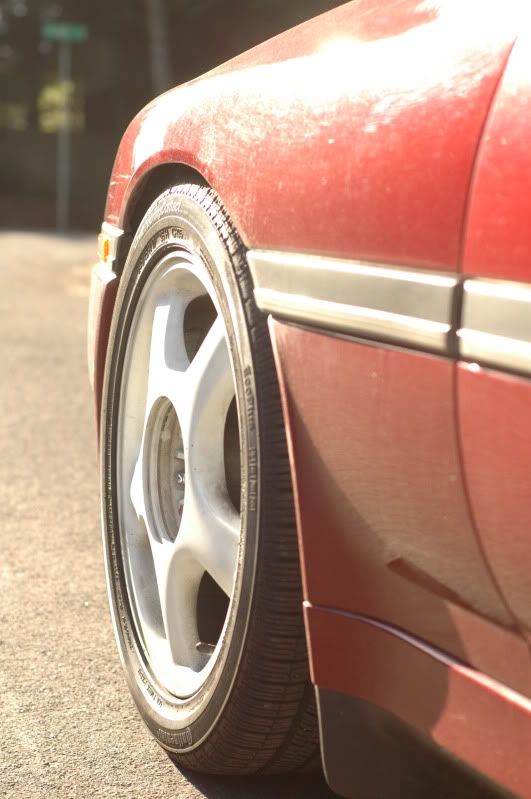

Get 25mm up front.
Here's how it looks with 245/45 on d2 coils with rolled fenders

R3N5LOW;1585981 said:
Get 25mm up front.
[THUMB]http://i51.photobucket.com/albums/f360/R3N5LOW/DSC_0132-2.jpg[/THUMB]
Looks good, but I have stock shocks/springs and don't plan to change that for a long time. Any problems/modifications when installing the wheels and spacers? Can you still use the wheel well liner when you roll the fenders?
