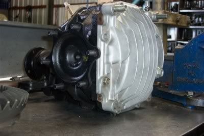

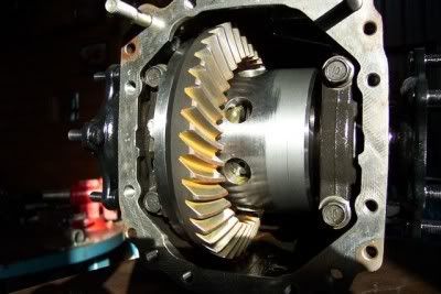

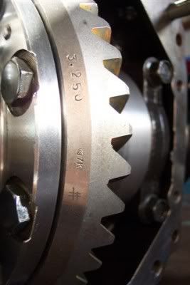

As far as custom ford 9" currie enterprise if you decide on streight axle to retrofit for a drag car
IRS go with krugel its the IRS suspension i planned on putting in my opel gt
Heres a picture of their work
