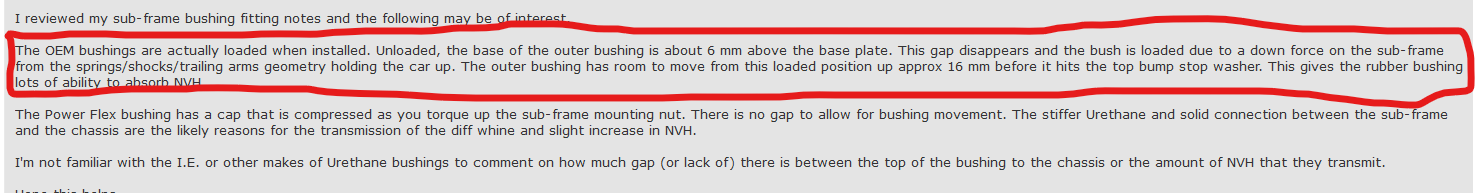

I was reading a forum for the BMW Z3, and came across this interesting statement from this guy.
Does the mk3 rear subframe bushing work the same way? I noticed that the subframe and bushing had a gap when the car was lifted on a lift. Some people say this means the bushing is bad but I am not so sure now. My stock rear subframe bushing have no tears. I think it was ok all this while.
