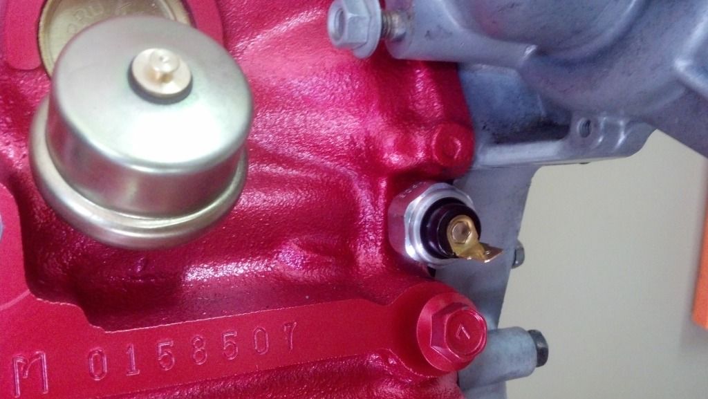

I added a low oil pressure switch to my block, so that it'll light up any time i fall below 5psi.

Nice. What's the part number for that sender unit, and does it thread into an existing port, or do you need to do something to make it work? (I hope to God that I never need such a setup, but I would probably be willing to put it in place to avoid needing to tear out my engine.
supraguy@aol
Well-Known Member
Dec 30, 2005
4,283
77
Atlanta
Wells PS123, used on roughly a kajillion cars.
Cost about $8 shipped from Ebay, and threads right in.
I plan to install a single red led into the face of the oil pressure gauge, inline with a small
Beeper, also mounted into the gauge cluster.
