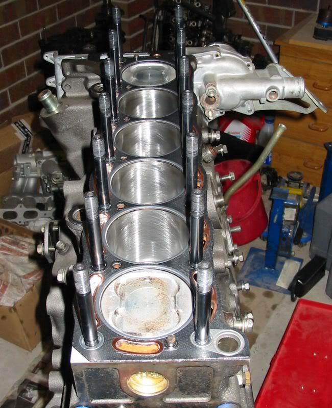

Block all prepped and ready for head install:

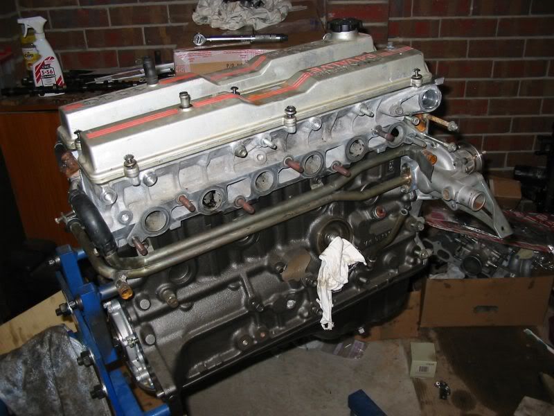

Head ready to go back where it belongs:

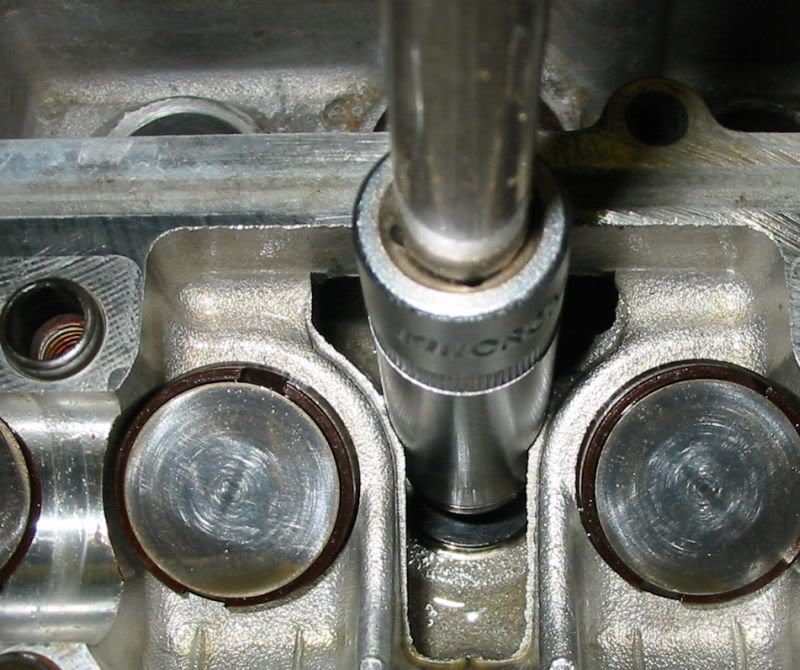

Socket clearance problems (sorted out by machining .5mm off the diameter):

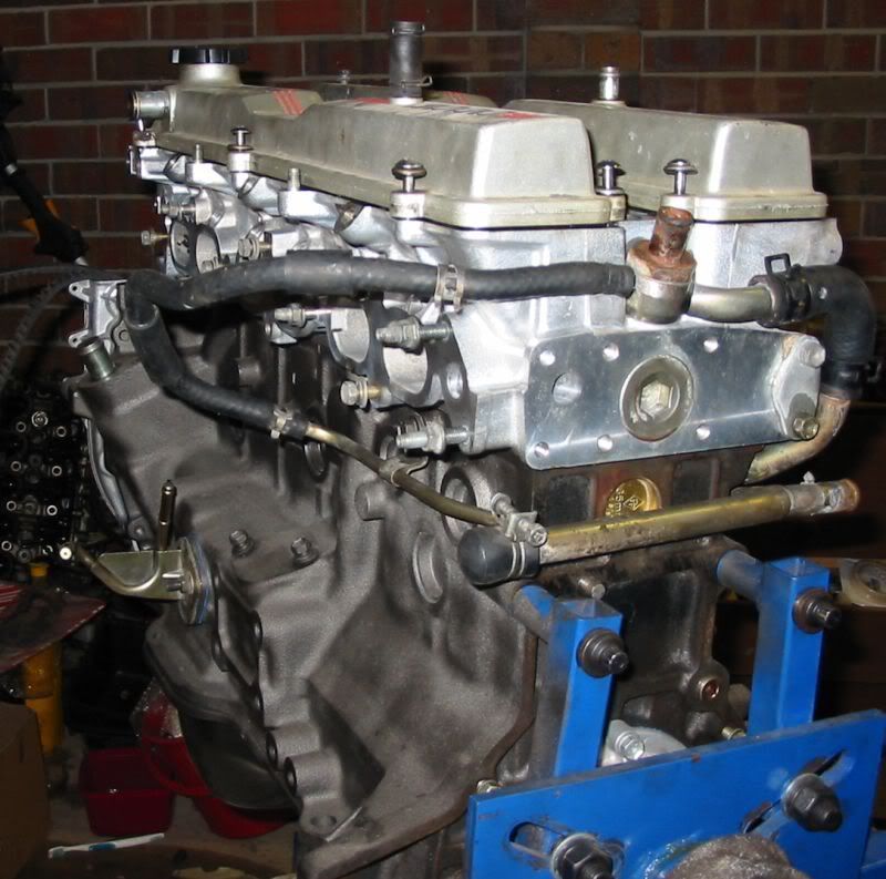

Bypass pipe installed:
Jtube installed:
