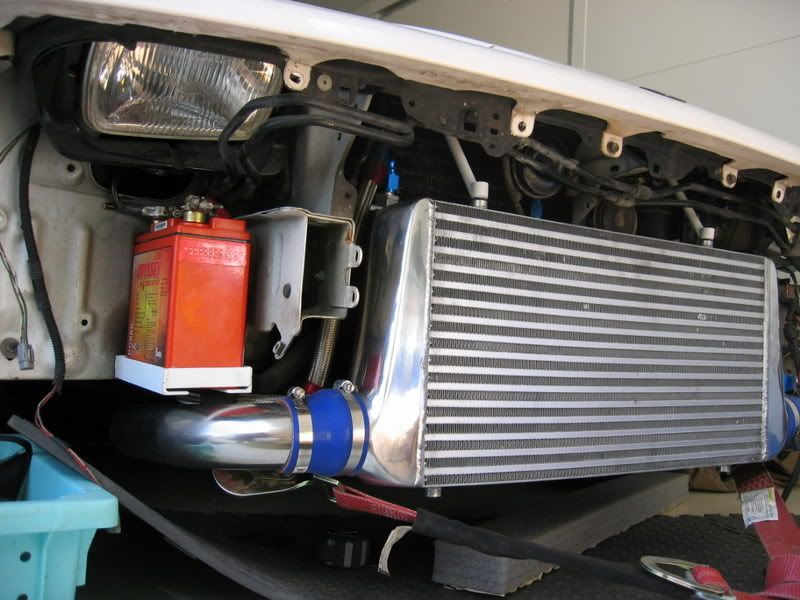

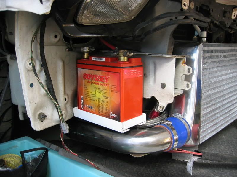

Just so you know, I have been extremely impressed with my Odyssey 680 battery. I've had it for about 3 years or so and let it go completly dead at least 15 times. It just keeps charging right back up. Any small battery will not have much CCA. With the odyssey 680, you need to keep a battery tender on it if your not driving you car at least a couple times a week. In the winter, the battery tender is almost always needed. But that's the price you pay for removing 25+ pounds off of the front end. I have no regrets.

/\Yeah, I used that battery for a while when I lived in a condo (with no where to plug in a tender). In the winter I had to start the car every day to keep it charged.
