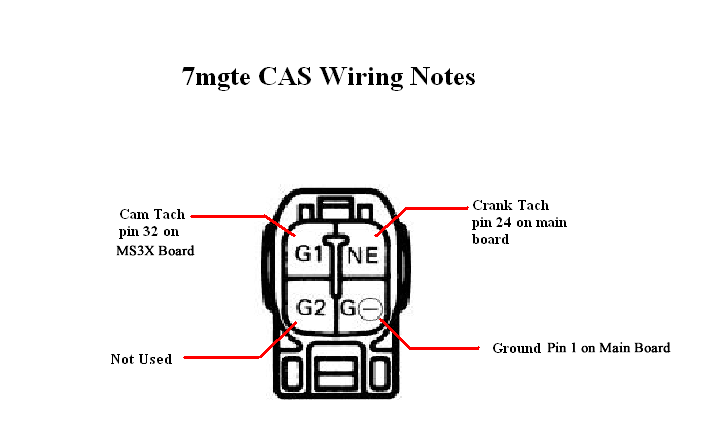

for those of you that want to run full sequential fuel and ignition, i teamed up with a guy named TerrenceLP and he is a pretty cool guy! we pretty much got rid of our entire engine harness and we eliminated what we don't need or want to get rid of all the unnecessary wire clutter. we are reusing all the toyota relays like factory as you will see in the diagrams below. anyway i just want to post the diagram i drew up to make it easier for others if they decide to take this route.
attachment.php
notice the left 7m resistor box is paired while the one on the right which is Acura legend Box is individual resistors. they are on ebay really cheap.
I COMPLETELY REMOVED the Toyota ECU (TCCS) from the harness.
I then wired up my Custom Wire Harness using the B1, C1 and M1 connectors.
B1 & C1 Referenced below
C1 - Thin gauge black/orange -> connect to -> B1 Thin gauge black/orange
B1 - Thin gauge black/orange -> connect to MS 12v power
B1 - Small gauge green (FC) -> connect to MS Fuel Pump wire
B1 - Large gauge black/orange -> 12v for connection to Injectors and coils (*I'm not using IAC or CSI, these can also be powered by this)
B1 - Large gauge black/blue - 12v for Starting. Remove and leads to the TCCS and run directly to the starter
