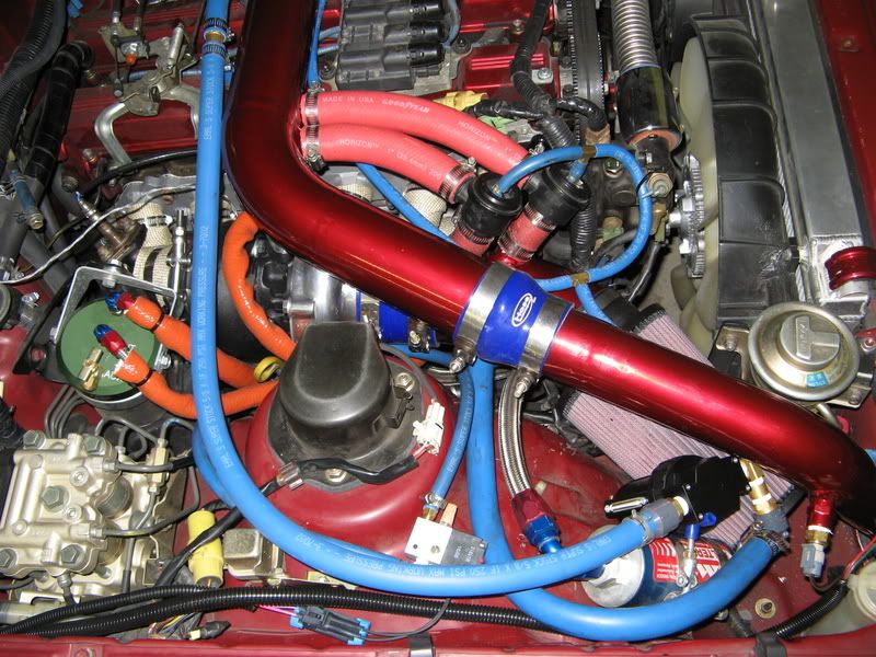

I now have possession of this turbo but still need answers to the above questions. here are a couple of pics...

Are you sure that's not a .63 hot side? It looks very similar to mine, and I have pretty much the same turbo it appears.
Quality out of the box is as good as anything else I've seen. Price was great. About 1/2 what a comprable "Garrett" would be.
Have not actually run this turbo yet. (Might be a different story by the end of this year..)

Does not look very big under there.

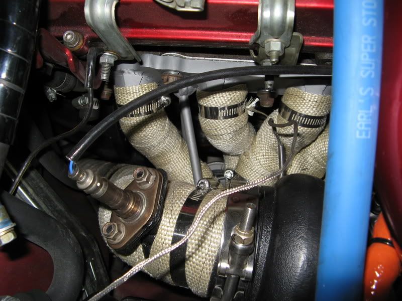

Close up of the V-band side.

^^^^because you are right. It's not garrett internals but garrett parts can be used. Also adjuster maybe you got a older unit? As the newer ones are a .68ar turbine
ahmedootie
Camel Jockey
May 16, 2005
112
Vernon Hills, IL
ok, this is definately a .68 hotside. I know it has Greddy parts, very minimal shaft play. I think I'm gonna stick with it. NOW, what kinda numbers are people putting down with these?
