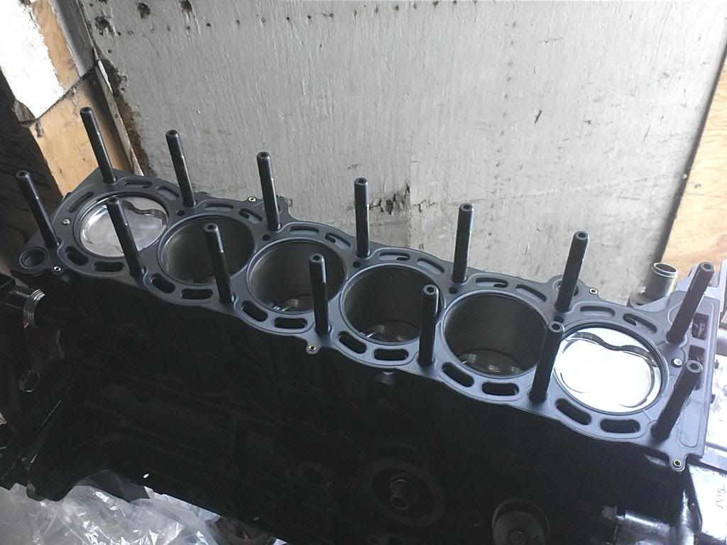

Only way I can imagine that much coolant being in the oil before ever even having started the engine is if someone completely forgot to install the front freeze plug, which would allow coolant to drain strait into the crankcase
Did you have a gaping hole where the brass plug is in this pic?

Take a look at the rivet at the lower right hand side in this pic. It sits on the lower timing cover just a bit. In this case though it's far enough out and does not hit on the actual head, so I left the rivet in place. What I understand as the actual problem riven is that there are some gaskets where there was a riven opposite it, which sat on the timing cover where it would be between the timing cover and the head. This of course caused big issues.
5
45
Nah, it's that rivet you pointed out. There should be room, but if the head and block are decked, there might not be enough room, so it's safer just to remove it.
Well I am pretty sure I put that freeze plug in but I will have to check. the engine has been sitting for about about two weeks so I think the oil is all floating on top of the coolant.
So if I pop my head off, I should just drill that front rivet out?

Well, if you pop your head off, you should drill ALL the rivets out to clean your MLS head gasket if you plan to re-use it. Or, drill that rivet out on a new one.
I checked mine for clearance, and I'm okay.
