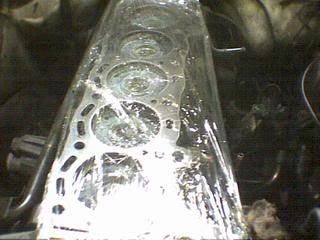

Heres a pic of my block ready for stock gasket I hope yours looks somthing like that
Just put a straight edge over the block to make sure the cover top is not higher than block edge
