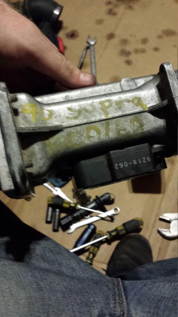

kakanator;2019123 said:I went to the junk yard today and picked up a 1uz afm .
