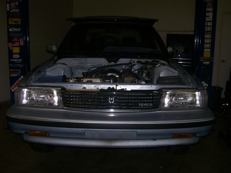

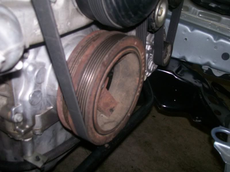

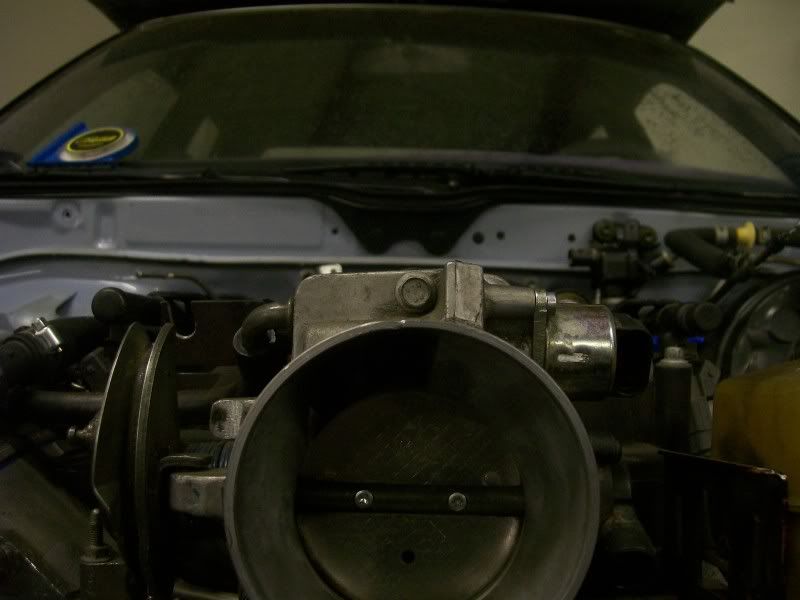

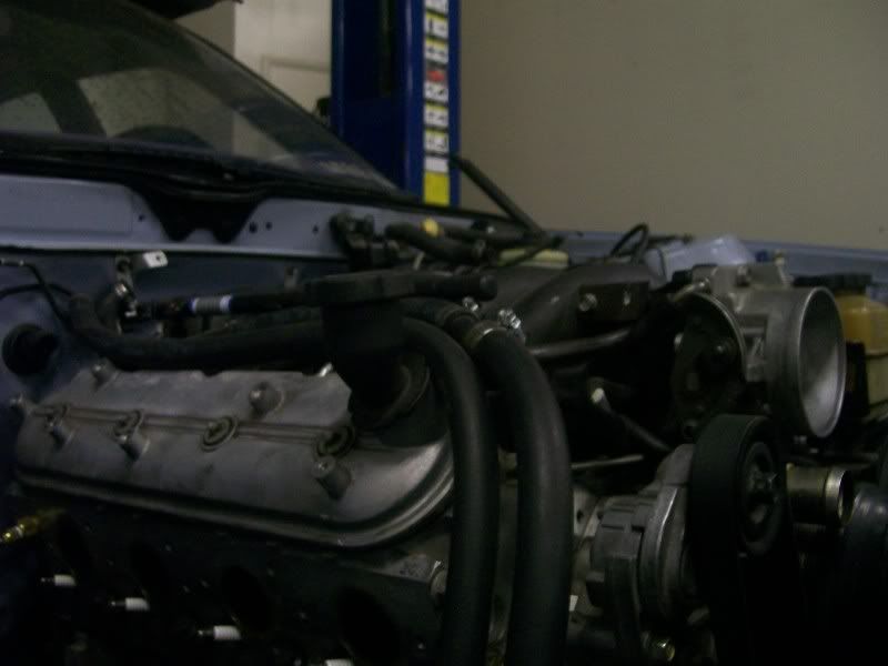

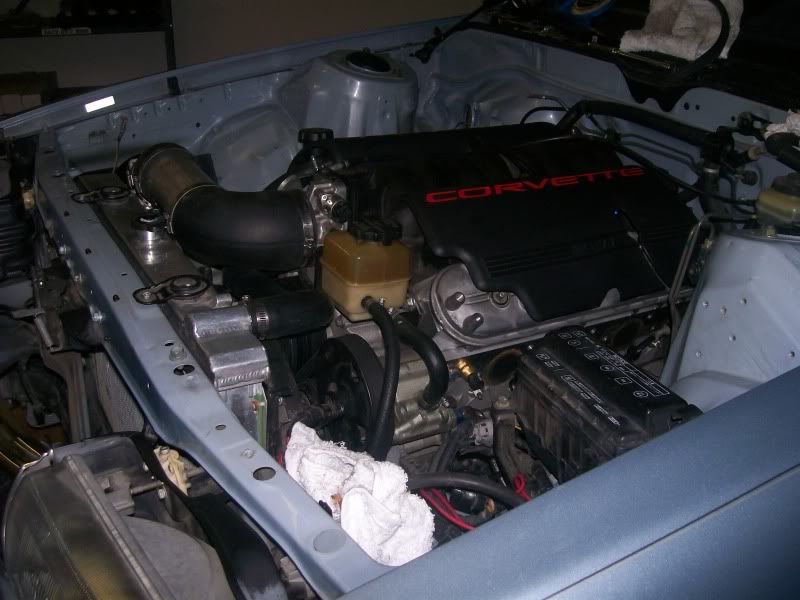

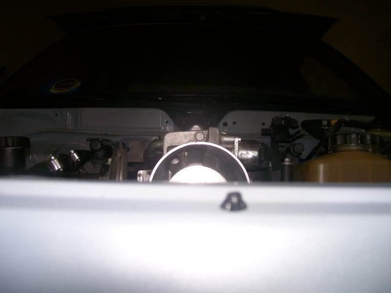

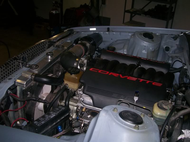

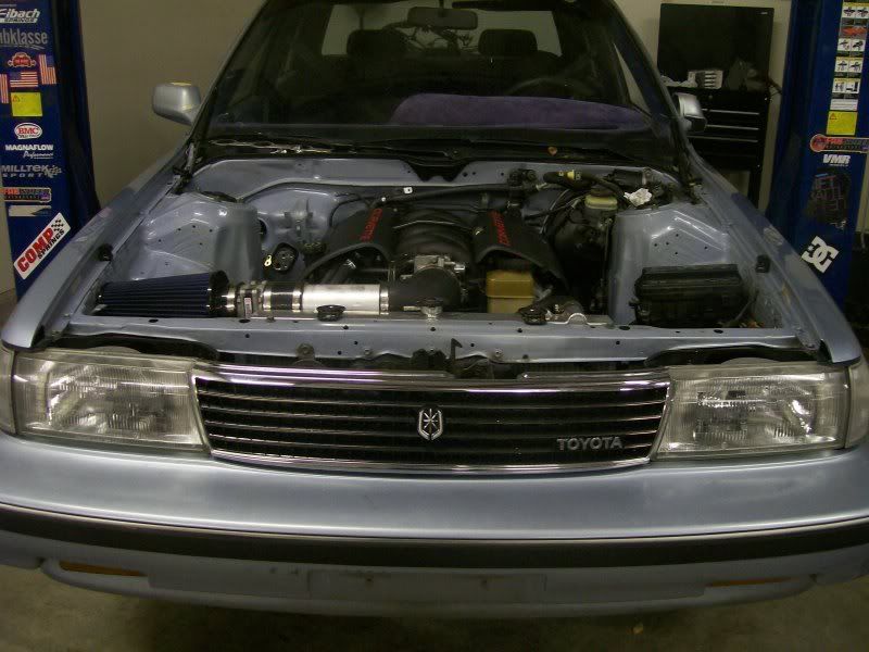

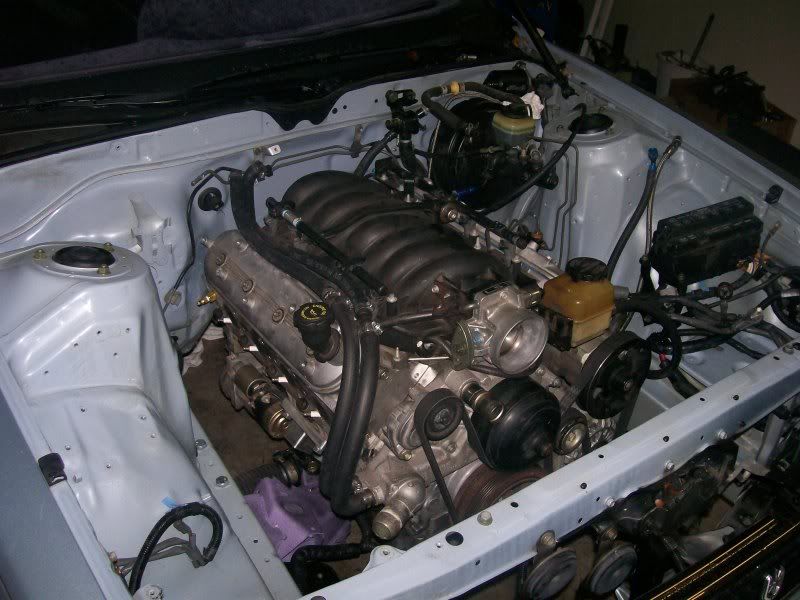

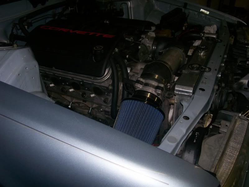

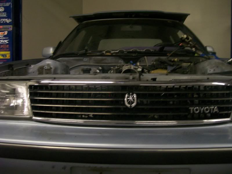

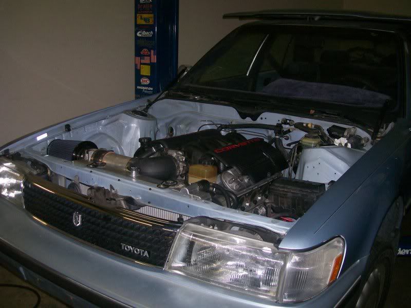

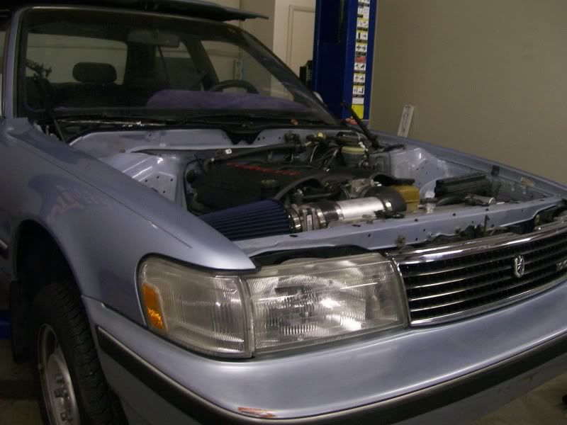

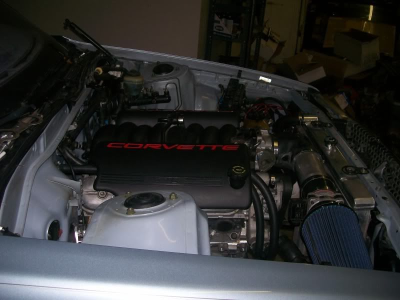

So here it is, my friend finally decided to swap the ls1 into something other than his 240 sx.

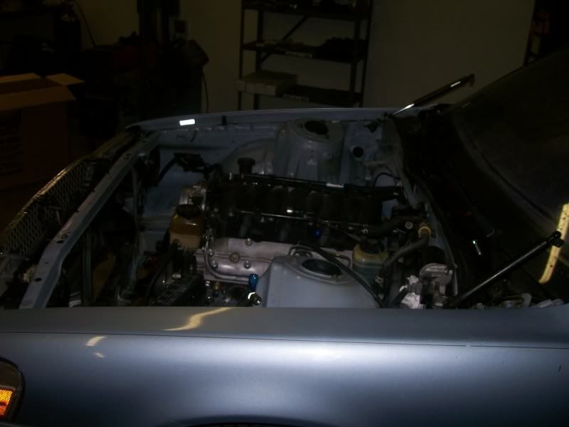

1990 cressida with 75k original miles with a 7m, with a rod through the side of the block under the starter lol...

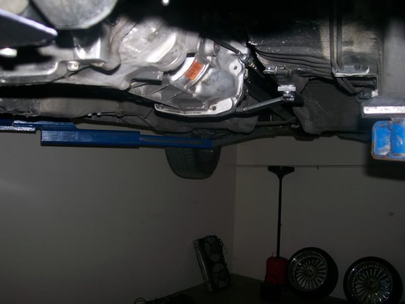

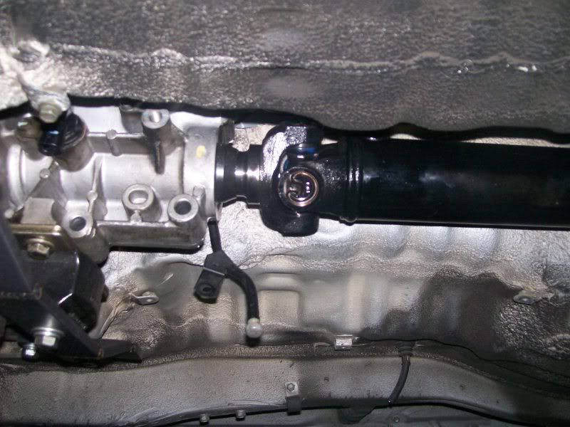

and here's the ls1 and the 6 speed.

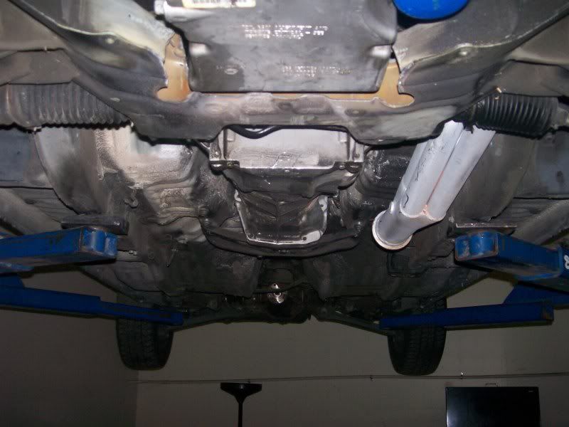

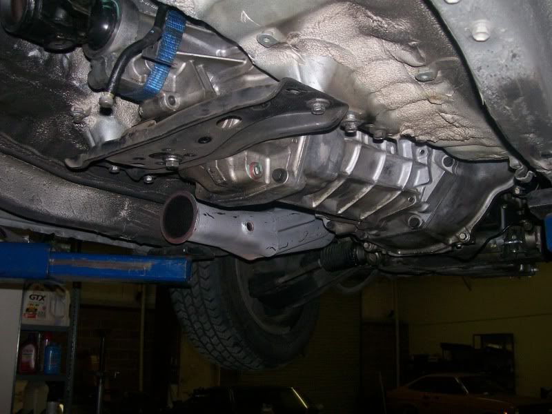

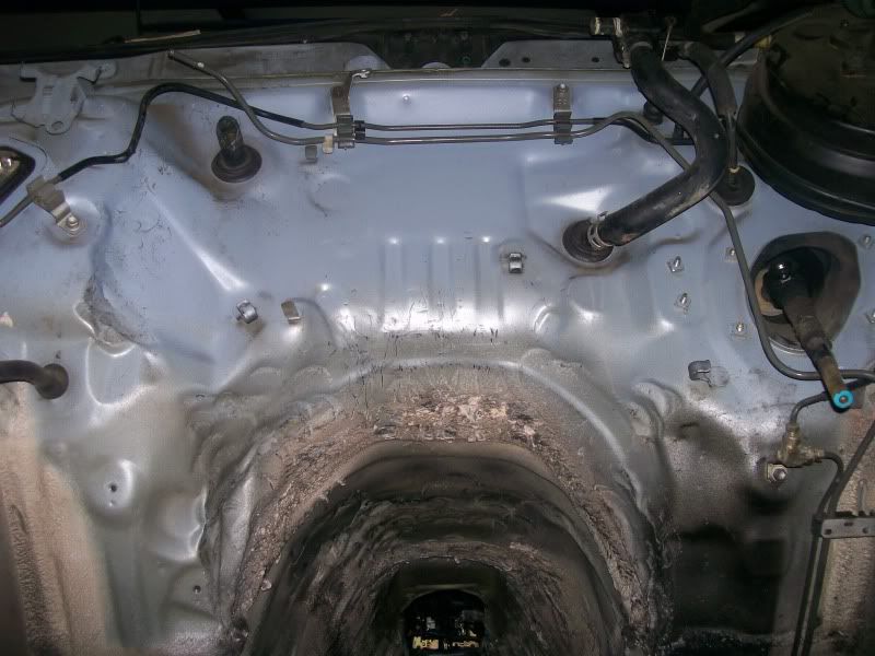

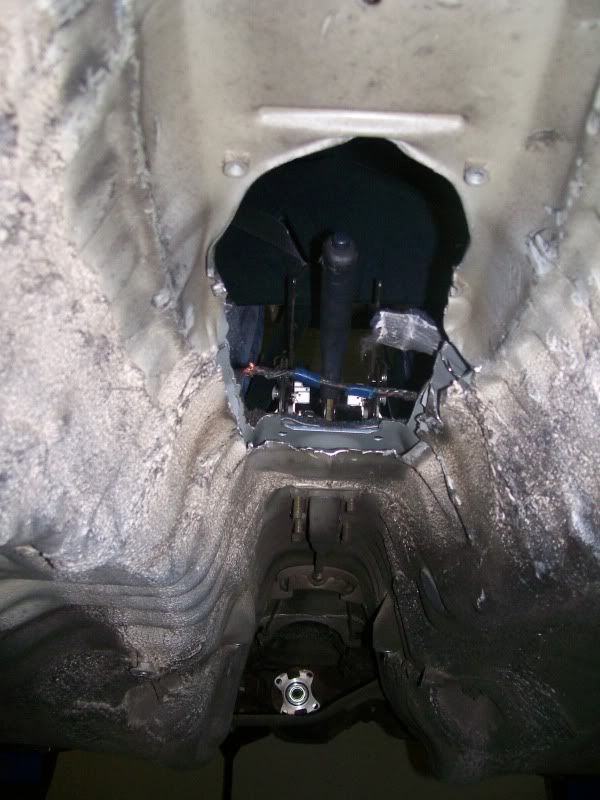

here's a pic of the 240 transmission tunnel.

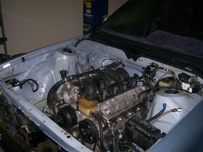

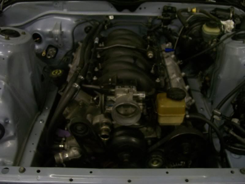

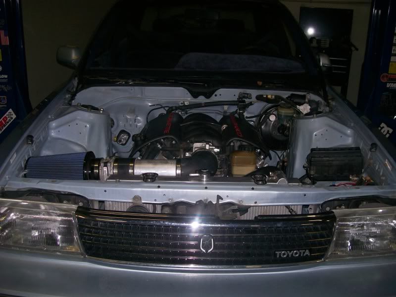

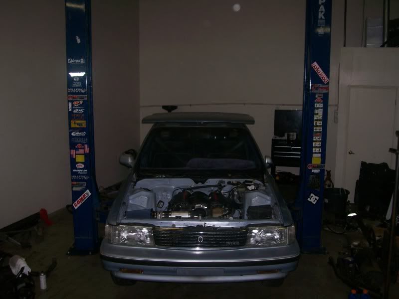

first test fit

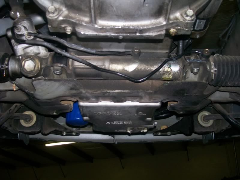

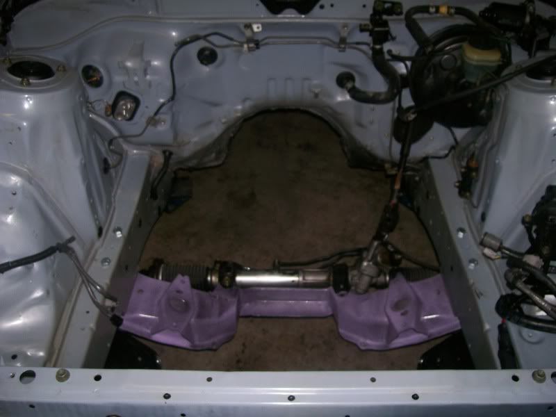

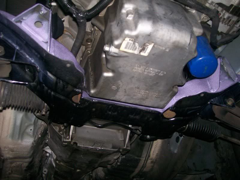

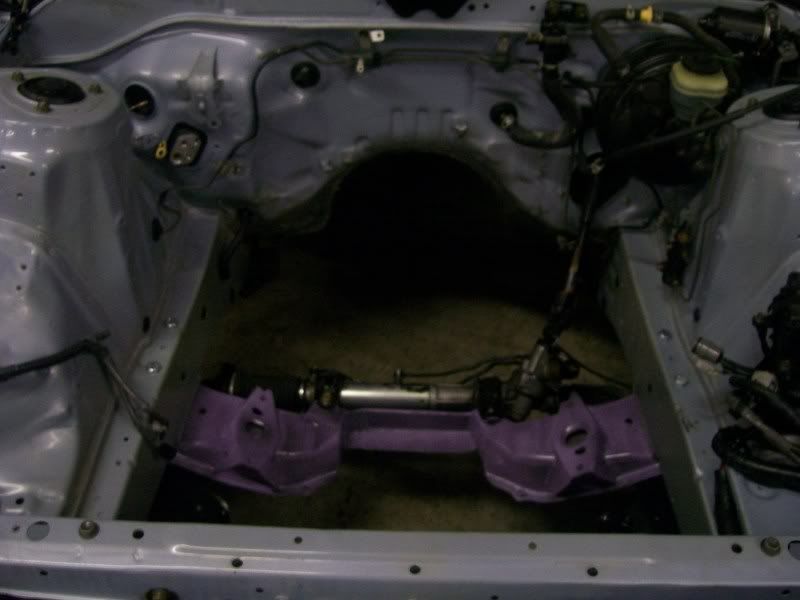

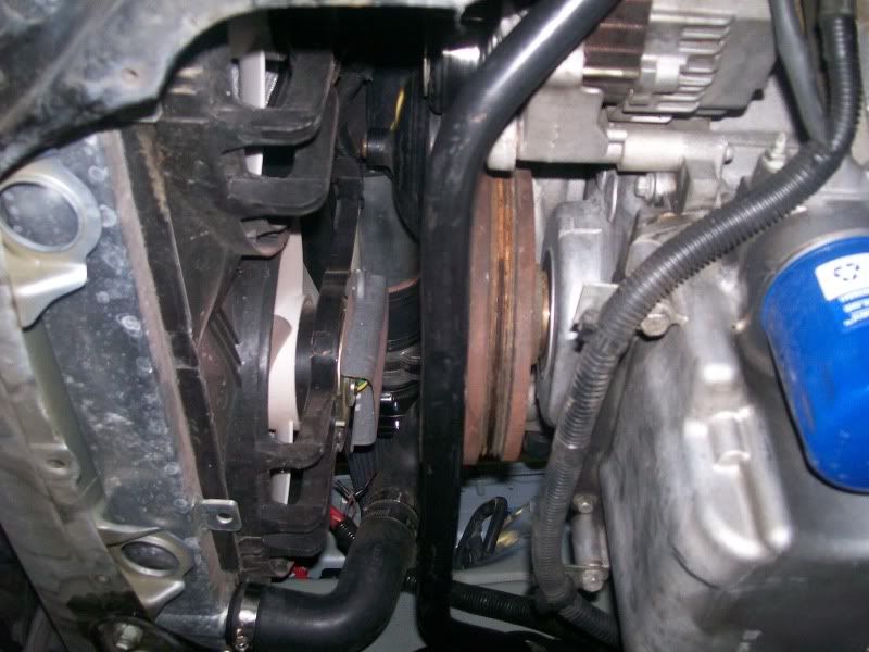

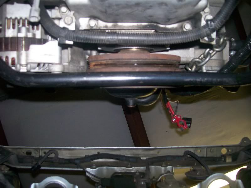

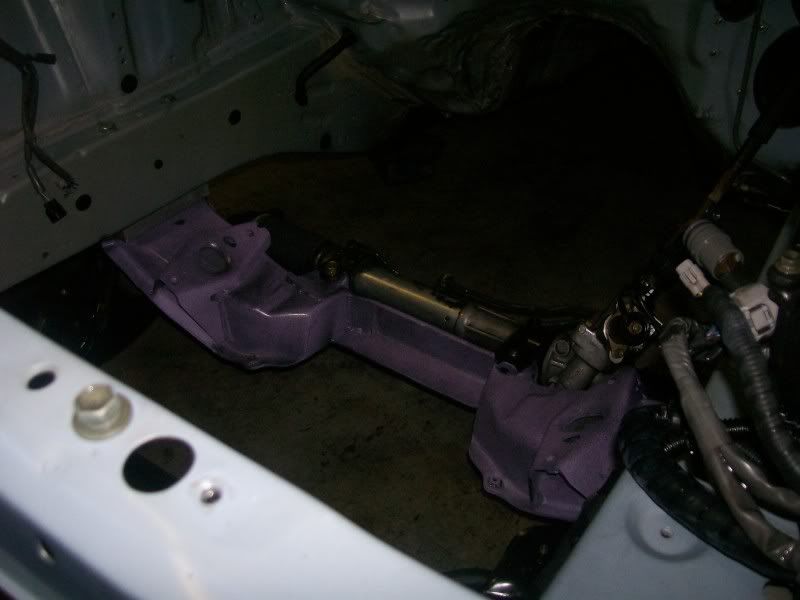

the cressida subframe unaltered

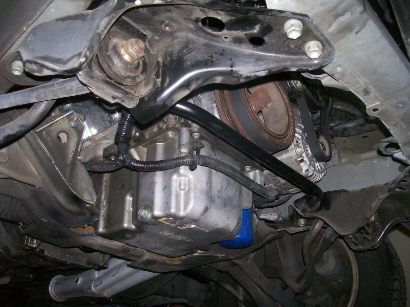

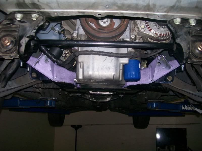

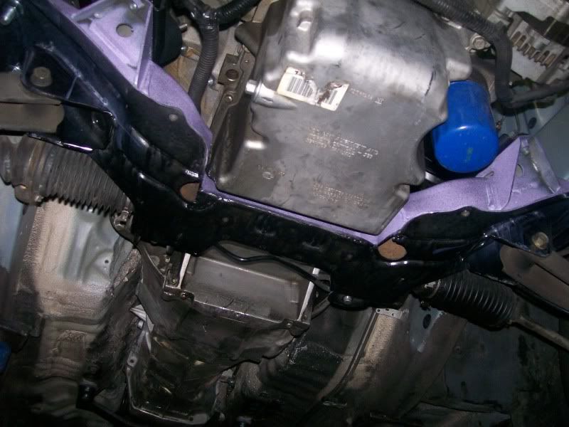

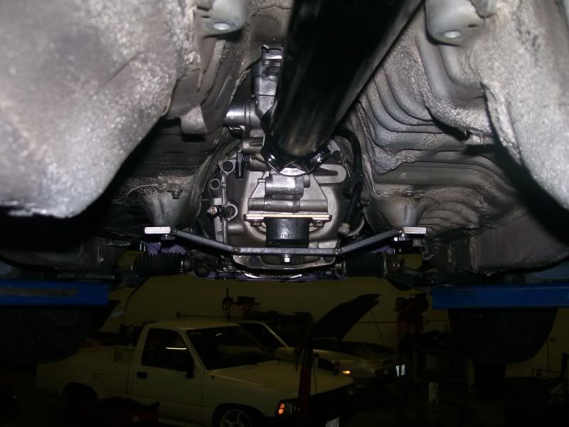

the cross member cut to fit, before bracing and rewelding.
another test fit shot

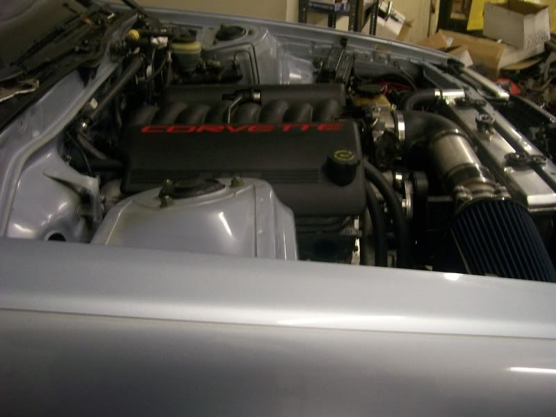

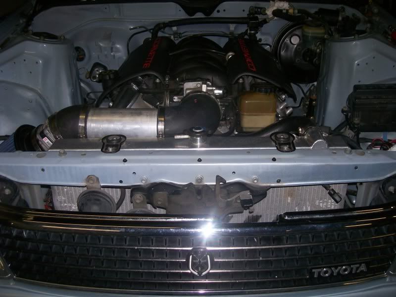

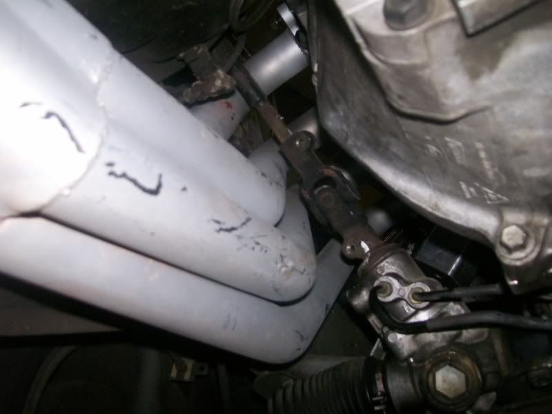

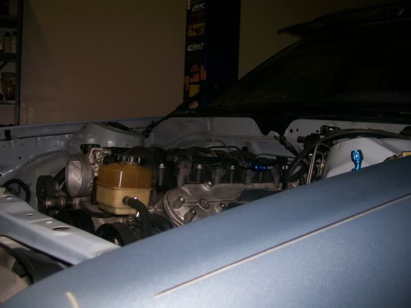

2nd test fit with headers from my friends swap kit for the 240.

I'm wondering how well the cross member is going to hold up with that much cut out of it.
Looks good though.
WhtMa71
D0 W3RK
Apr 24, 2007
1,813
Macon, GA
I would definitely re-brace that crossmember with something that goes under the oil pan that connects it. Looks like it'll fold in half the way it is.
Cool swap nonetheless.

Dannngggg. This car is freakin sweet. It's like an old CTS-V. Lol
Has he done anything to the motor? If he is going to drift please tell him to replace the rod bolts. LS1 rod bolts are made out of a mixture of wood and glass. ARP's are cheap too. I can see it's not a 98 motor so that is a biggggg plus.
