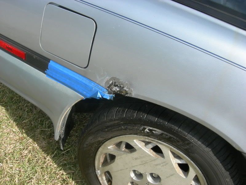

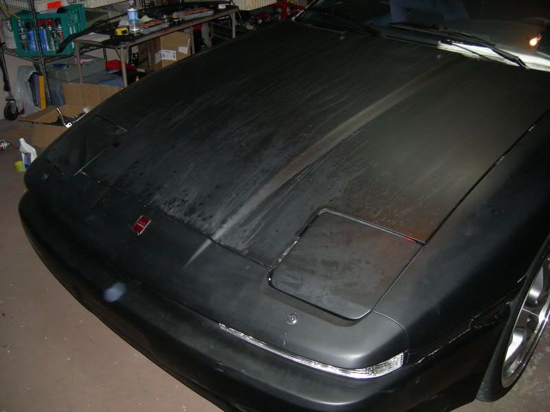

so i got bored and decided to make a new build thread for my car. and seeing that it will be 2 years this month i thought it would be cool to look back on all the progress i have made.

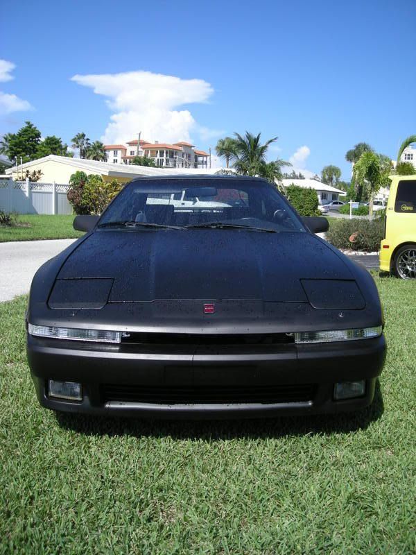

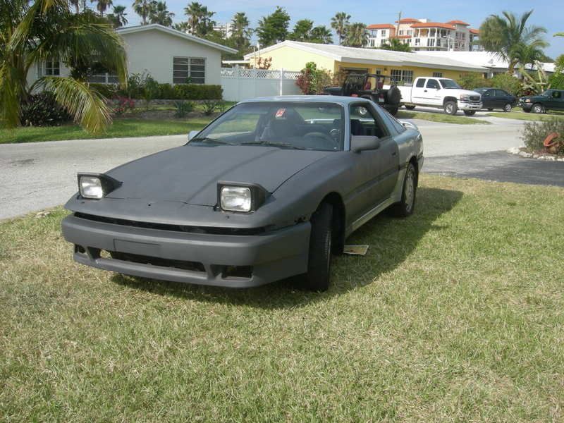

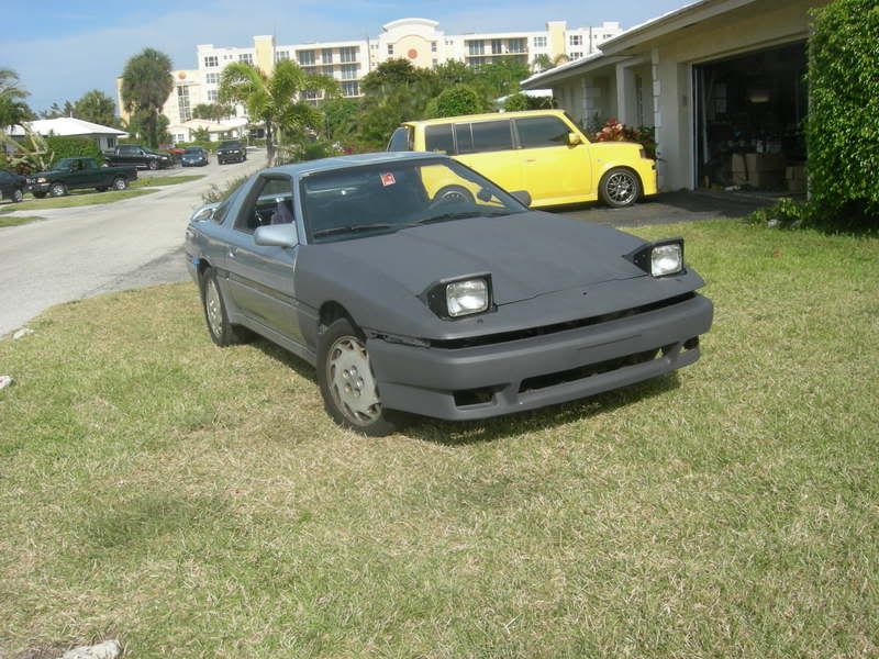

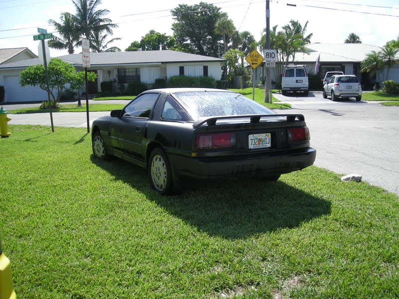

ill start with the day i brought it home, 4/14/07
$1200 and she was mine! of corse it over heated all the way home!

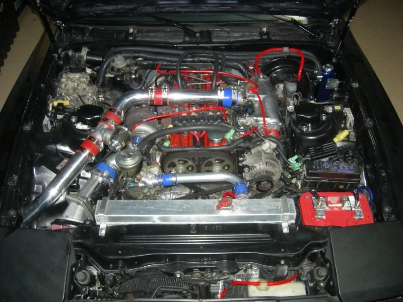

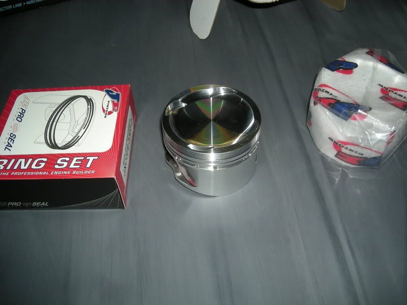

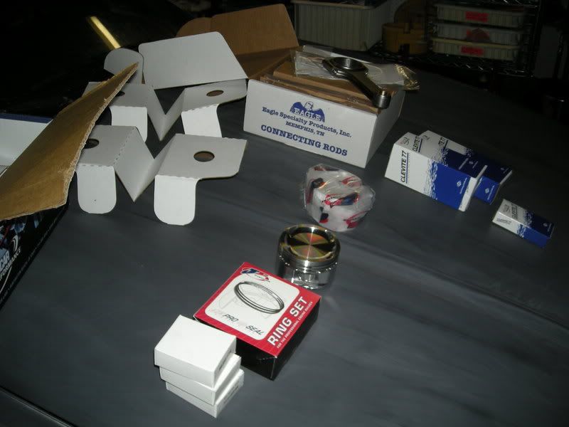

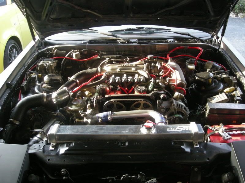

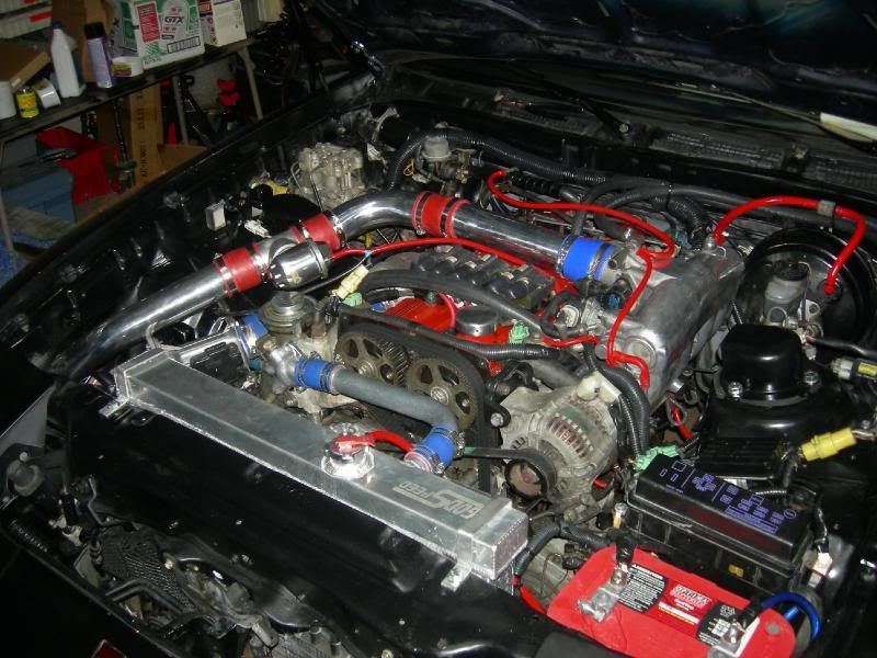

the berth of 7m# 2
specs:
.040 over je pistons
eagle rods
titan 1.4mm mhg
arp head bolts
re worked head
decked block
stock turbo @ 10-12psi
stock fuel
apexi intake
3" elbow and DP
flowmaster super 44
aluminum rad.
cooleze upper rad. pipe and intake pipe
hks bov
etc...

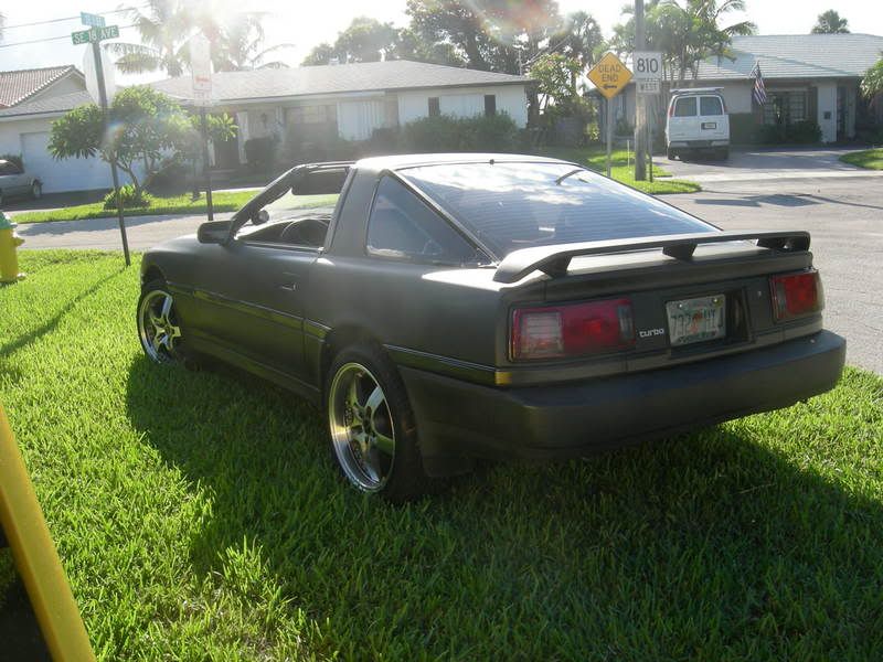

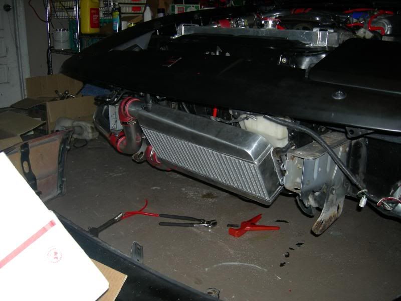

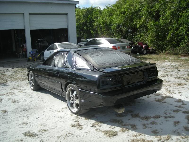

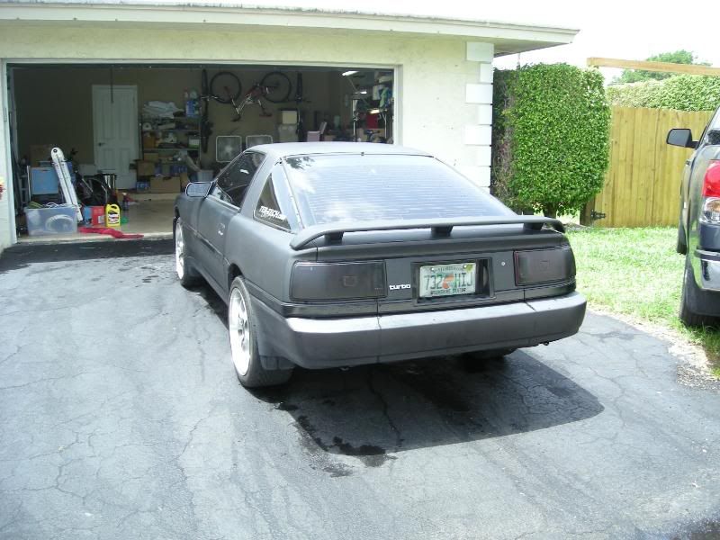

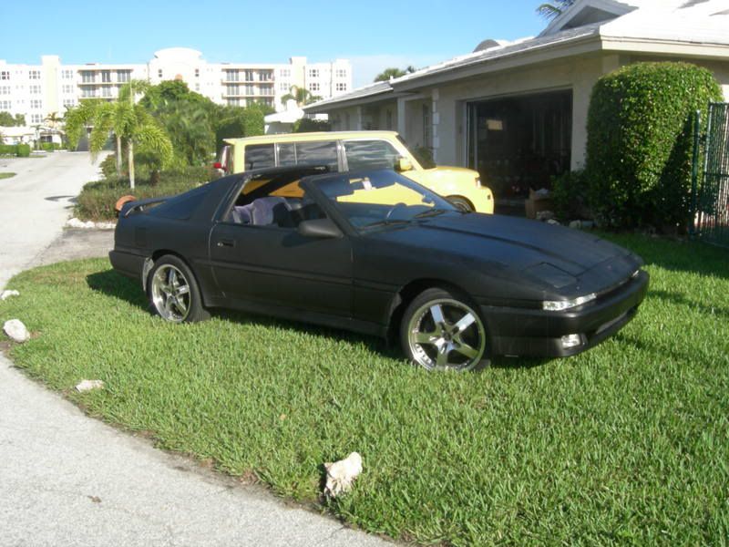

side mount IC and some aluminum piping,

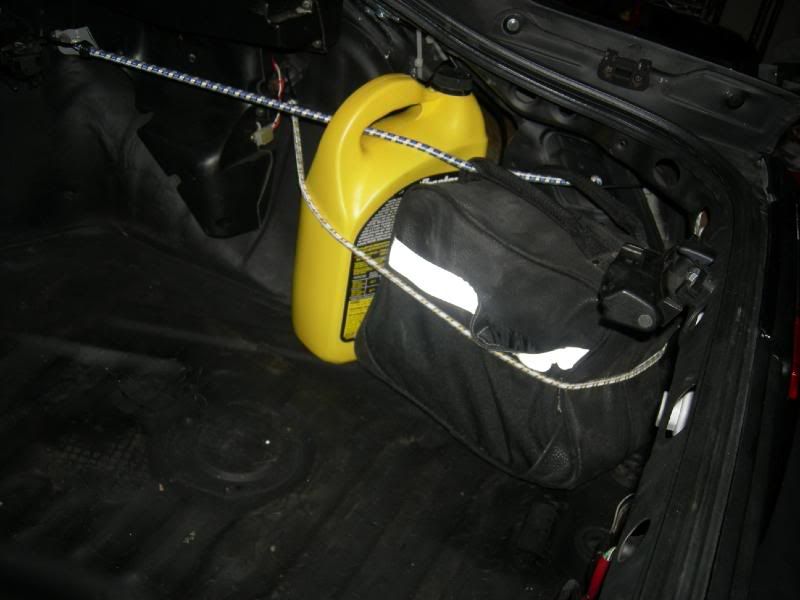

the 7m roadside assistance kit lol,

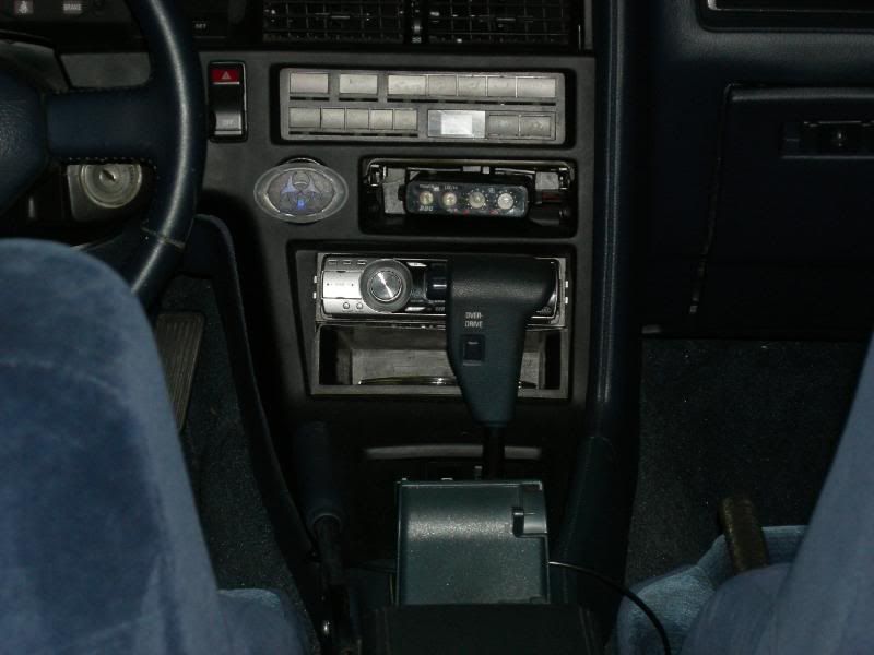

new pioneer head-unit and a electronic 2 stage boost controller,

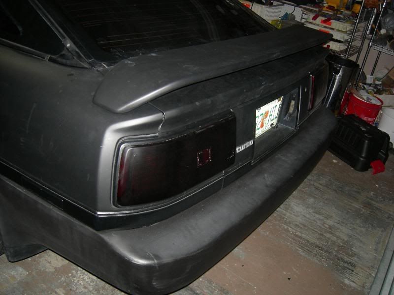

blacked out tail lights and finally a complete set of moldings,
just some shots after a wash,

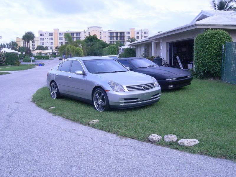

he sup with my friends old G35 sedan ( he now drives a 5 speed is300)

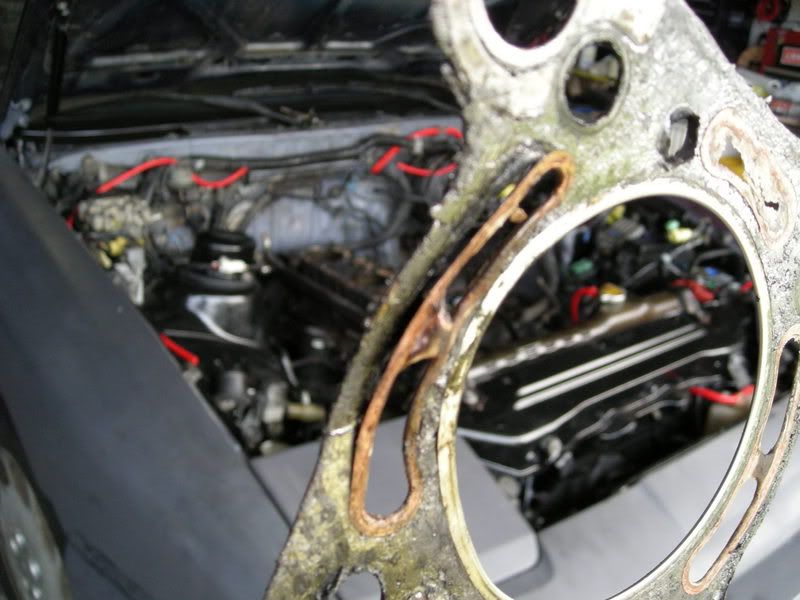

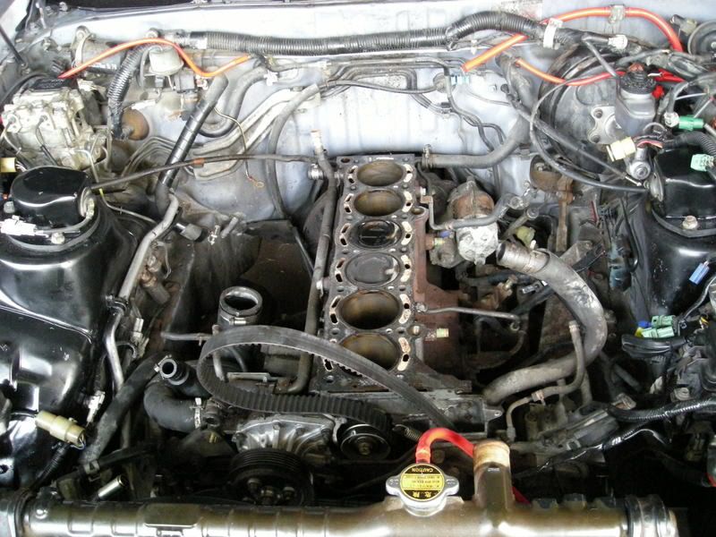

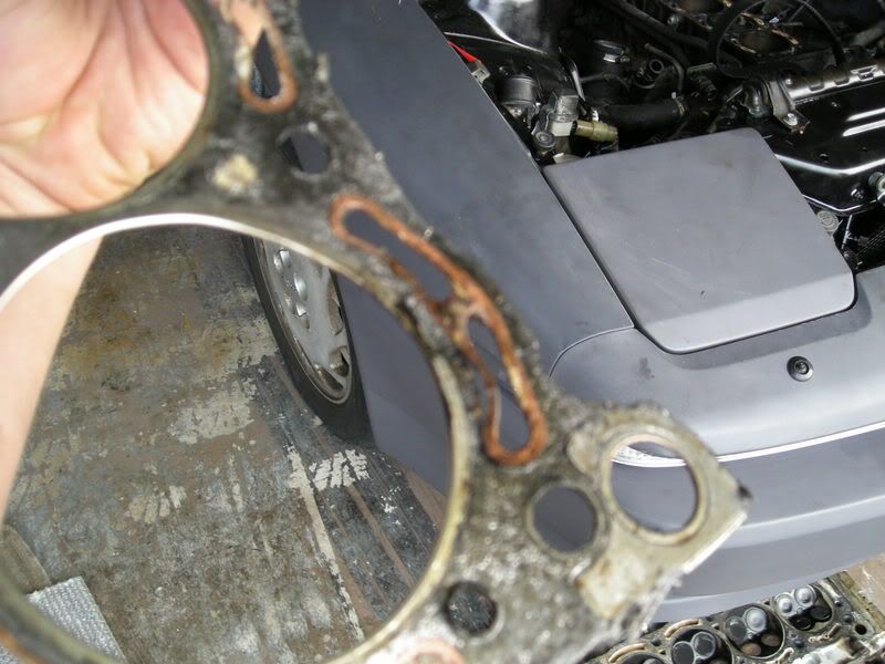

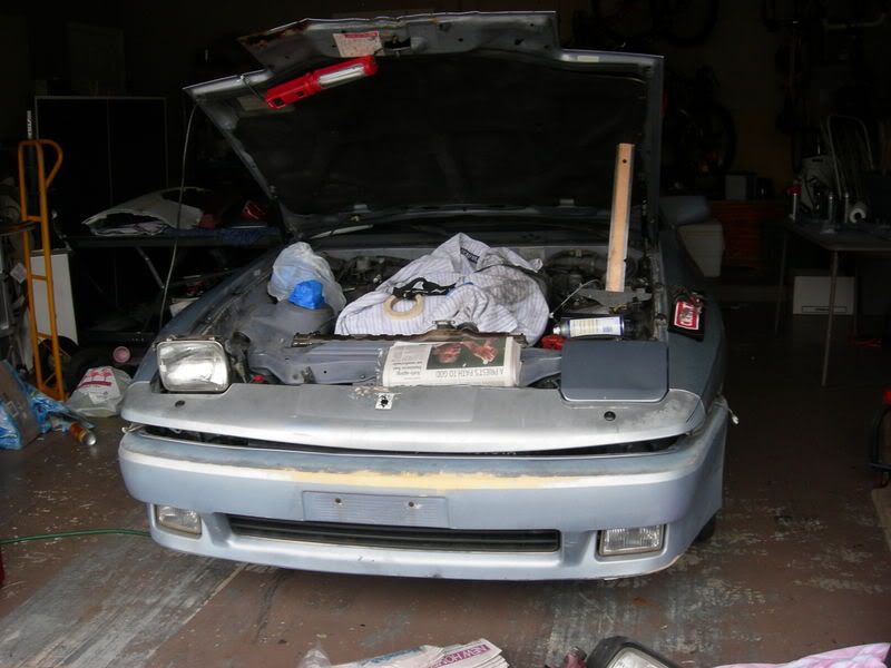

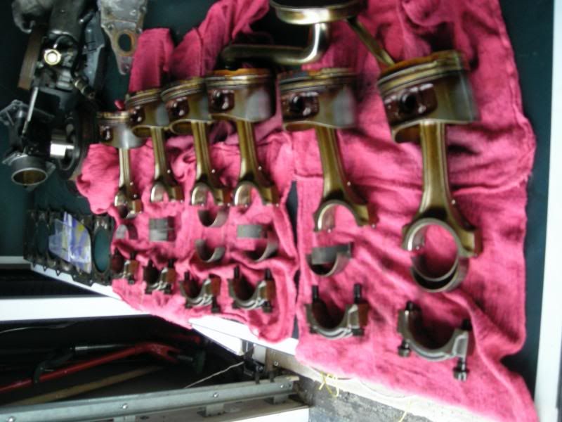

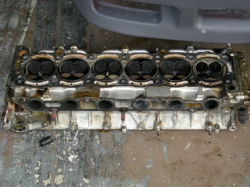

death of the 2nd 7m-
it was a long time coming, the car never ran right always over heated, massive blow by, fouled out lugs... etc... this was due to a horrible dishonest mechanic. lesson learned, i do all my mechanical work now.
video of the old 7m runnin houres before we tore into it,
awaiting the heart transplant!

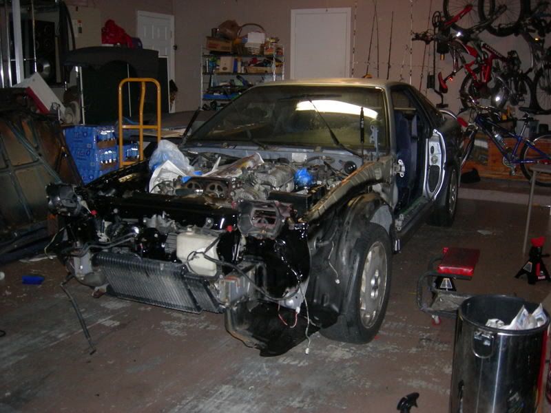

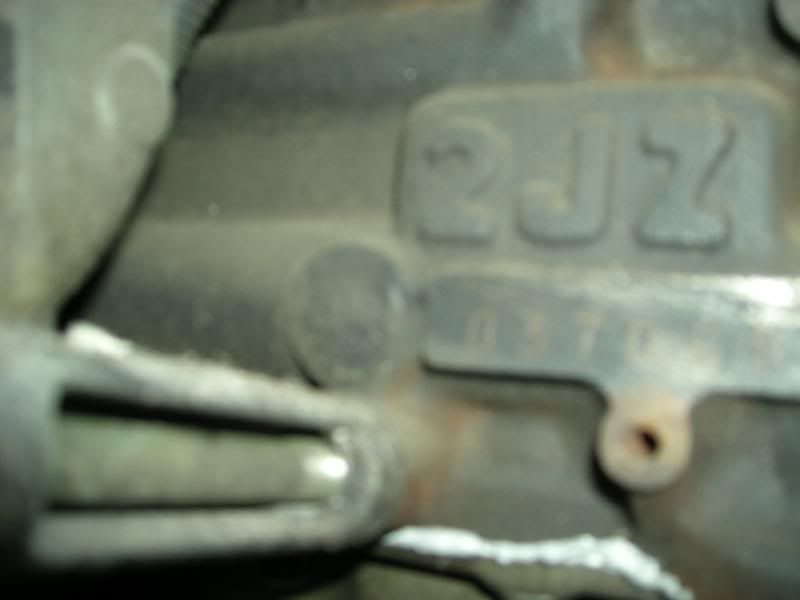

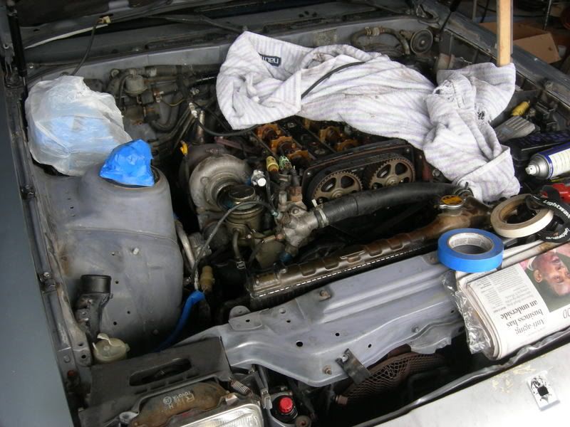

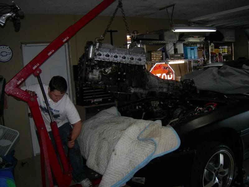

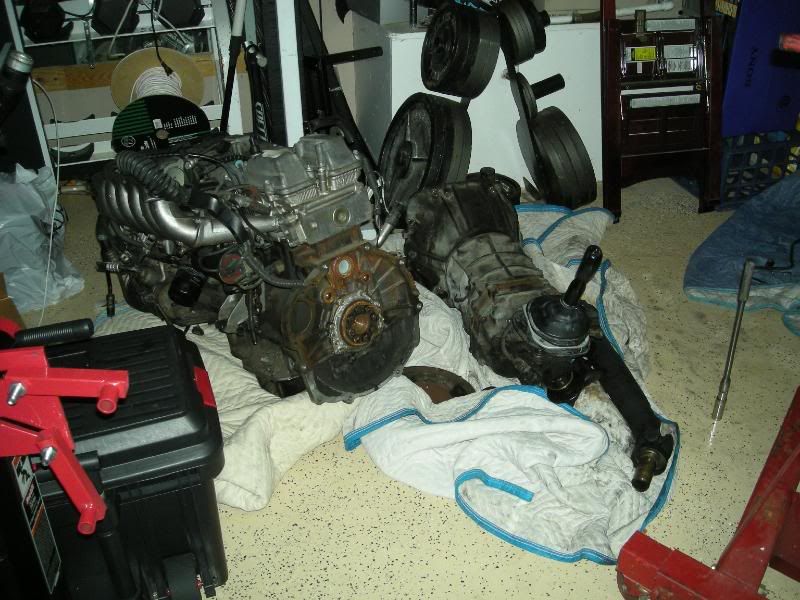

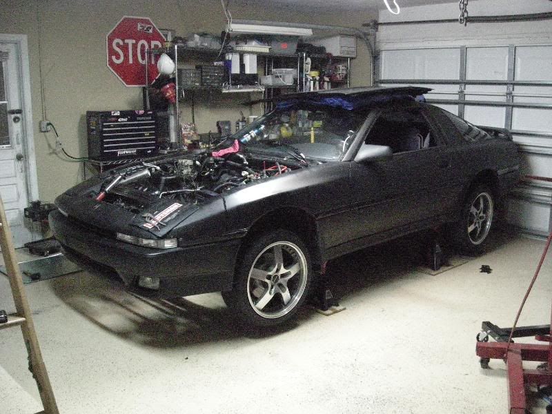

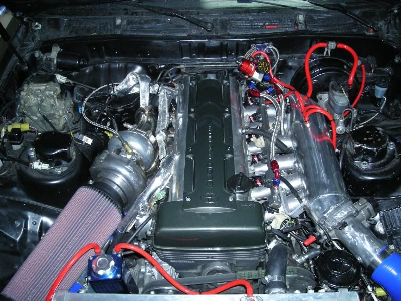

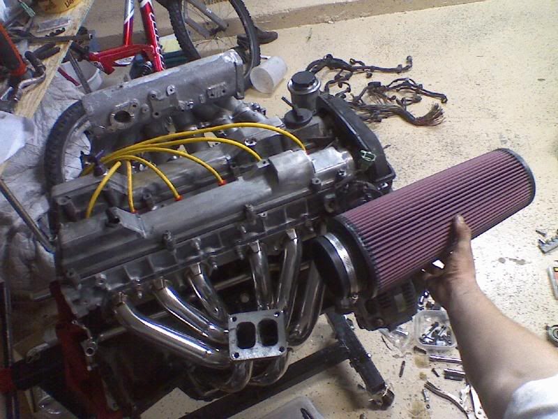

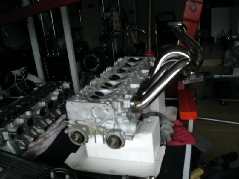

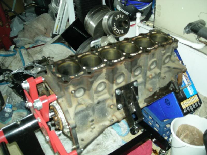

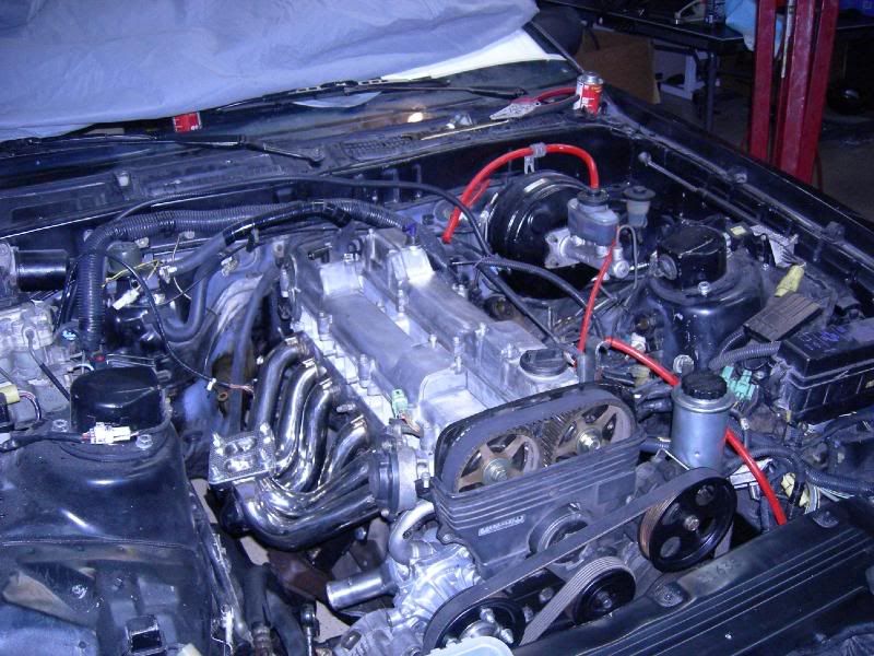

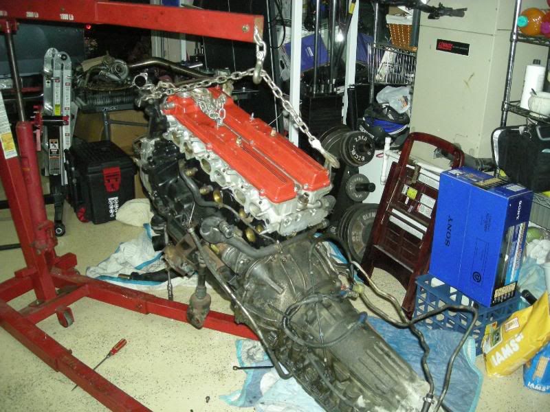

2jz swop
i decided to go 2jz na-t on 7m electronics for a few reassons,
-to be unique (a lot of people can build a 7m or swop in a 1j or 2j. but only a few have done the na 2j on 7m electronics!)
-you can get a non turbo 2j for CHEEP
-its a 2j.

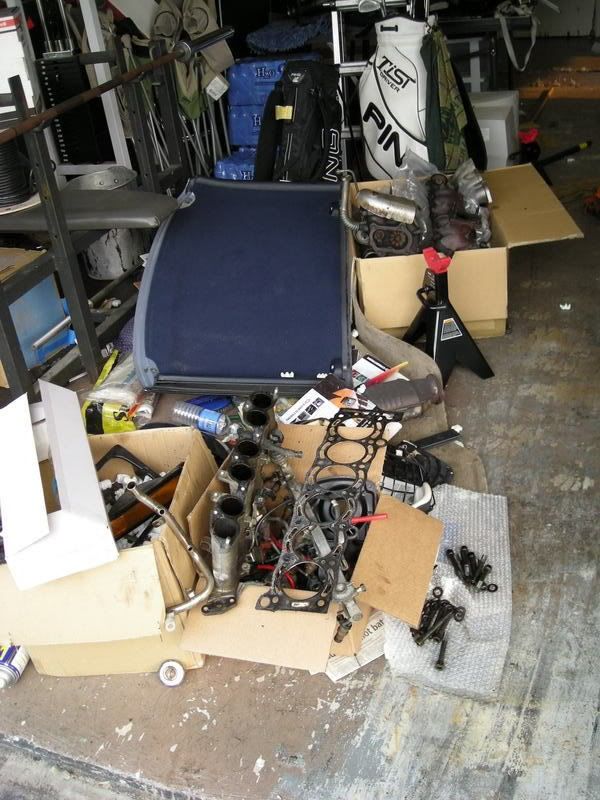

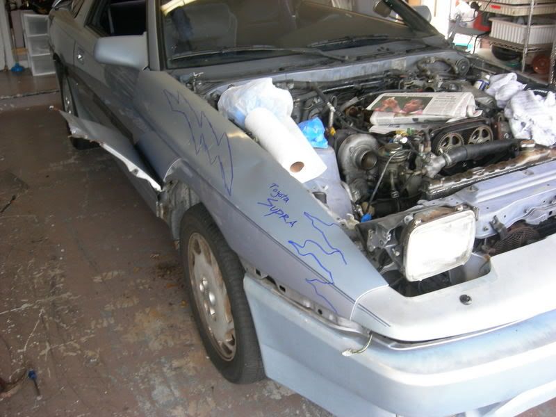

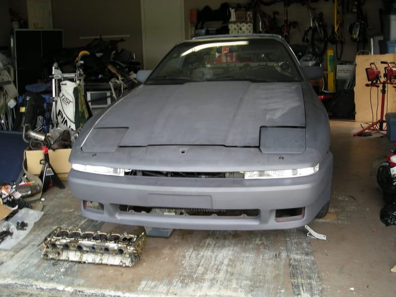

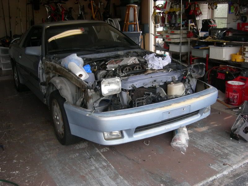

2jz and r154 upon arrival at the garage

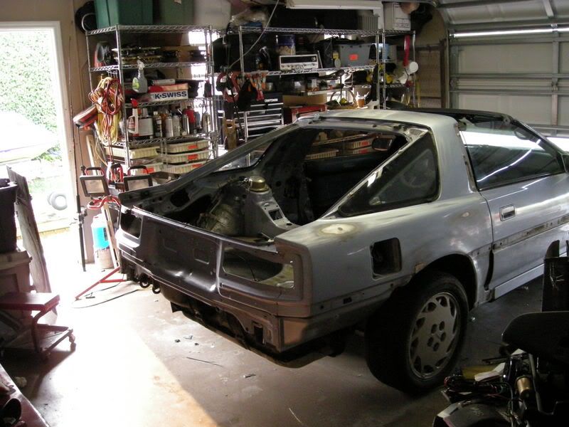

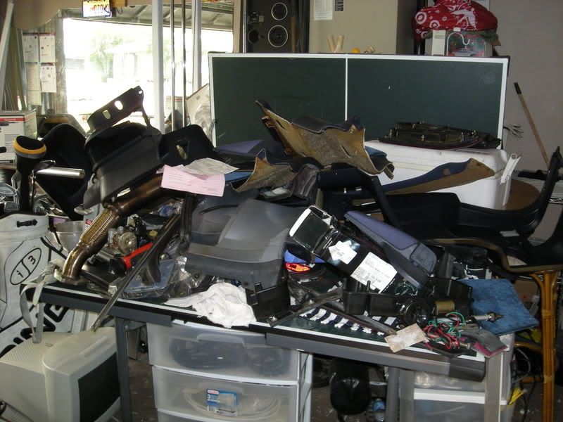

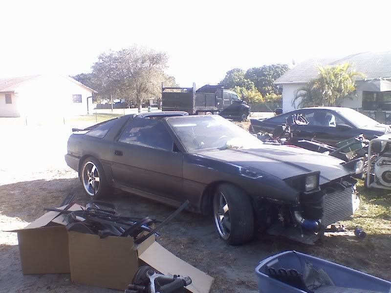

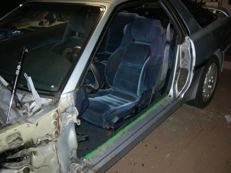

parting out the 7m
2jz!!!
still waiting
breaking down the 7m

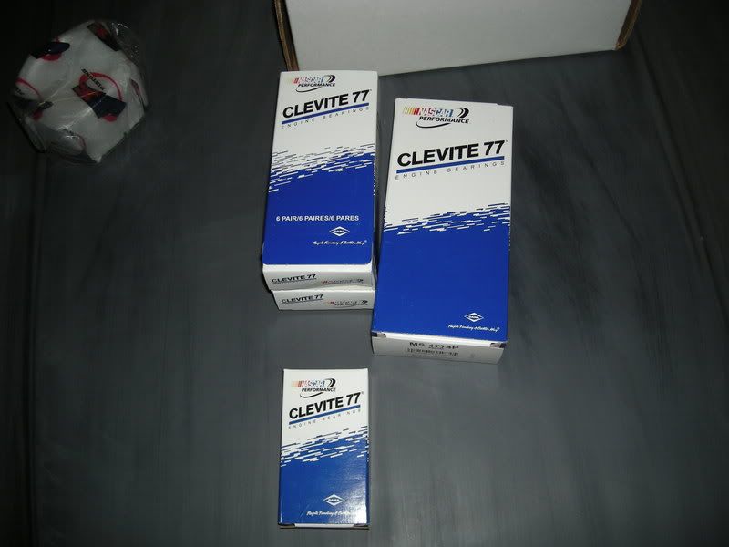

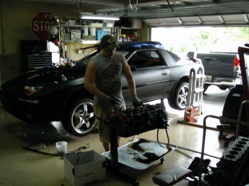

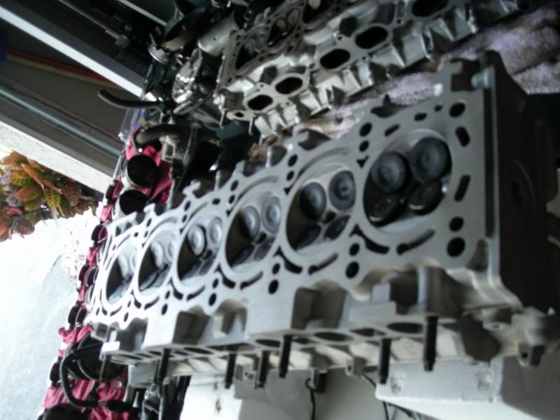

2jz internals about to get some new rings & bearings
we have a clutch pedal!

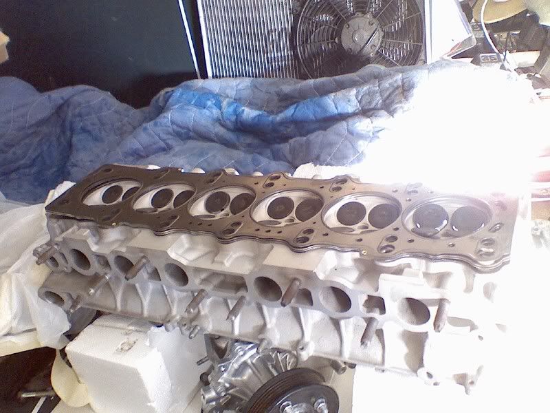

rebuilt 2j head
stripped down bottom end with 1jz mounts

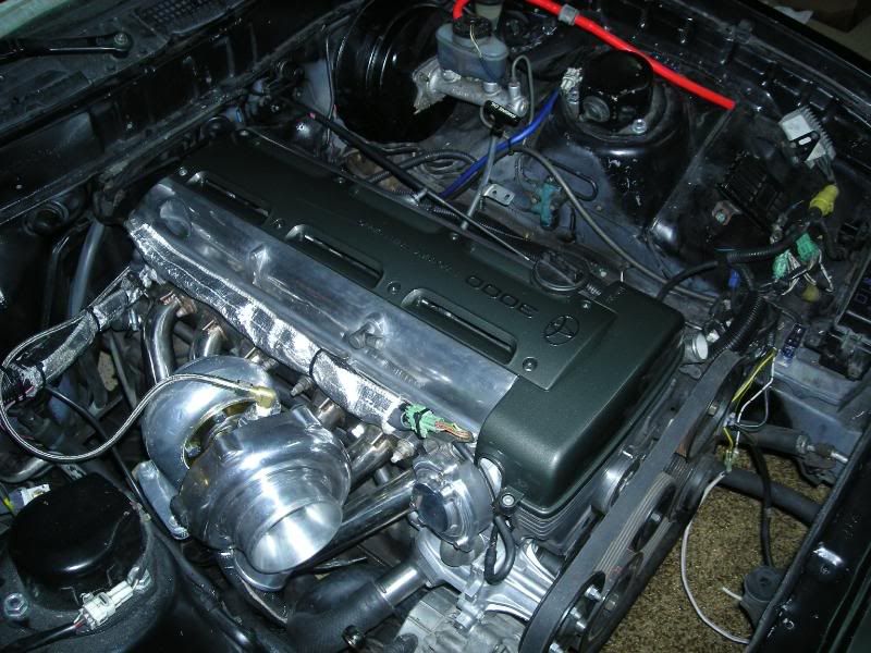

ebay manifold!
cometic 2.0mm hg

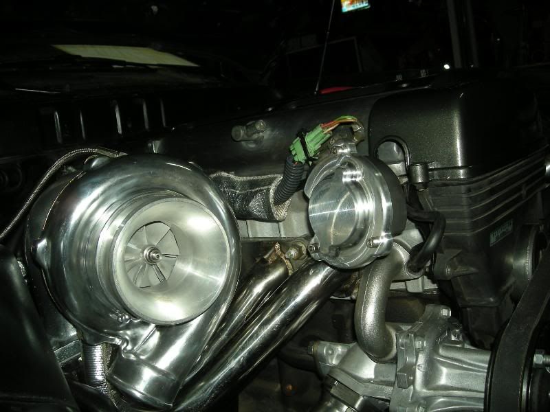

no money for the turbo yet )=

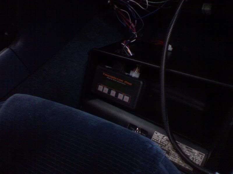

MAF-T Pro!

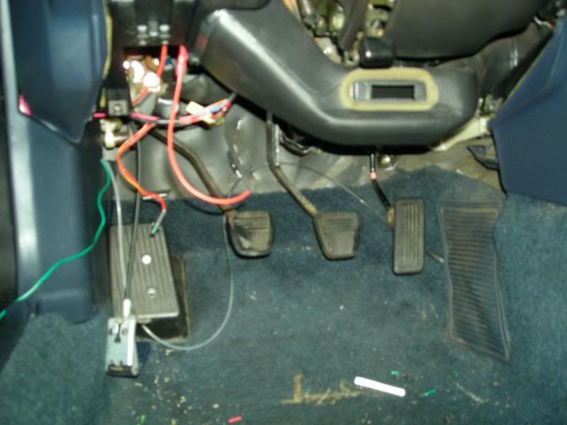

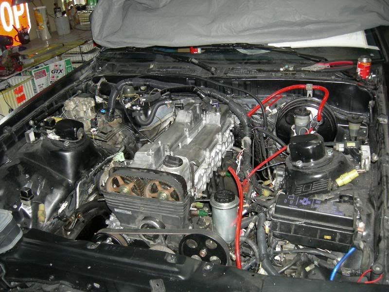

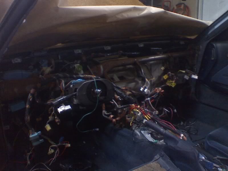

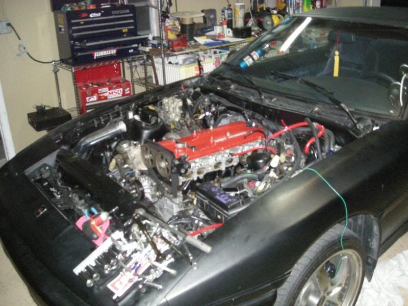

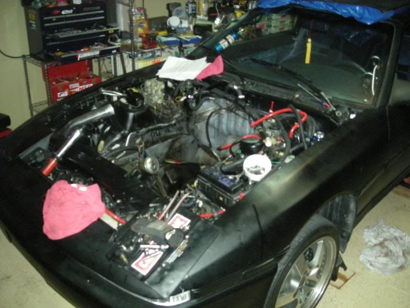

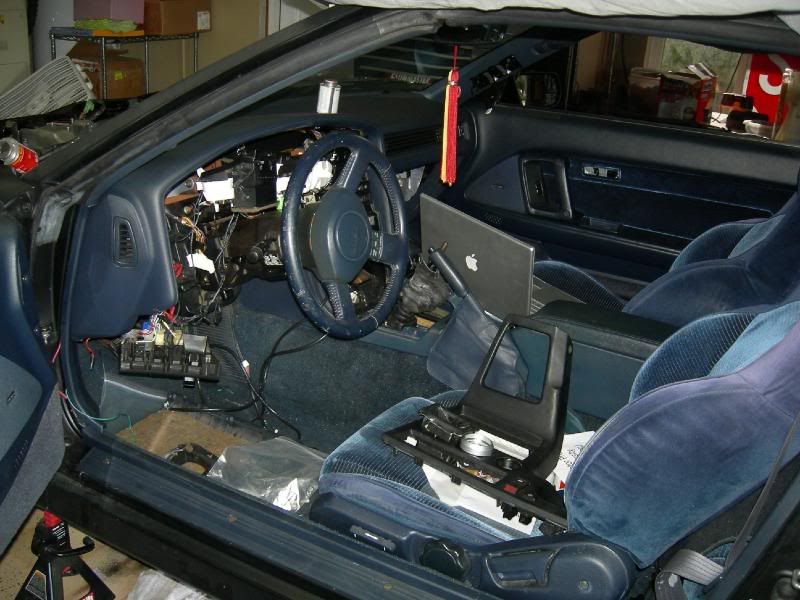

its in! (thats what he said)
doing some wiring (probably on the maft pro)

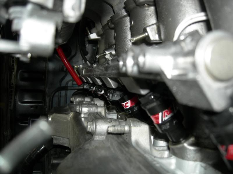

fuel pump switch and wide-band
rc 550's (originally ment for the 7m...)

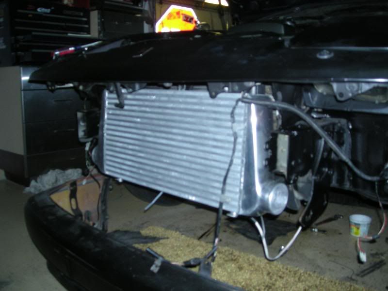

bigger FMIC
driftmotion 60-1 and some new gte style valve-covers
custom ffim

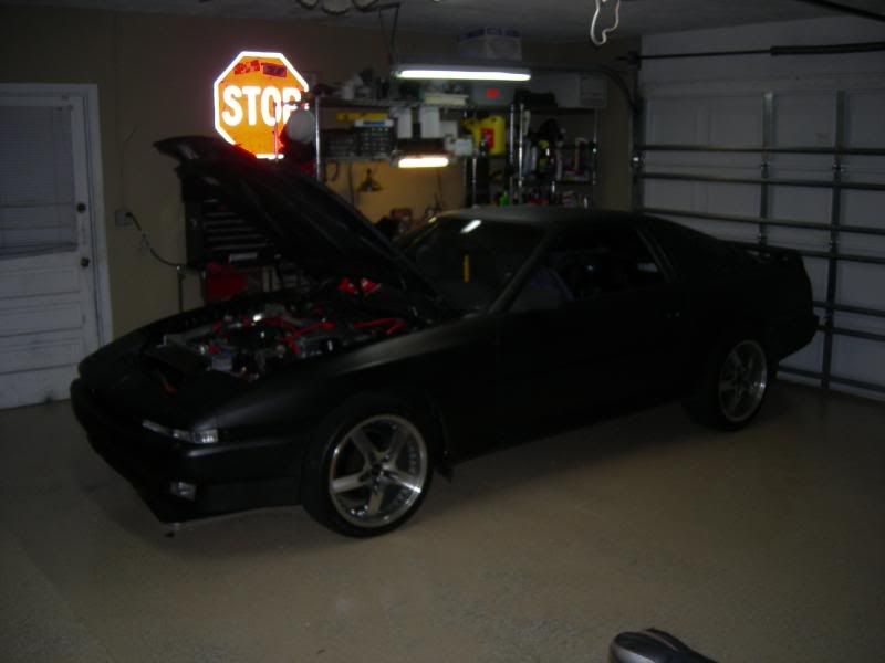

first time out of the garage in 6 months!

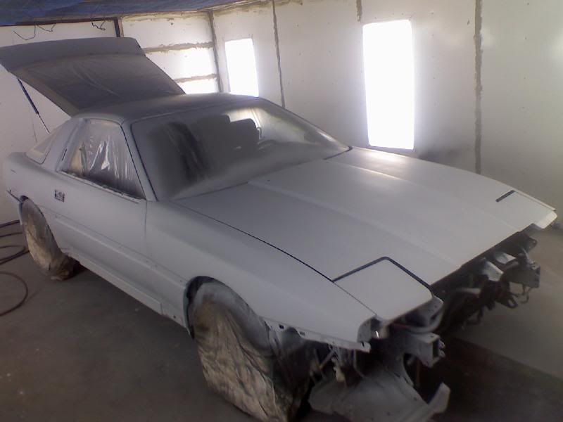

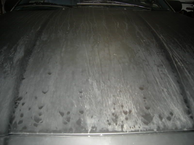

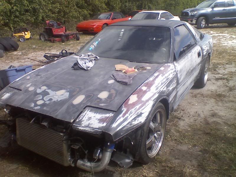

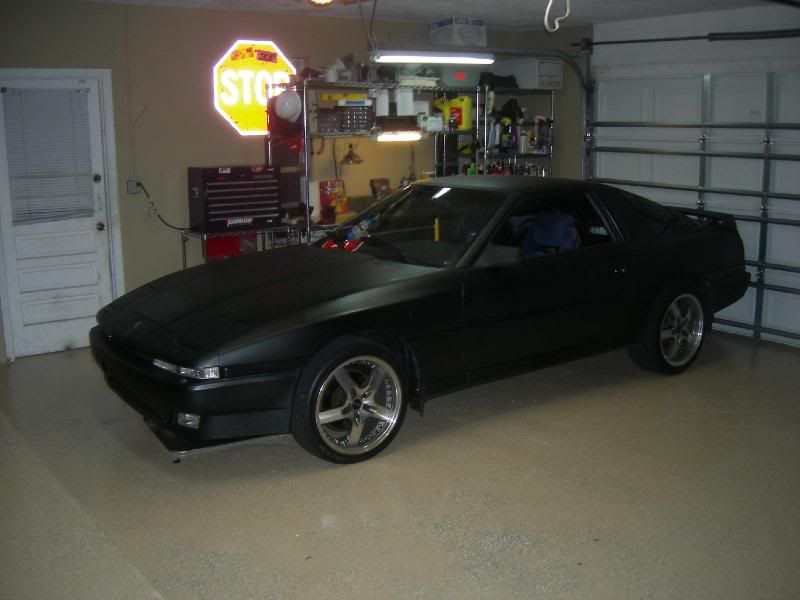

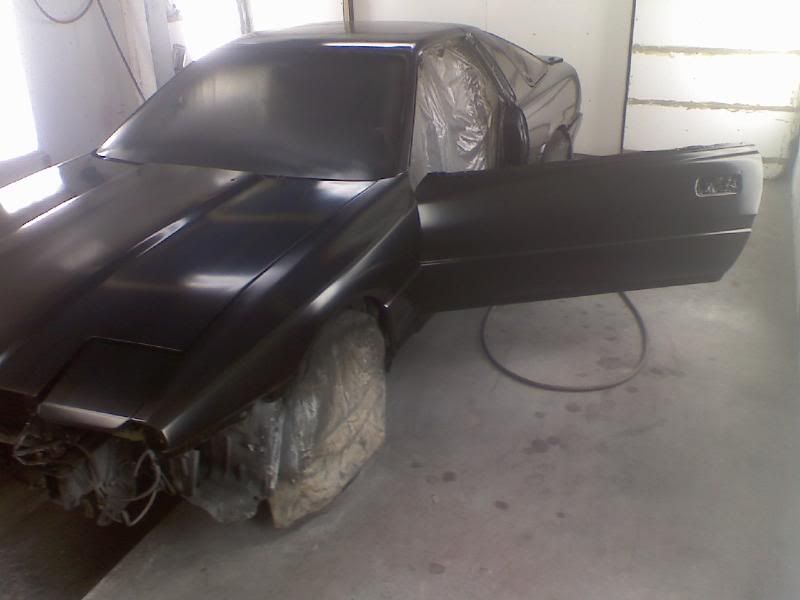

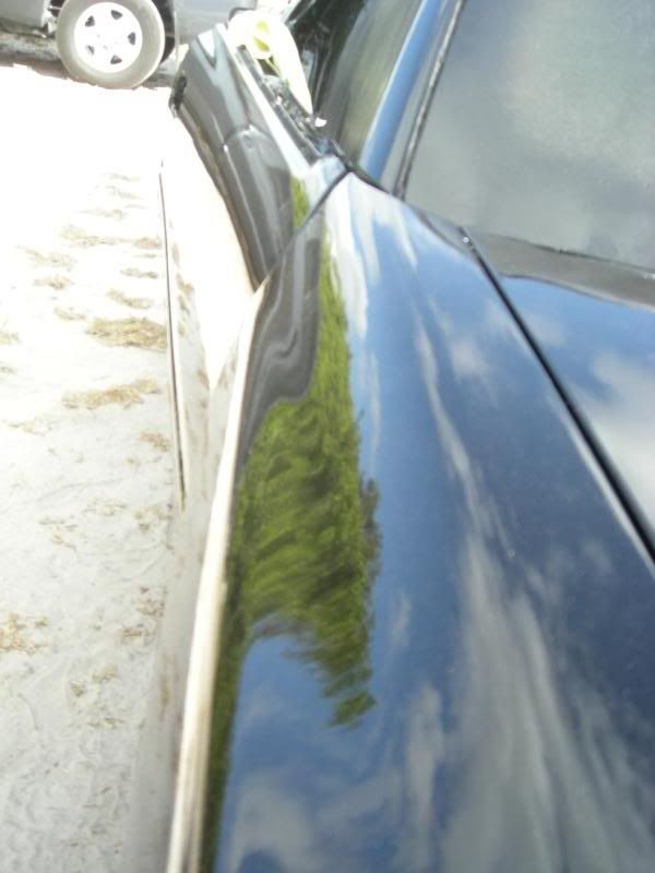

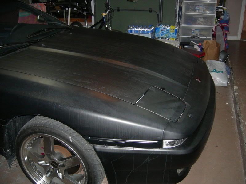

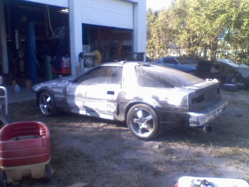

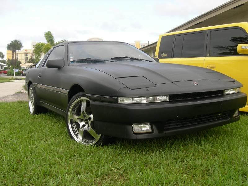

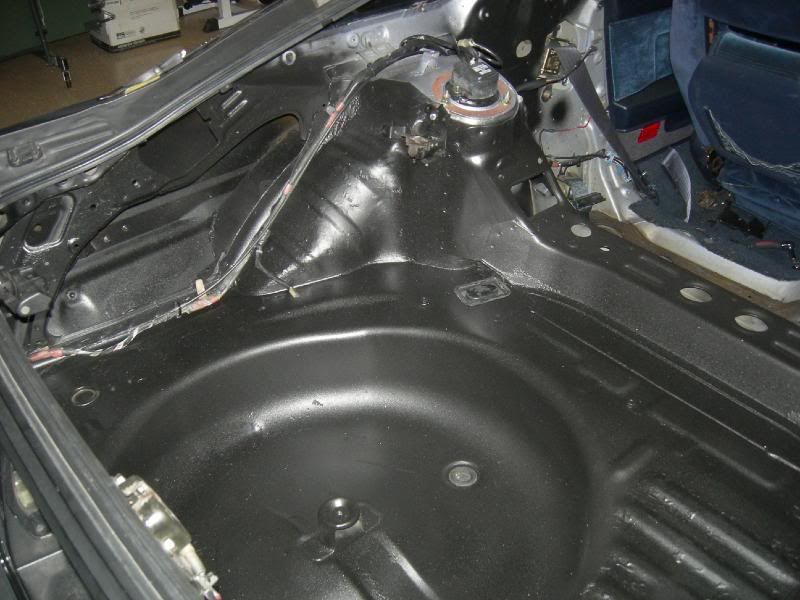

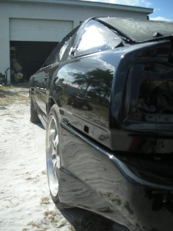

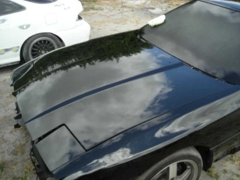

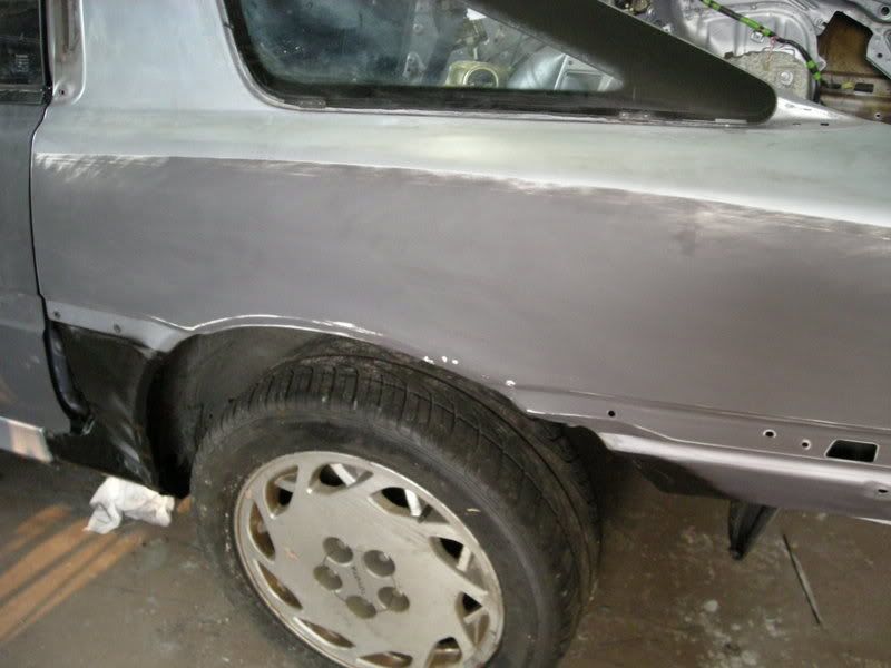

now to the body work and a real paint job!
some primer,
1st coat of dupont croma-base
after a few days of drying, (dupont croma_base and dupont high image clear)
this is straight out of the booth no polishing or wet sanding.

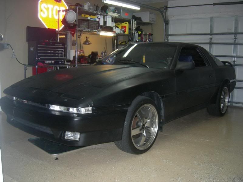

so thats all i have for now the car should be assembled and back with me by the end of next week. but looking back on all this brings back some good memories! i loved every minute of working on my car! and will continue to!

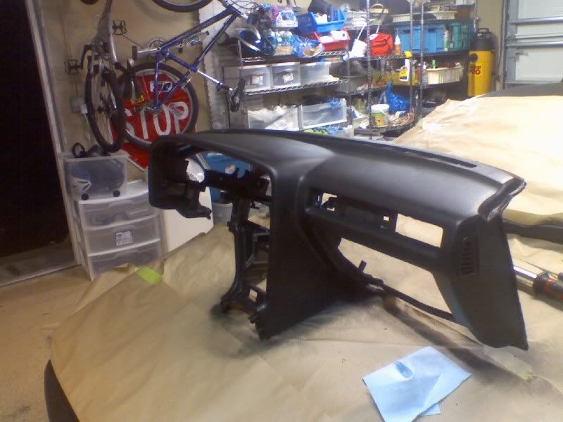

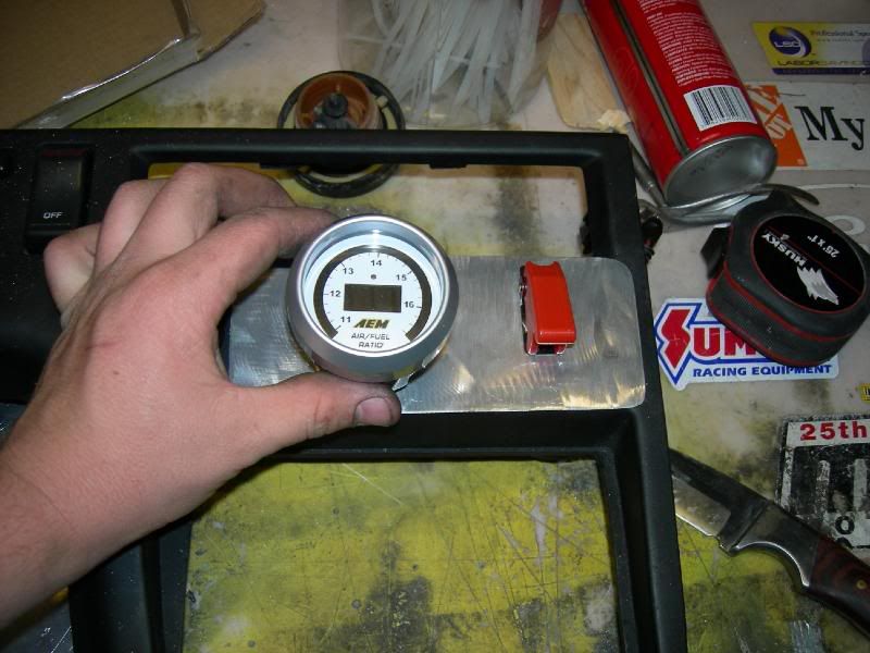

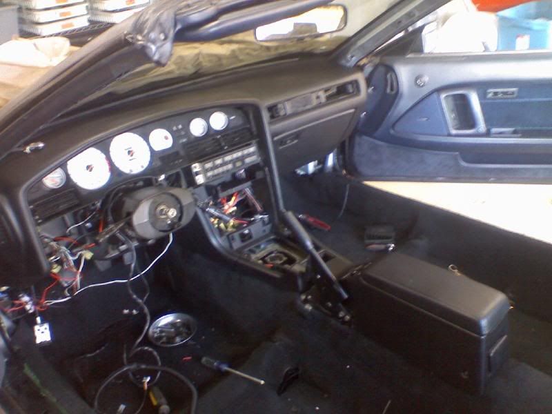

thanks guys! i have a lot more to do when i get her back next week,

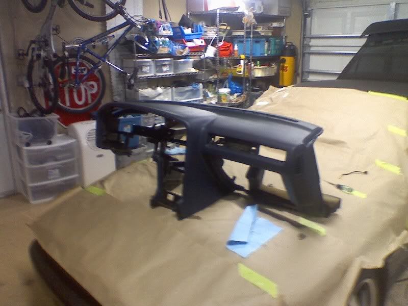

finish the interior
-finish the color change
-custom switch panel where the TEMS used to be, 3 switches- fuel, fans, and engine start

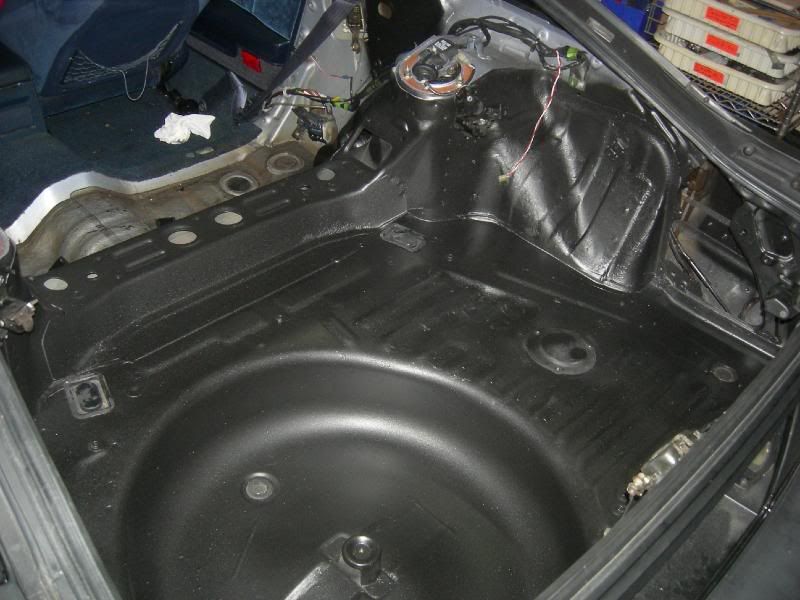

-custom rear trunk floor w/ new carpet
-new floor mats from the GB
-install all my A1 rear suspension components
-install wheel spacers
-install new momo gothem shift knob
-install new pro sport gauges and A pillar gauge pod
-install new steering wheel
-install new aluminum battery box and circuit breaker
