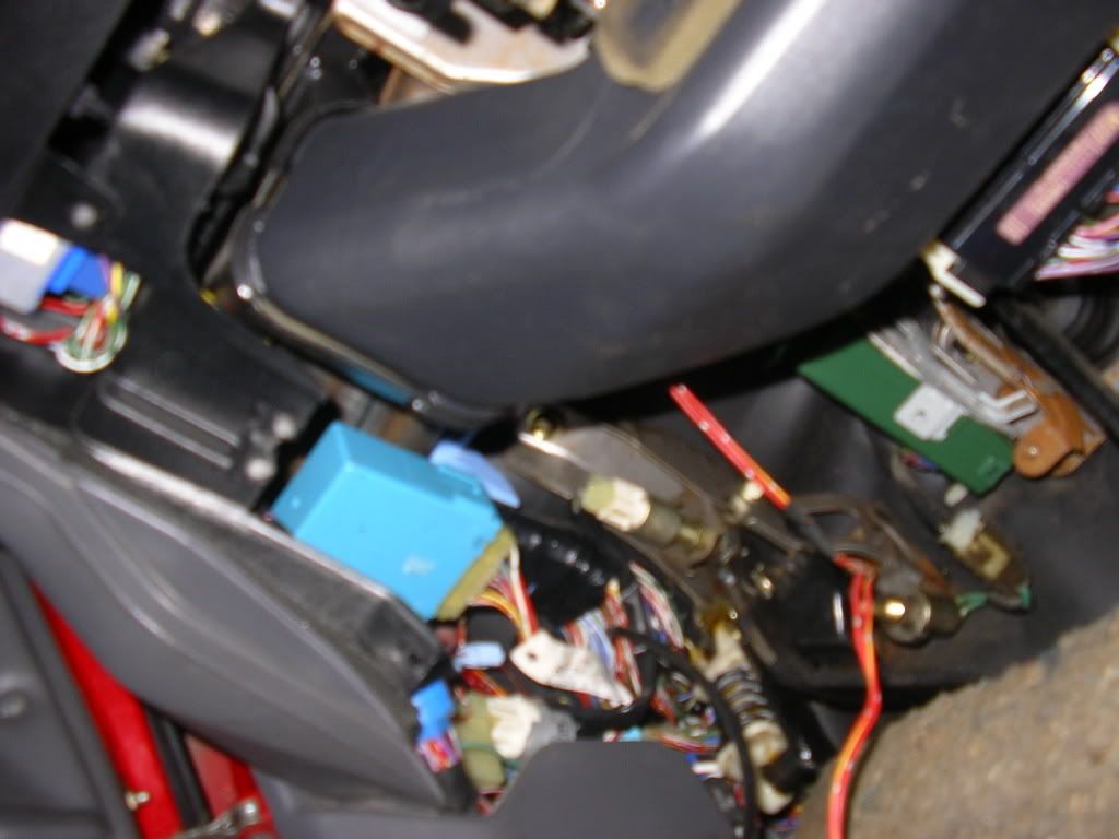

retractor control relay under dash, it's a blue box the size of a deck of cards...

Blue box, can't miss it (it slides off the bracket pretty easily as well). It's under the driver's side dash if you can't figure out where the pic was taken.

oh hell honestly thought it would be bigger looks about the same of most relays lol sorry blue box made it sound much bigger and I honestly hadnt even went looking for it yet. Thanks will check that this week and luckily I should still have one of those in the blue parts car the roomie has.

alright went out to the parts car today and grabbed the only blue box that was even on the harness. Interesting size for a relay. Its labeled Retractor relay. Looks it has to be it. So will try to go out and swap this out real quick and see if it helps.
