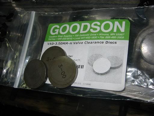

As I mentioned in another thread, Goodson.com has good prices(maybe the best) on 4-packs of 25mm shims. I just put a bunch in tonight, and will be posting a pic of the shims and the head( since it's finally frikken done!).
The nice thing about the Goodson shims, is that they have the size printed on one side in metric.
PS- you want I believe .15-.25mm gap on intake, and .20-.30mm on exhaust IIRC.

Atlanta
As promised, here's a pic of my Goodson shims:
