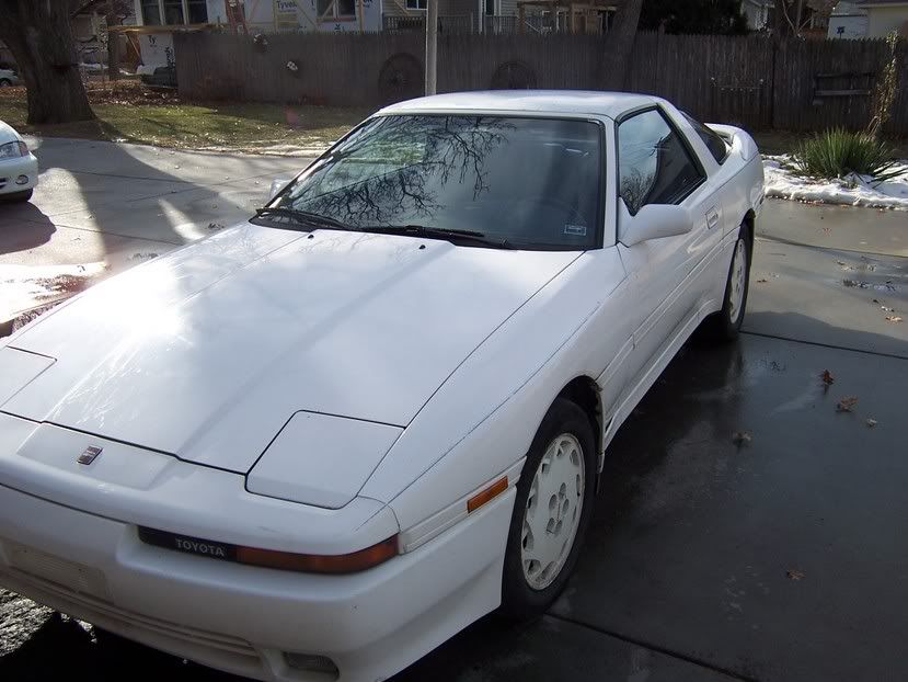

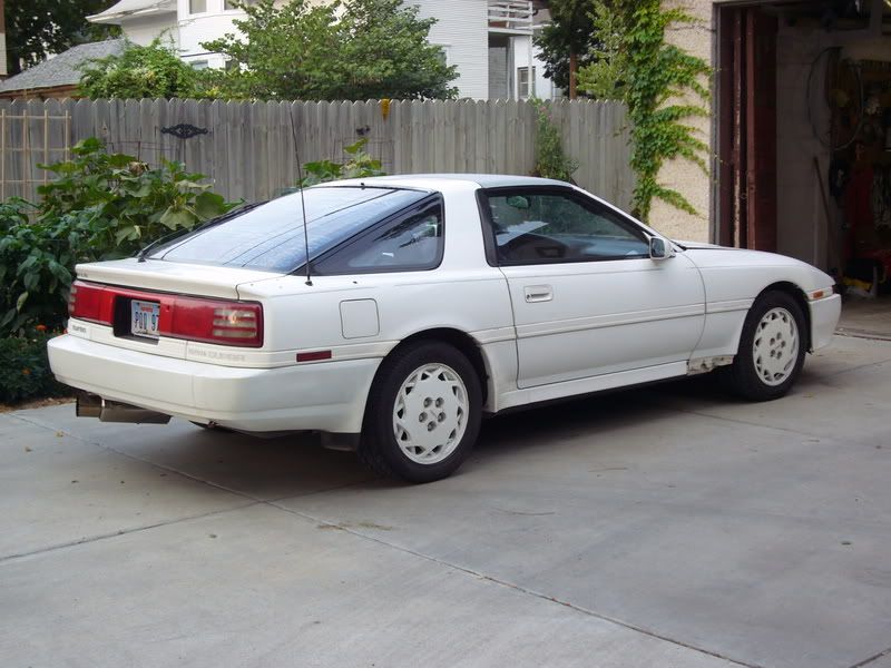

ok...bought it back in high school with a blown headgasket no big deal, shipped here from st louis recevied it on dec 22 2005.

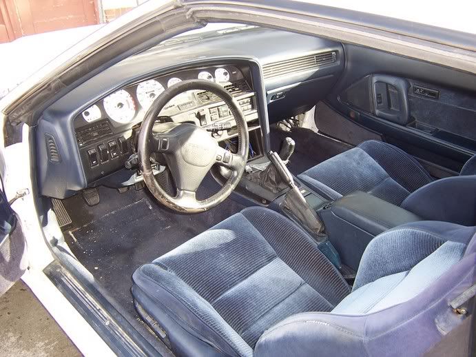

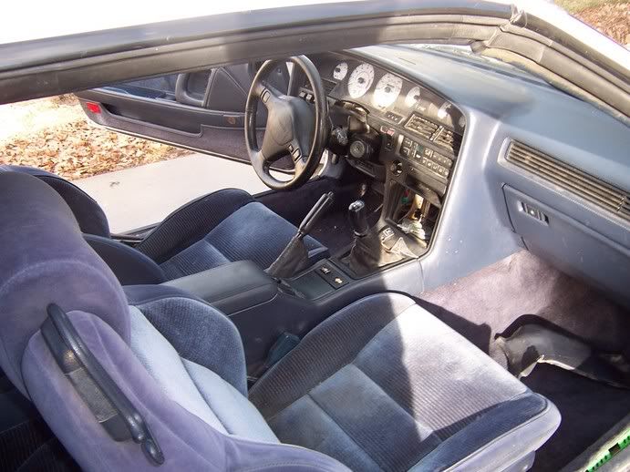

here of some pics when the snow started clear

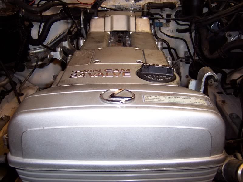

then i started to drive it...granted it was my first cluctch so the next thing that went was the clutch; so cool gave me a exusse to tell my parents to tear the car apart agian... fidenzza flywheel with a center foruce dual friction clutch...sweet

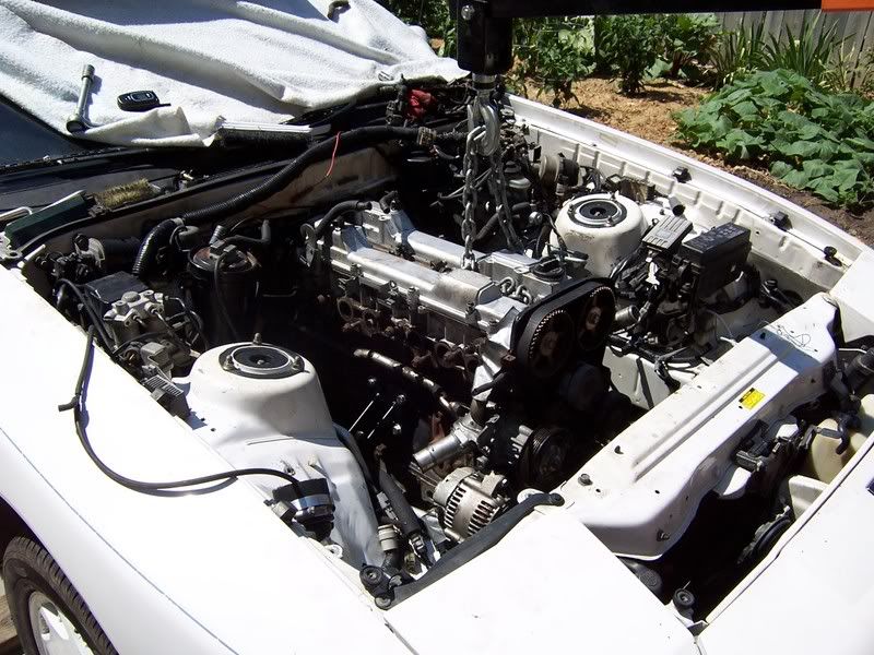

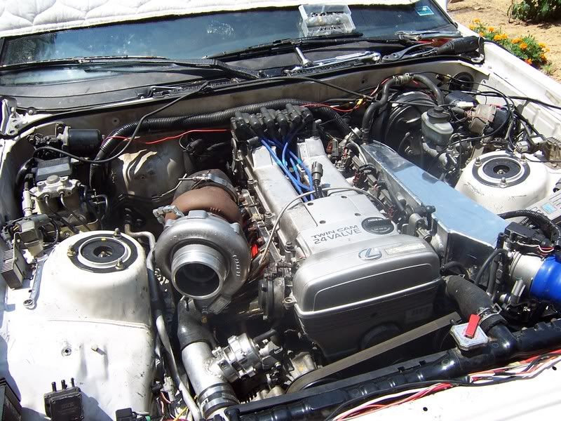

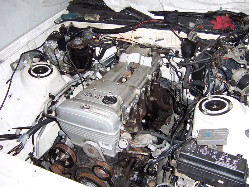

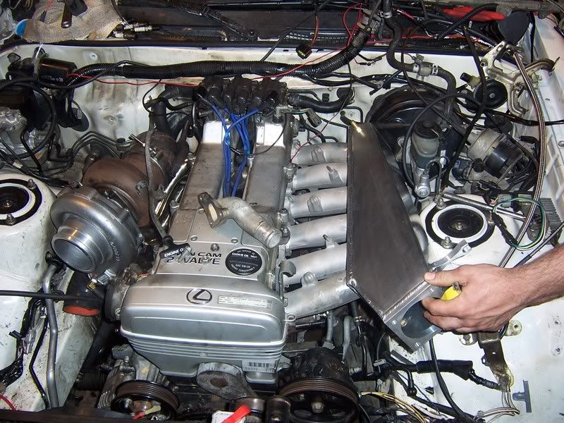

so i decided to hold off to do anyhting with the car, i ended up with the 2jzge-t, idea
bought the engine
started to install the engine thought the 89 cross member would work with the mounts on the 2jzge...nope
next i orded the BIC mounts...success

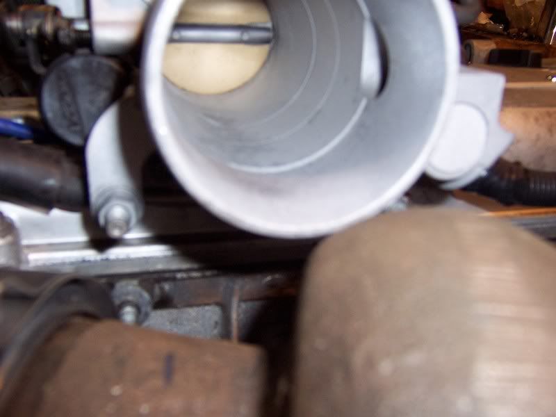

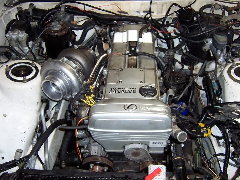

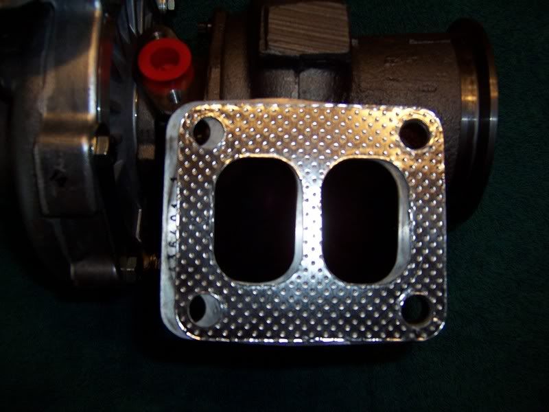

after about 3 months i got a brand new garret gt40 turbocharger and a ebay manifold. after finding out the turbo i got only comes with a international flange i needed to mill two of the holes out to make it a standard t4 adn bout a 3/4" spacer
![p1080320_8.jpg](https://www.supramania.com/images/pb_archive/p1080320_8.jpg)
bought the engine

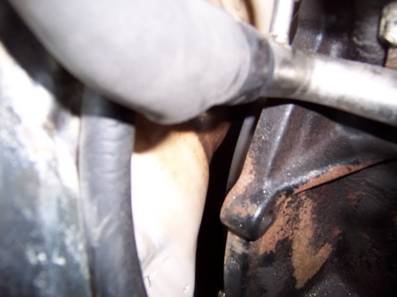

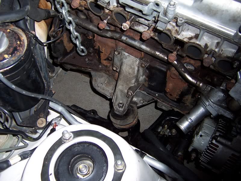

![p1080320_9.jpg](https://www.supramania.com/images/pb_archive/p1080320_9.jpg)
![p1080320_10.jpg](https://www.supramania.com/images/pb_archive/p1080320_10.jpg)
![p1080320_11.jpg](https://www.supramania.com/images/pb_archive/p1080320_11.jpg)
![p1080320_12.jpg](https://www.supramania.com/images/pb_archive/p1080320_12.jpg)

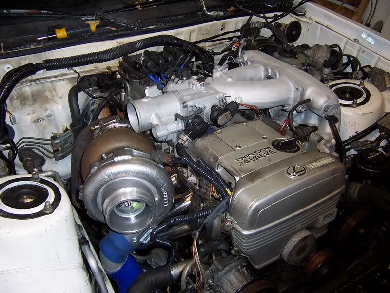

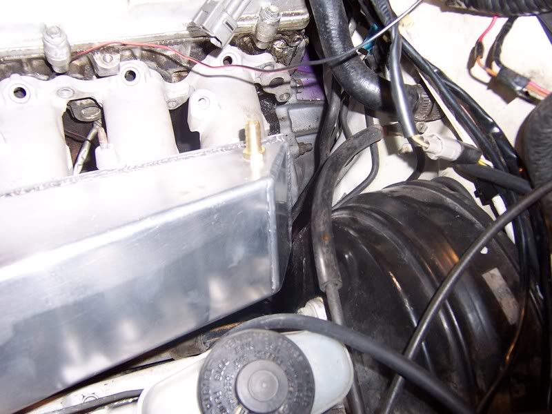

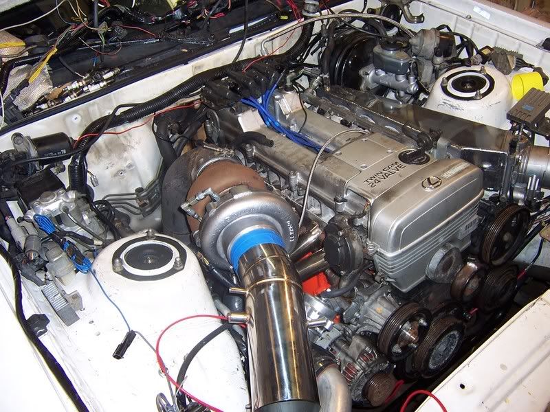

![p1080320_14.jpg](https://www.supramania.com/images/pb_archive/p1080320_14.jpg)
