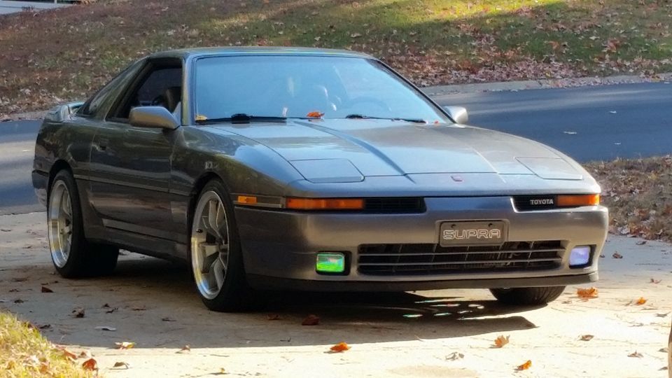

actually, you can buy kits to melt/weld/bond: https://www.polyvance.com/FiberFlex-1/
https://www.polyvance.com/Bumper-Repair-Flow-Chart/
and pics dont work, but: http://www.supramania.com/forums/showthread.php?103874-Modify-your-bumper-with-Fiber-Flex
It looks really good, Dan McBoosts car:
