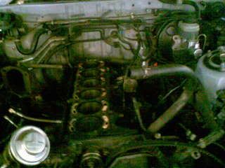

This is what happenes when you lean out your motor
