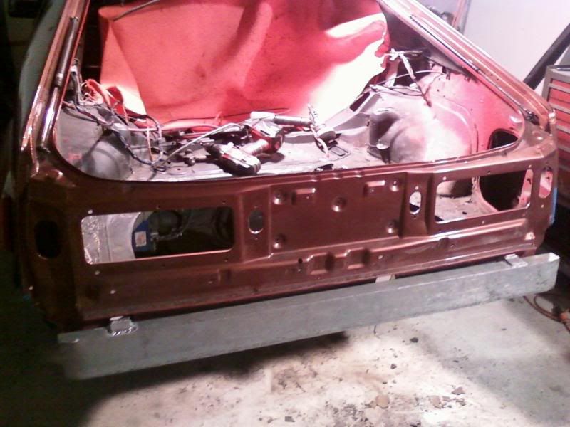

mytmk3
Oct 16, 2007
643
christchurch

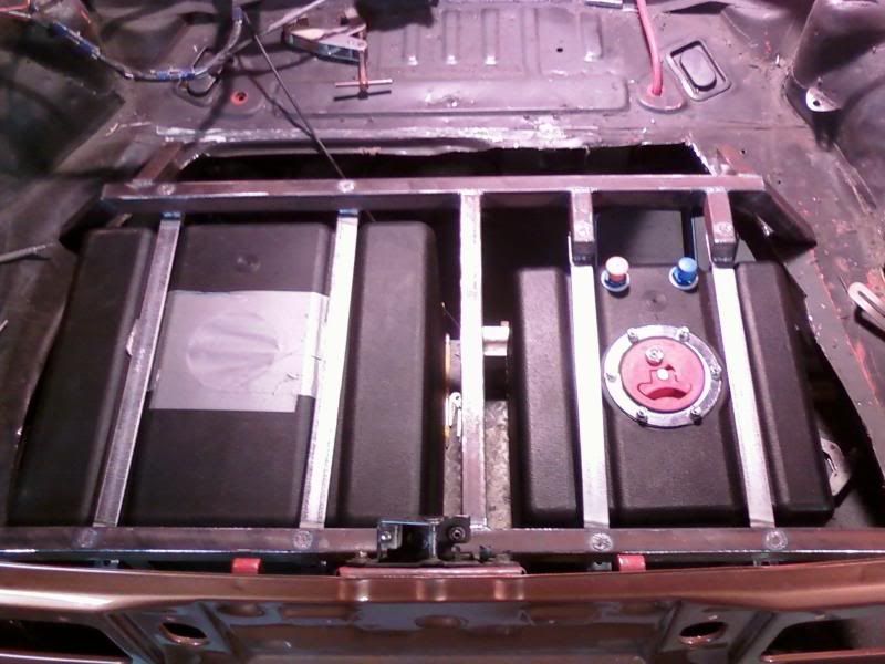

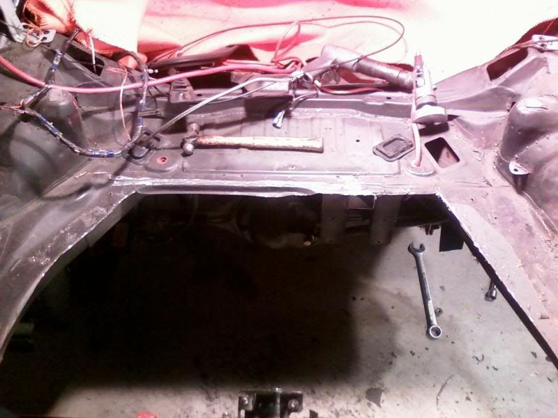

There's a bit missing :) wheels still weigh alot though and there is more to remove
No sound deadening rear seats or carpet, heater, rear interior, battery in boot (still a large one) hard top, abs removed
Fiberglass- front bumper, guards, stout hood,
