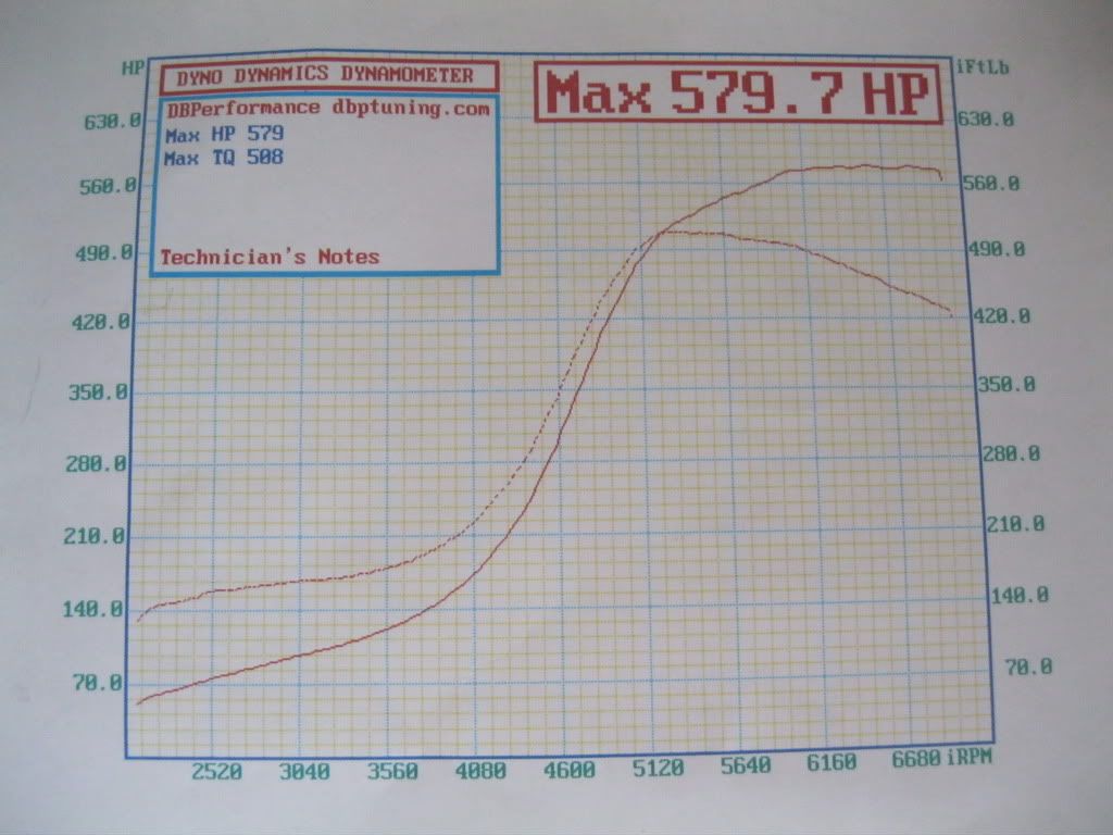

Dan did Shane give you a HP/TQ graph?
Y U NO rev 2JZ higher????? That thing has to be able to rev to 8k no? You have valve springs and all right?
I know, right? Like I said earlier- if he shut it down there I would be spinning higher than him this year! :evil2:

When Shane was putting her through the tune, she seemed to drop off right around 6900, so I think that's why he stopped. I do have the graph. I thought I should be able to go higher with the springs as well. Let's get some feedback here.

The dropoff might be what he's referring to as far as the exhaust housing is too small, could also be the exhast size as well? I think tuning the cams may benefit you too.

Sean pulled off the cat back and told me that there is no restriction inside it. So it has to be the turbo housing or just plain too small of tubing. New exhaust housing gets ordered tomorrow. I am going with the biggest a/r that they have, that and 4" piping.
