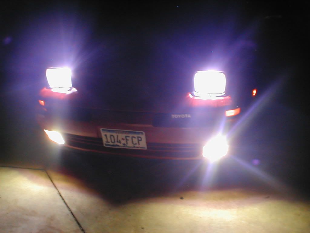

ok, since photobucket decided to stop being gay, here's a quick crappy pic
5
not really as the camera is garbage and it's pretty much auto everything. The cutoff is pretty good, not as good as a true projector but even with HID's it's less glare than a normal DOT sealed beam...
fog lamps have a nice wide and low beam, didn't grab before and after pics of with and without blinders....need a better camera...

what did you do to the blinders/sheilds and how did it change? i did accidentally bend one when i was playing w/ my fog lights. that one will probably bline someone now.
the other thing i noticed, w/ my H4 housings, i have a fairly decent cutoff w/ an unsheilded bulb. the cutoff is the same pattern as my friends MKIV with the Euro-glass headlights. its not the Z pattern like the S2000, TL or TSX, but its flat and then angled when it gets to the side of the road. seems decent for cheap housings.
5
same, but the area above the the cutoff is nearly black (especially with the fog lamps off)
I made all new blinders for the fog lamsp that where longer to clear the HID's...
