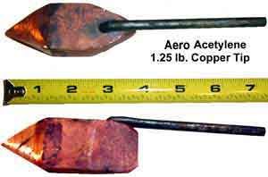

HommerSimpson
Dec 31, 2007
1,067
New Smyrna Beach Florida
Soldering tank is not hard to do... but you will need a oxy/ac torch or a propain one.. and one of these.. i have done a few .. and some still full of gas...
