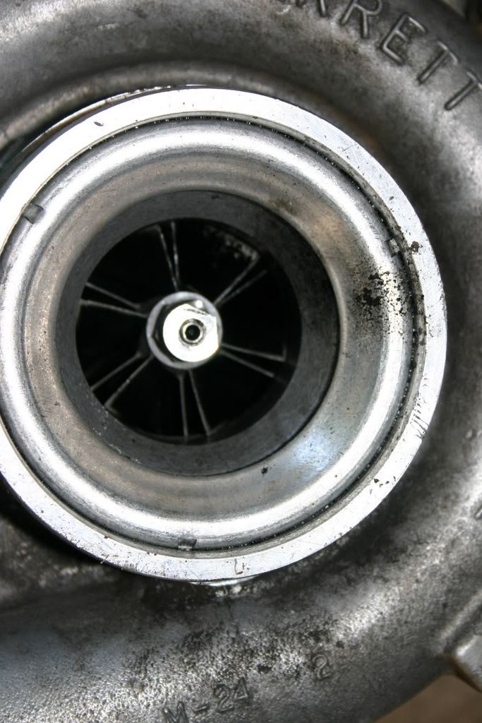

thats the range I am shooting for. What exhaust housing will fit? Have to be garrett I guess?
Anyone know why that double turbo set up is like it is? I still don't understand that setup. Thanks for all the input...

wat u mean? how is it set up?
i would shoot for around .69- .78 a/r range- much quicker spool. and u should take the turbo to a turbo/ diesel shop. they will be able to tell u exactly wat u have and wat housing can be put on it. once u know exactly wat u have (gt32/gt35 my guess, or watever) u will know exaclty wat it is capable of. so basically u should double check wat i or anybody else is sayin- just to make sure:icon_bigg

I was wondering if you or anyone knew why the twin turbo set ups were like they are. Here is an example.
http://cgi.ebay.com/ebaymotors/New-...ryZ33742QQssPageNameZWDVWQQrdZ1QQcmdZViewItem
supra_ed
May 30, 2006
415
ohio
thats common diesel- a smaller turbo feeds into a larger turbo. reduces lag, its more efficient. ive also seen a diesel with a supercharger feeding air into a large turbo. it was a pretty badass setup

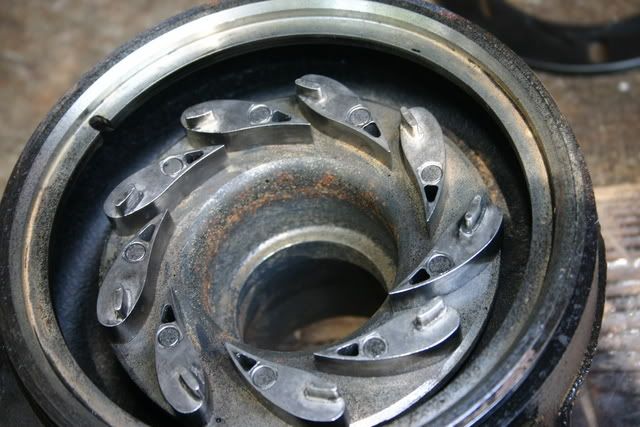

That twin setup looks like its off of a 4.5 powerstroke. Also, it will take some work to get that turbo to work with the variable vein. the vgt sensor gets a signal from the ecm depending on load and throttle position. Its a voltage signal but I didn't find out if its 0- batt. voltage or battery voltage to zero. I thought about using a tps sensor with a 12v input instead of a 5v. Or if tis the opposite way you can find a tps that you can mount backwards so it has full voltage at idle and sweeps it down to 0.
if he switches to a different turbine housing, wont it fix that??
Im afraid not. The vgt sensor is in the center section not the exhaust housing. I think it would be great if he got it to work. He would have zero lag and no top end restriction.

Yeah I noticed that it had an electronic solenoid where the wastegate should hook up. I had wondered about that also. Will be intresting to figure out. I have plenty of time to ponder on it though. If anyone has any idea's, chime in. The TPS sounds like it is possible though.
I did alittle reading on these turbo's. They are supposed to have no lag, and great boost at all RPM's. Also they use no wastegate. Would be nice to get it working. There has to be someone that has done this conversion. These things have been around awhile.

*PUTS ON THE BRAKES TO A SNOW BALL THREAD*
In general, a turbo is a turbo is a turbo. There aren't only two major differences between why a diesel turbo can't be used on a gas setup.
Carbon seal VS dynamic seal.
All of the large garrett, holset, kkk, borg warner etc use diesel technology.
The GT42, GT45, GT40 turbos? Started out life as a diesel application.
57 trim Garrett wheel? You guessed it. Diesel application.
A carbon seal turbo has to be used on a blow through or draw (suck) through gas application.
A dynamic seal turbo can be used on any thing fuel injected.
Most turbos on the road today, performance or OEM are dynamic seal turbos.
Now that we have that out of the way -
-The power stroke turbos are a no no. They either have the wrong (backwards) housings on them or have too large of exhaust housings. The new ones are also variable vein. These are also a no no.
-Duramax turbos. Again, a no no due to variable vein.
-Isuzu NPR, or NP series turbos are hit & miss. Some of them are small, some are large. Most are non ball bearing GT series
-Volvo. Again, hit or miss. Some are holset, some are GT35's.
-Diesel turbos in general are hit and miss. Most have GIANT rear housings on them. If you can find the old TA45/51, GT40 series, or the TV81 series and have a custom rear housing installed on the exhaust side, you're golden.
-The IHI Gm8 turbos are a decent upgrade for our stock 7m's. The problem lies in the fact that cost of fabricating one to a manifold VS 57 trim upgrade or bolt on is about the same
-The Holset hx35, hx40 and hy35 are awesome turbos for our cars when used with the 9cm or 12cm rear housings. The problem with these turbos is wastegate controll. The internal gates are WAY WAY too small for how fast these turbos spool and react. The only way to go is to port the wastegate hole out or run external. The little hy35 is good to 450/475 hp. They can be found on alot of the dodge ram pickup trucks.
Any more questions, you can direct them my way.
