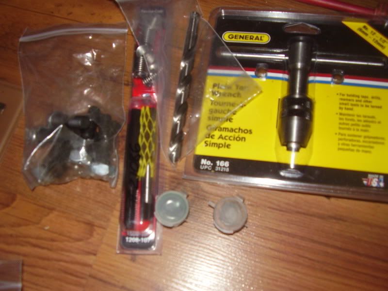

Driftmotions helicoil kit :)
btw guys it came with two little containers of liquid. one is a copper looking liquid and the other is blueish greenish lol/
what is it? and where and when do i use it?

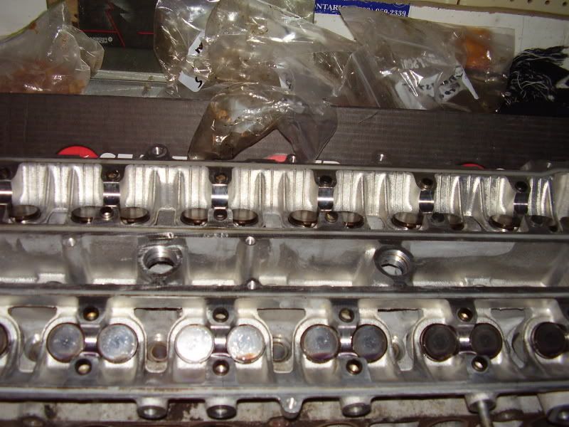

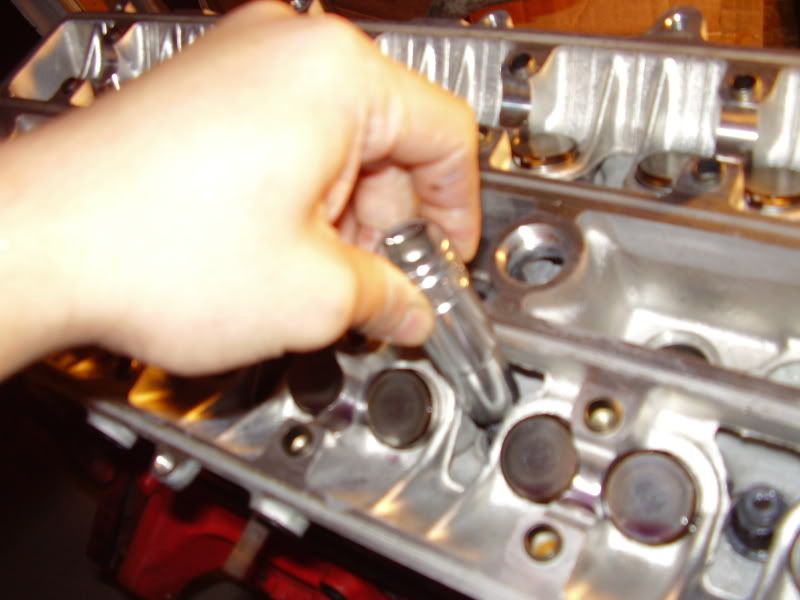

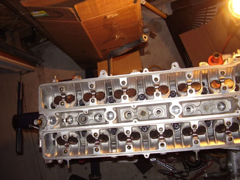

To get the retainers and valve locks in, some people use the pvc pipe method; That is, you get a piece of pvc pipe that's roughly as large in diameter as the retainer, and you cut a window in the side so you can press down on the spring/ retainer, and then reach the locks to push them into place. Problem is- it's really a two-man job.
This is really what you want:
http://www.toyotool.com

AMAZING!! lol. i wish i had that earlier. i already have the entire extaust side done.
now for the intake side.

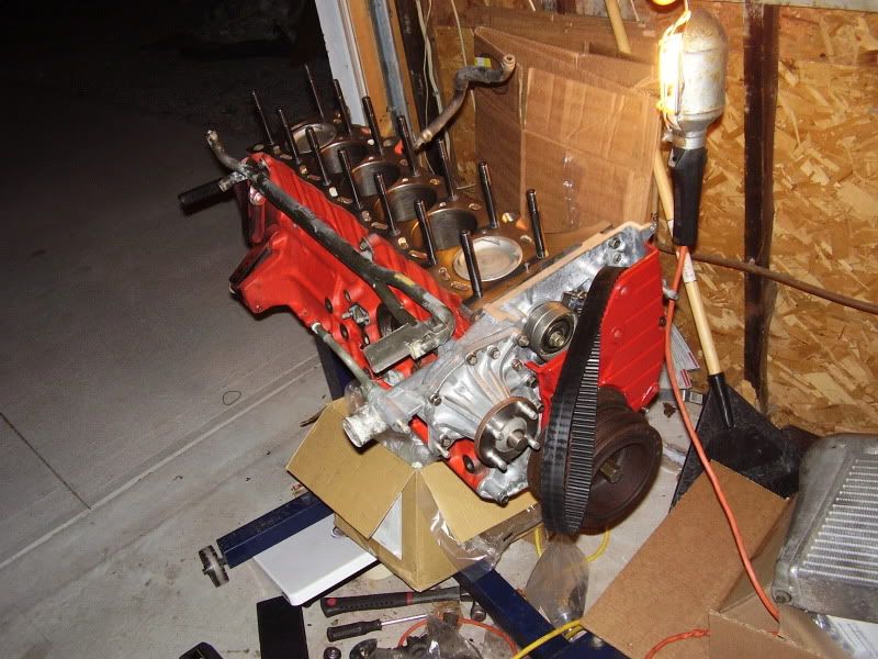

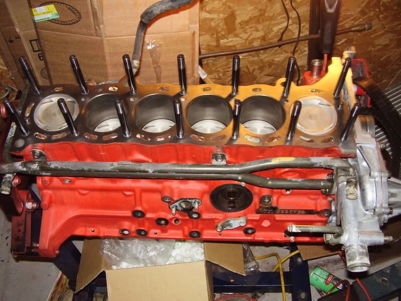

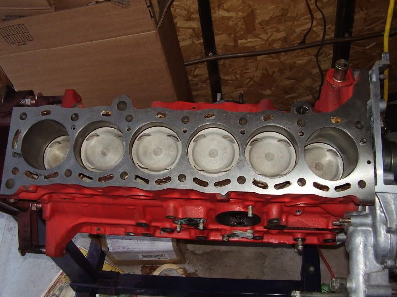

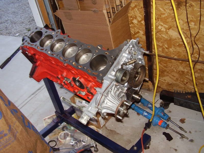

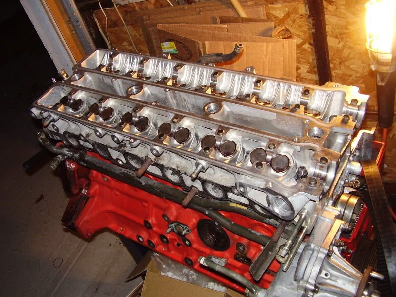

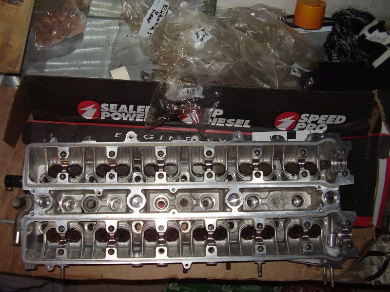

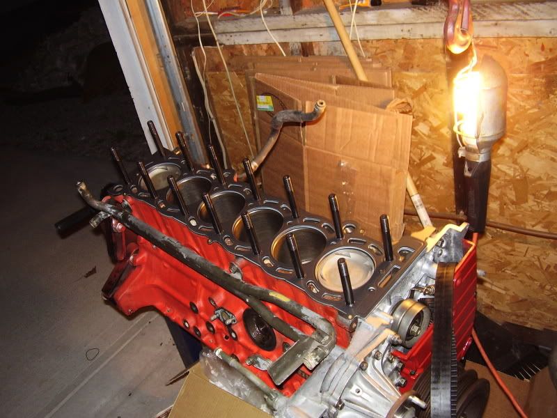

a little update. Got all the valves and keepers in.. by the time i was at the end i was a pro already lol
got my pistons in. and a few other misc items on.

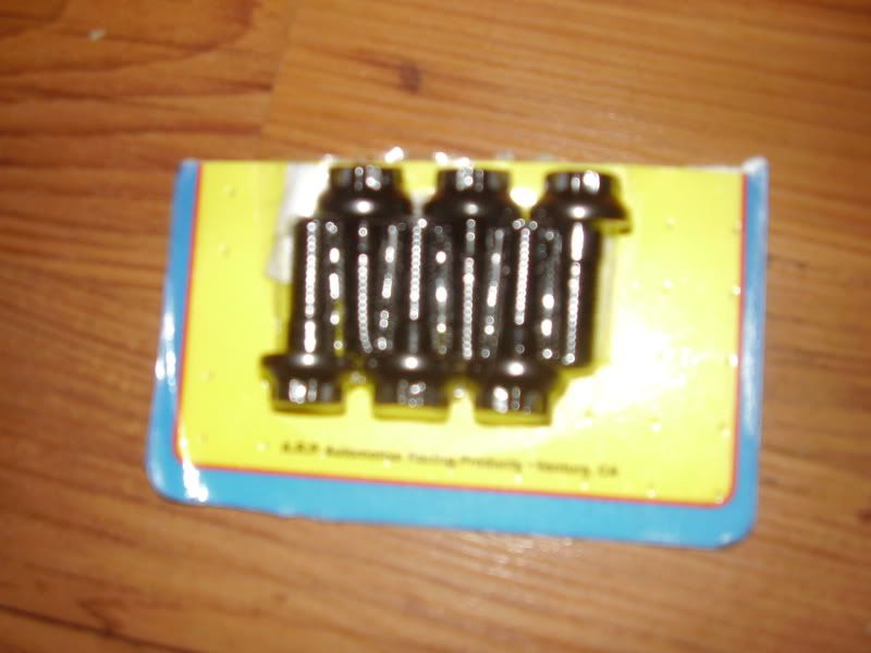

But i got a few misc. things on.. i was ready to put the head on... but then i checked the bolt for the head stud and i didnt have the damn right socket for it\!!!!... i used arp head bolts on my current engine and now im going with studs.. they are a different size.. damn i was pissed anyway.. figured out that arp head bolts are 12 point 1/2" while the arp studs are 9/16" or 14mm 12 point socket!

Did you do a bore over or a Hone? I don't see why you would spend $$ on maching a block and using the old pistons. You can go stock aftermarkets NEW for around $100 depending on what your looking for ..........
IBoughtASupra
Mar 10, 2009
4,455
Queens, NY
DriftMotion has new stock NPR pistons with new pins for 120.00 plus shipping. It makes sense to get new ones after machining the block. I bought the hone tool at the parts store and did it myself. Took a little off to deglaze the block and put in my pistons.

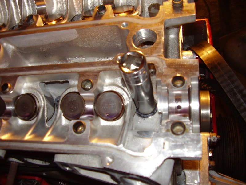

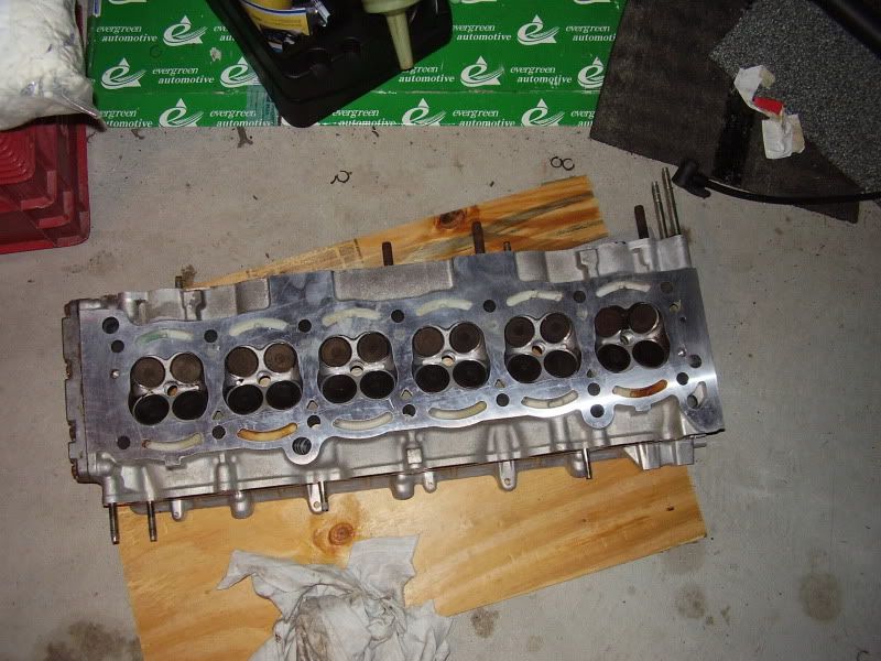

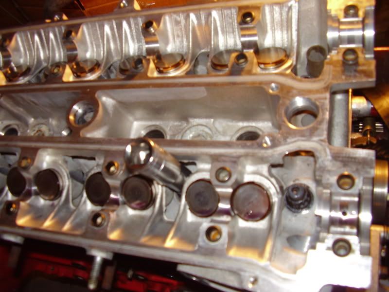

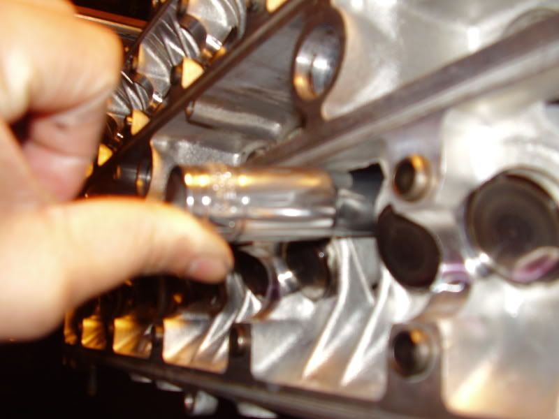

a little bit of an update. i go to but the head on...and before hand i flipped it over to clean the surface a bit before i put it on.. i forgot that i left the shims in there and a few of them fell out and may have been mixedd up which sucks! but thats fixable.. so no big deal
so the head is on and the studs are in... i try to put the washers in but they didnt fit!! (im an idiot and should have put then in first) anyway.. i lubed each washer and sorta balanced each on their stud.. then lifted the head up so that they would fall in place.. few of them didnt but i got them in eventually..

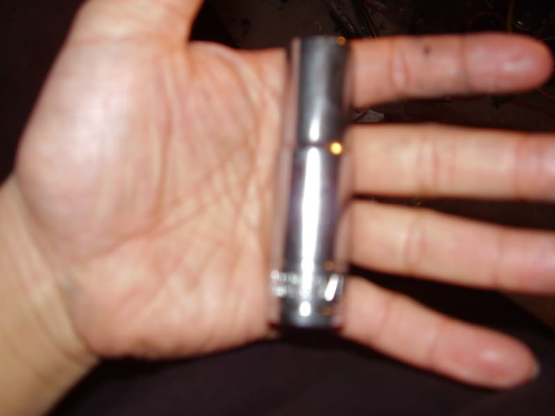

so then i try to put the bolts on... turns out i have the right size socket 9/16 12 point but it doesnt fit in the bolt area!! FML the socket only fits on the end!! argh this is soo frustrating..
and on top of that.. i think i figured out im allergic to aluminum because i was using my arm to support the head and wherever i touched the head with my armm there are hives..
so.. now im kinda screwd... where the hell am i gonna find the right socket in ths stupid city! argh..
Does anyone have the right socket that they can lend to me? i'll pay Whomever $5 plus ill pay for shipping there and back.. prefferably someone from canada as it would be quicker and easier.. and cheaper..

You need a deep 14 six point socket. You can get them at Auto Zone.
nope. either 9/16" or 14mm 12 point socket for arp studs.. and the 9/16 socket i had was a deep socket.. it was just too wide to fit in the bolt area
