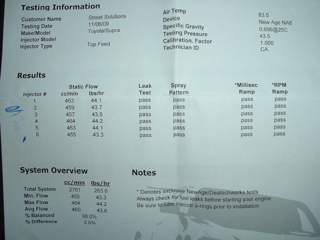

i had this place service my injectors, they replaced all the gaskets/grommets for all the injectors also
http://www.deatschwerks.com/
