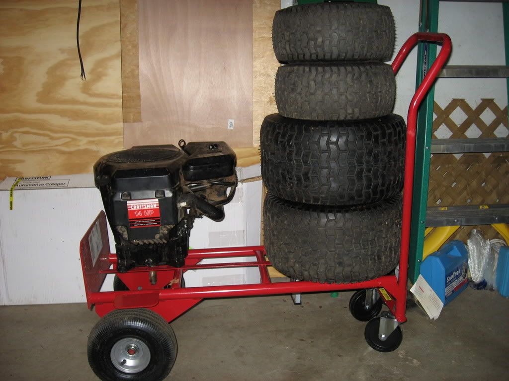

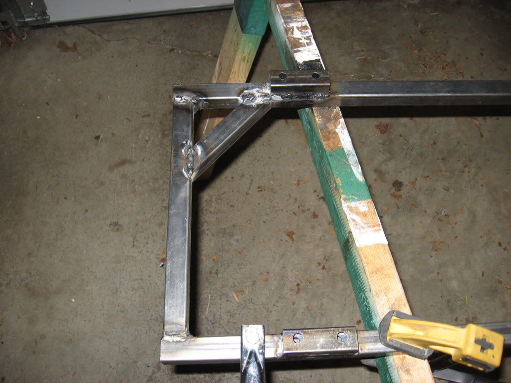

here's my seat of the pants go kart:
more to come tomorrow, should be getting the engine and seat bolted in!

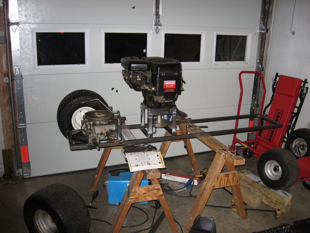

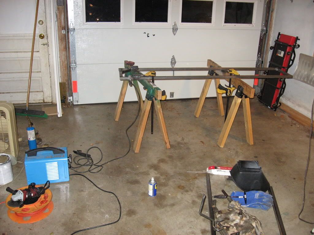

yep, havent even begun to think about the important stuff like clutch/idler pulley and shifter.
however, i do have a welder, a grinder and a sawzall so not much is getting in my way.

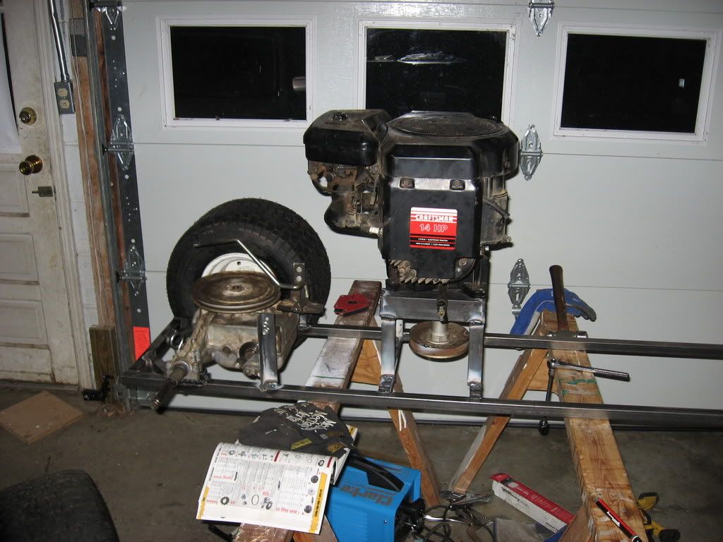

make sure to triangulate your chassis!! I'd have made the one you pictures considerably larger. box steel likes to bend and never go straight again.
but 14hp.. damn.. i remember my 11hp kart. thats gunna be fun!

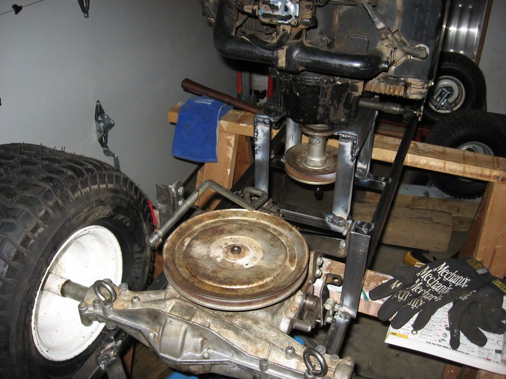

speed, that 6" brace is the biggest i can get in behind the transaxle. im gonna put another one on the other side, and a sh*tload of crossbracing between the transaxle, engine and seat :) more to come tomorrow.
thanks a bunch for the tip!

yea, don't just cross brace it, but triangulate each cross brace too. yea, it'll be some more work and add a little weight, but it'll make it a LOT more resistant to twisting. What are you going to use for your axle & drive system? Brakes?

axle/drive is a pain in the ass because the engine is vert output. im going to try and use the transaxle off of the mower. brakes? ive got a 3" diameter disc off the side of the trans, does that count? ill have to get pictures of it tomorrow, its a joke.

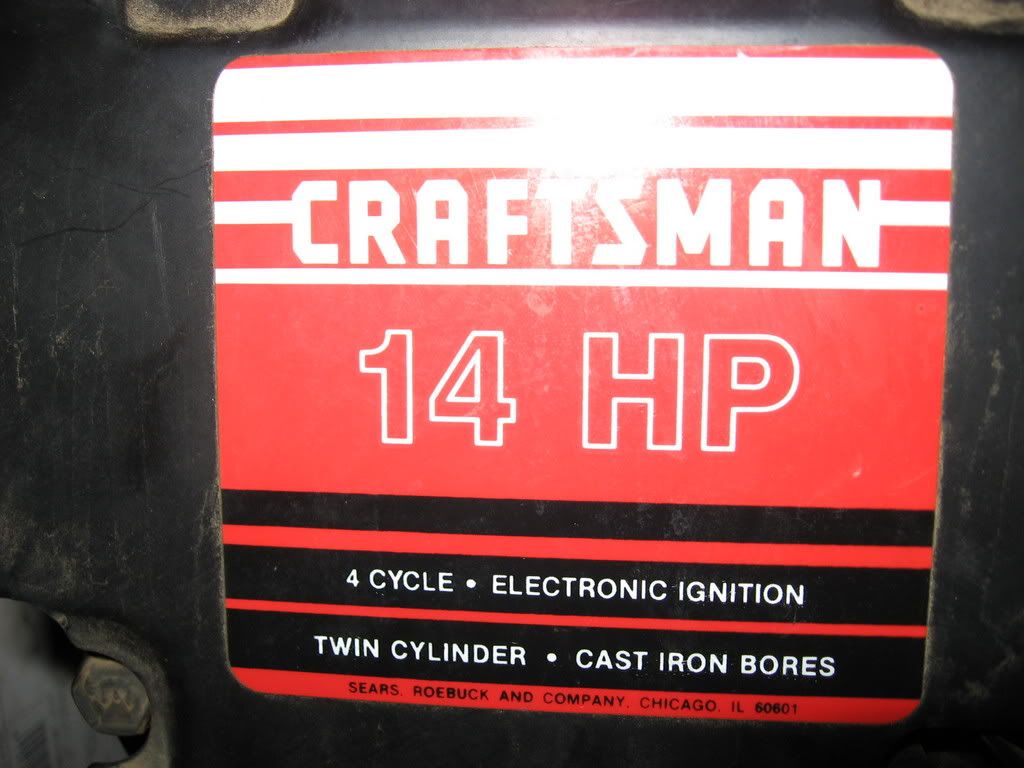

heres some pics from tonight:
a question:
would i be able to use a clutch rated for around 10 hp on this 14 hp engine? seems simple but i wonder if they allowed for an extra hp or two in engineering the clutch and if the engine isnt putting out near that much. whats everyone think?

As long as the clutch fits......your fine in clutch department. Looks good so far!
