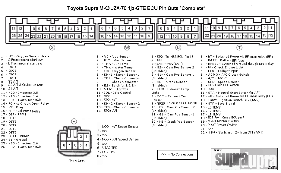

Hey everyone,
So the 1j is in my 90 hilux and I'm hoping to fire her up real soon.
I dont plan to use any factory gauges but I would like to have the engine light working.
That being said what would I need hooked up on the 22 pin plug to get this thing running.
i do have the pinout but not too sure what goes to what. For example check engine light?? Does this light up the dash warning when a code pops up??
Heres the pinout I'm using.
Thanks in advance....
