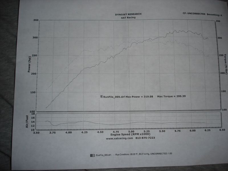

I went to a local dyno tonight to find out what's going on with my car. I've got 550's, walboro, sc61, tial 38mm with .9 bar spring, 3" exhaust and map ecu. One of my good buddies helped me basically make a map out of a "start up map" that Map Ecu comes with. There's quite a bit of work that's left to be done but I really wanted to see where this thing was headed.
319hp
295tq
There a/f's were pretty crazy but it's all a part of the learning process. I'll post up the sheet in a few

definitelly. We'll be working out some issues and hopefully find a boost controller that meets my needs and isn't too complicated for my simple ass = )

Not bad not bad!
Get that bad boy tuned, and watch the hp climb!
any "tuning" will lower hp numbers.....its already lean as shit....it needs to be richened up a bit and that will lower hp numbers a bit...
the car has other issues somewhere....
Um no?
Ive seen forced induction cars get richened before and make more hp....

im sure you have.... my point was tuning is not going to yield any major hp increase or DECREASE..... i would say MAX of 5hp give or take with a bit more tuning.... its not like the tune is off the charts rich where once tuned it will gain 20-30-40 hp...
