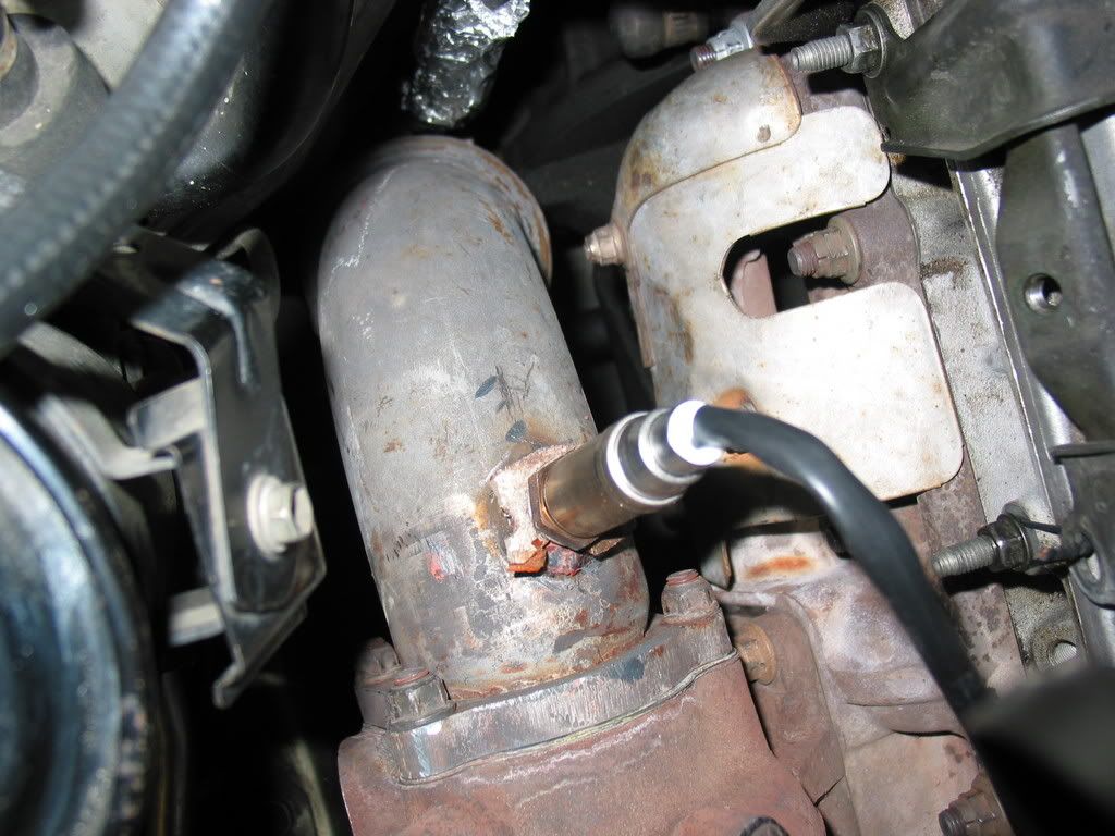

ah...so I installed the downpipe, and it is awesome! The Supra now breaks traction when the turbo spools up in first and second gear....:naughty:...it is now time for some new tires...lol.
I just have to get a different o2 sensor, because the stock sensor's flange crackedin half as it was being tightened...:rolleyes: It is being held right now By some FIPG and a hose clamp...lol... Oh well...I'm happy with it :D

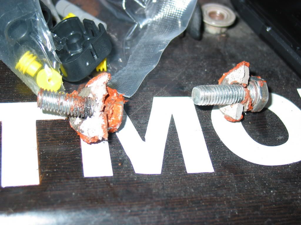

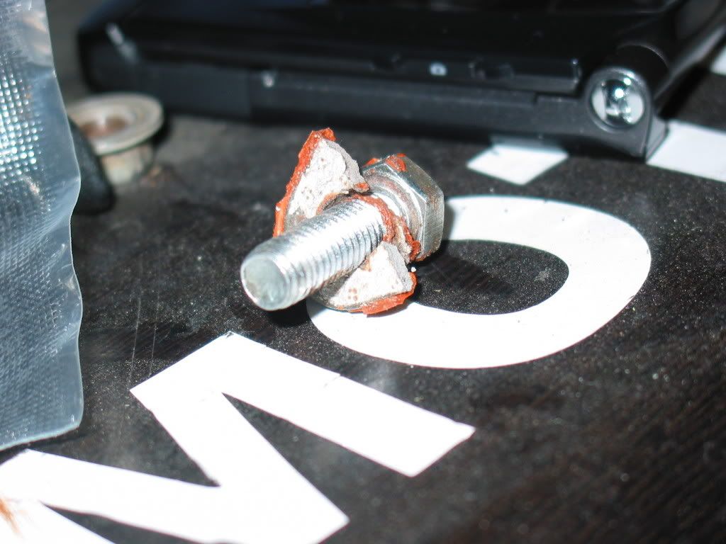

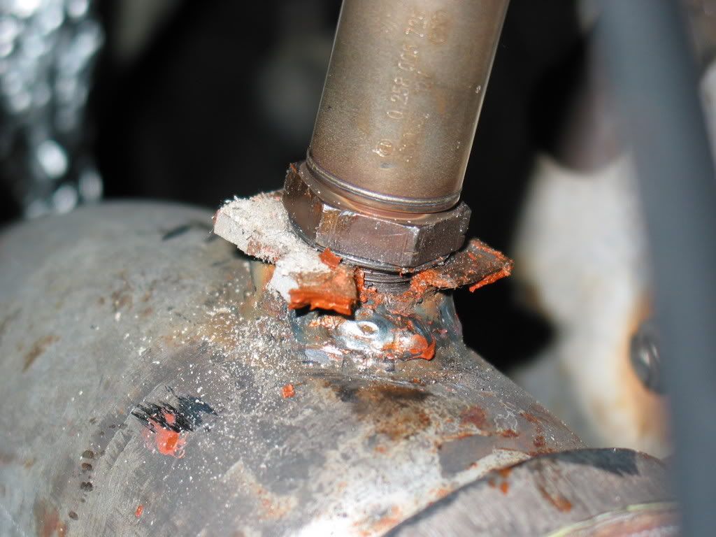

I installed a new Bosch universal 3-wire o2 sensor from Autozone.... It works prefectly, and isn't leaking anymore, but I just discovered that the flex joint is leaking pretty badly...:rolleyes:
Both sides of the flange cracked off:

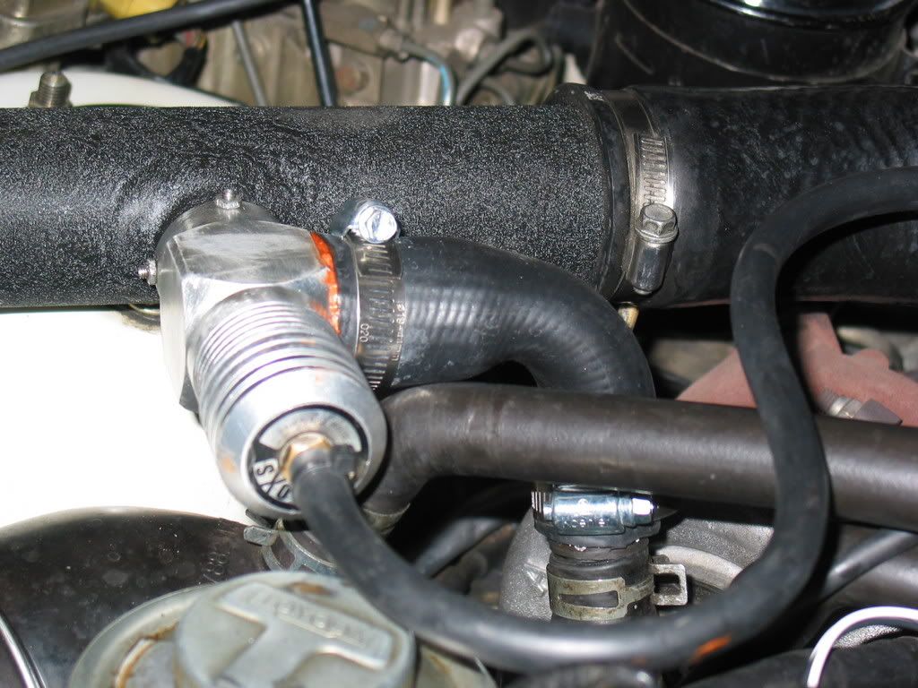

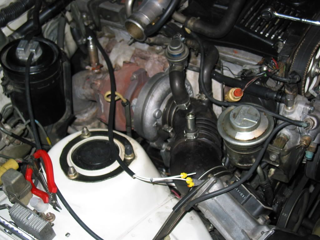

Tonight I made a custom recirculation kit for my TurboXS BOV...:D It was just too abnoxiously loud with it venting to the atmosphere, and it would stall occasionally when coming to a stop, after I fixed a boost leak...:nono: The BOV is very close to silent now...
So here are some pics:
