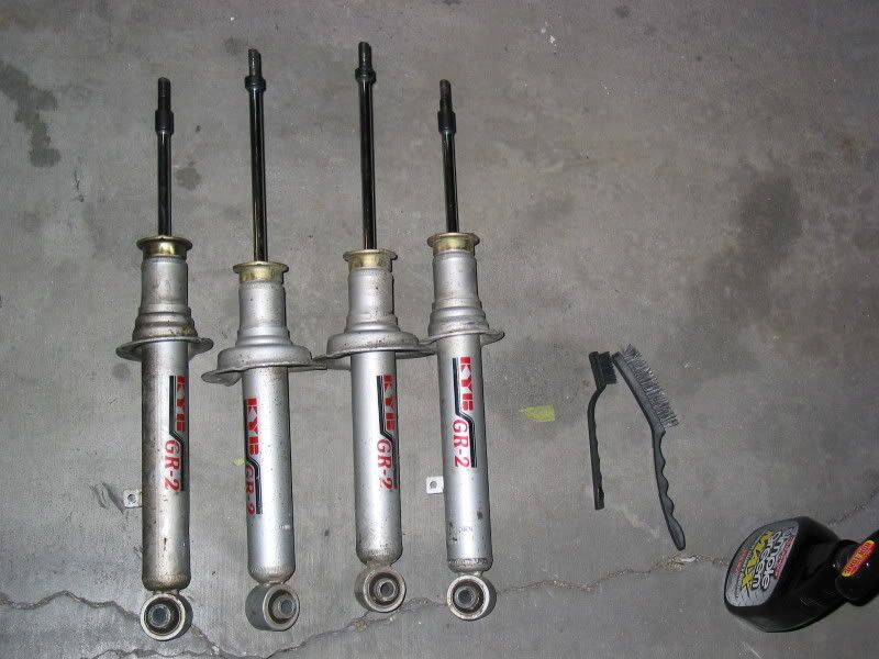

Where did you get those sweet ass brushes? :biglaugh:
