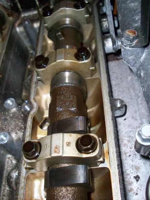

JDM 2jzgte oil sludge pics? Should I keep this motor?

staticpage;1566054 said:
my 1j came really clean i have not seen one like 92TealSupra's
Yours not not look to bad, but as you can see if our 1jz's were really 40K to 60K on them yours in my opinion is still dirty.

just make sure the block oil galleries are cleaned if thous plug up bye bye motor
and the pic of that born stuff is from water sluge is usely black like bear shit

I just would hate to start off vesting money into an engine that needs a rebuild when you could get another that looks like yours and mine.
Normaly the JZ bottom end doesnt need a rebuild until 200,000+ miles.
I wish my friends liked extra head aches and projects I have plenty on my plate now and I didnt even start off in such a hard place.
All the cams, mains oil pump will have to be broke down if your tearing in might as well get some shiny new pieces, go 100% by TSRM the tolerances have little room for forgiveness dont cut any corners with lots of extra time & money take your time dont hurry yourself.
