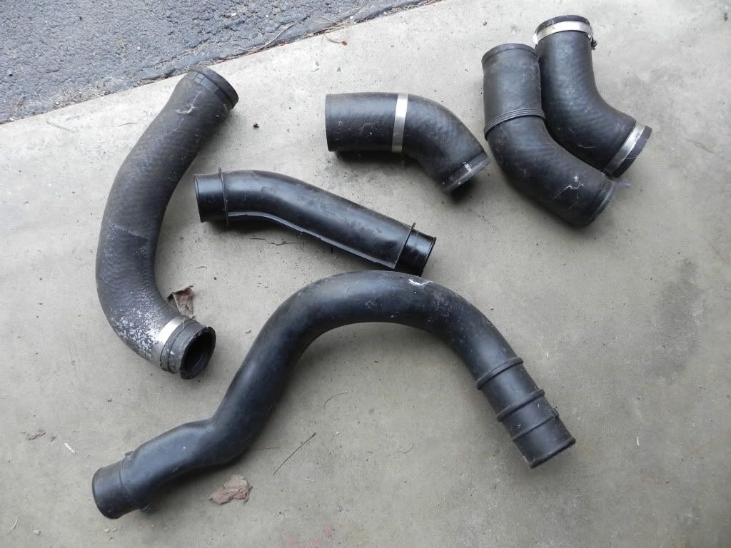

ok so this is what ive got, i know im definitaly missing some pieces..
Tag no good... have you a photobucket acct? Try uploading this pic to the photobucket acct, then once that is done, you will see four img tags under the pic. Select the lowest one and left click it. It should flash yellow and say "copied". Then you just paste it into your reply in this thread and POOF, we see the pic:)

mike86supra;1695018 said:
think thats how its done
That's it man. Looks like you are missing more than one piece. I will compare to what I have and get back to you. I know you are missing the intermediate piece that goes between the two lower pipes from the turbo outlet. That bolts to the framerail under the car somewhere and there may be one more rubber hose too. Do you have the 3000 pipe that runs across the top of the head?
