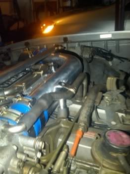

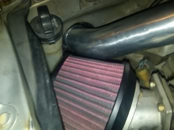

Heres one of the pics that shows most of it.

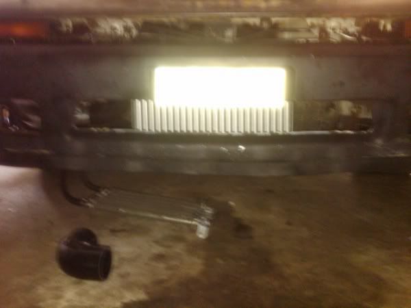

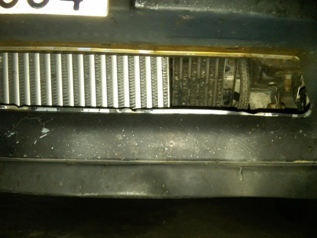

Shows the aftermarket intercooler, the piping (The kit comes with blue couplers, the black ones are ones i ordered)

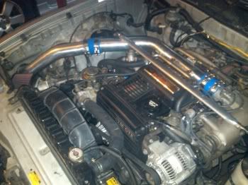

What i had to do to put the intercooler on w/ the piping i used was from the turbo to ic pipe, had to get a 2.5" straight coupler, cut about a 6" piece of alumized steel "Cause it was cheap" and a 2.5" 90degree coupler to the intercooler. Clamped the 6" steel pipe to where the aluminum one ended to make it long enough for the 90degree to go to the bottom of the IC.
Then for the upper to make it fit, i just got two 90degree couplers, shaved them down a littler, and put about a 3" section of 2.5" piping inbetween them to clamp them down.

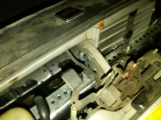

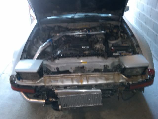

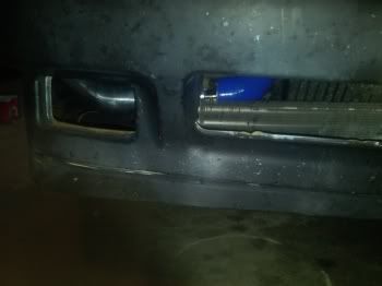

Let me throw up a few more pics.
I can take more when i get the car finished up or get out to the shop this weekend.
Ill try and get one of the lower ic piping soon.
