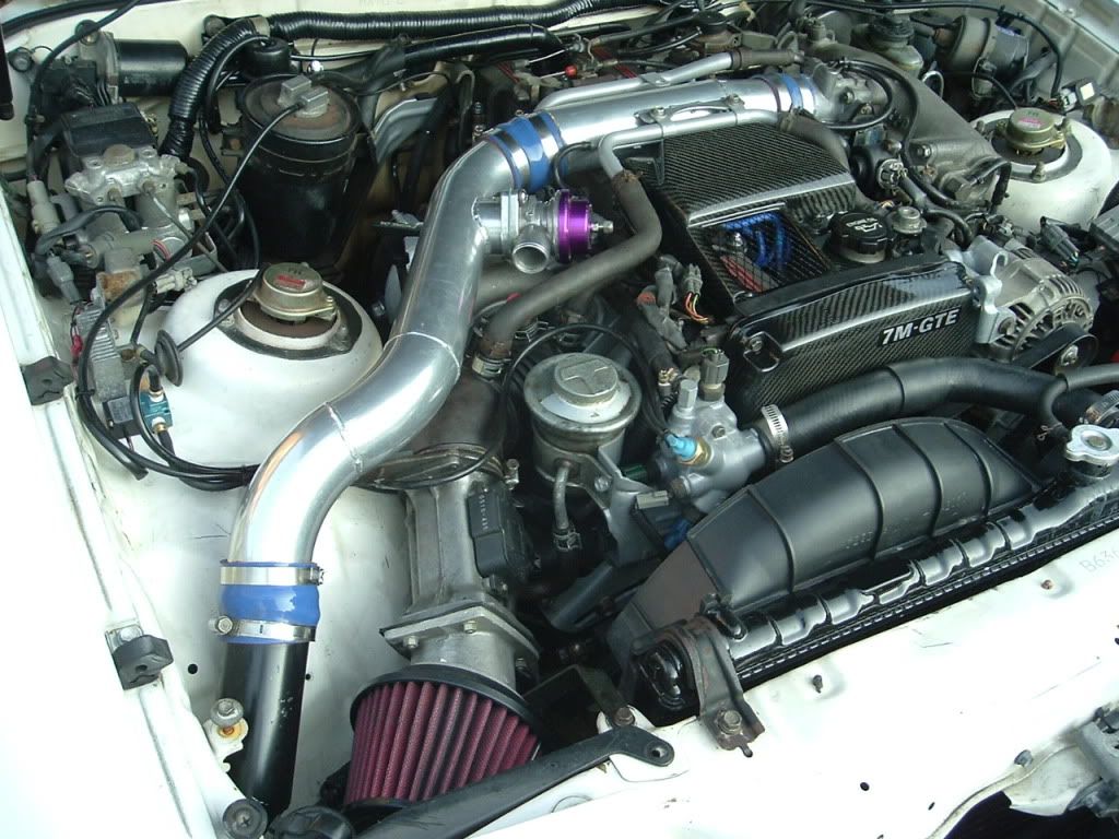

Turbo Habanero;1703155 said:
So your running it with out anything as of right now? Do you daily drive yours? Your engine looks very clean.
yeah the bov is just vented and the port on the accordion hose is just capped for now
i usually dont drive my car if its raining or while the salt is down in the winter since i have a 4runner also, during those times i just put it in the garage
when the supra was my only car i would drive it all year long rain or snow
didn't seem like i could find a hose that would fit on the bov and then reduce so i could clamp it on the accordion hose
i wanted to use one of these
