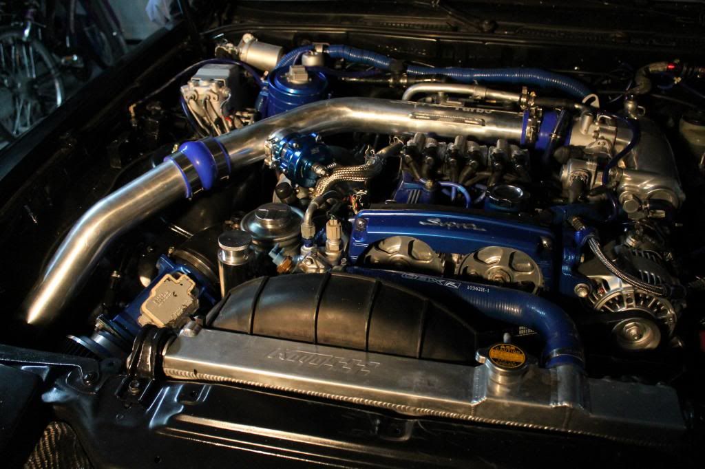

I have the "drop in" Driftmotion kit and the best way I found to install it was to get the piping sitting where it needed to be FIRST and then put the intercooler in. I first tried it the other way and ran into more problems that way.
If you have a 87-88 car, you can retain the use of your coolant overflow bottle. The 89+ cars can not due to the location of a few A/C components that moved to that side during those years. My 89 of course did not allow it to go there. If you look in my picture here you will see a stainless canister mounted next to the power steering reservoir. I use this universal overflow container and it fit perfectly even using the power steering reservoir bracket.
The picture also shows I upgraded to a genuine Tial BOV as I prefer not to use the knockoff HKS sent from DM. I also used a few different couplers that allow for a little more movement of the piping for a better fit. All in all, it takes a bit of work to make it fit just right.
I also have the Koyo rad that you can see in this picture as well. Works great for me. I've always used the Fluidyne and PWR in the past and they were both great as well.
